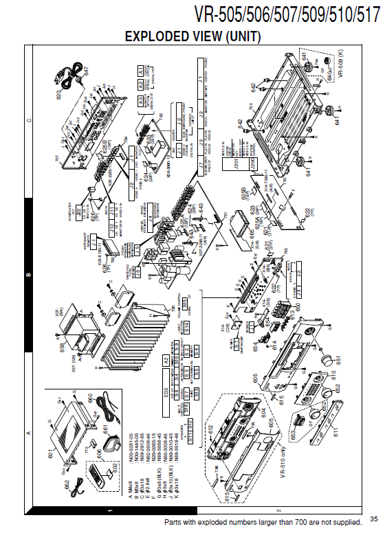

Was actually searching all day for that. All I have been able to find is the attached. Am continuing to look but not sure if this is even helpful. The filename said 505 but I thought I saw 507 in the diagram
tmp_15336-Kenwood-VR-505-Service-Manual-2-216900435.png [ 236.77 KiB | Viewed 37291 times ]

As far as I can tell, the rotary encoder is no longer available. I can't find the specs on the original unit, so I don't know if one could find a workable substitute....
