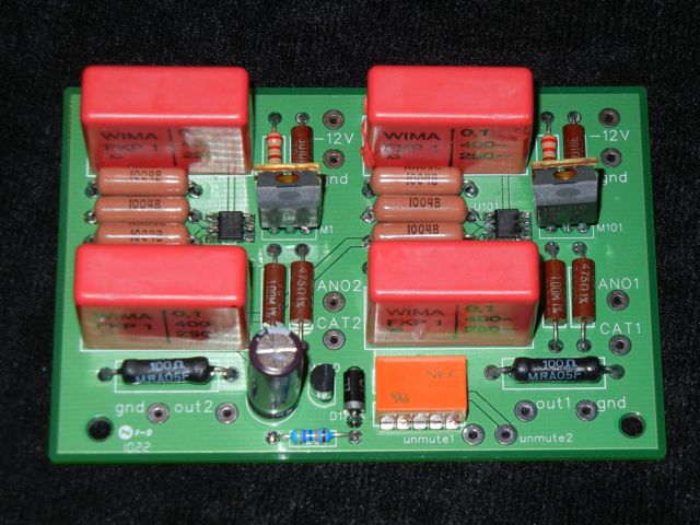

Should I send you description of a servo-cathode-follower PCB I made? It's set up for a 6SN7, and you'd have one less coupling cap but a -12VDC supply (like maybe a filament supply.)
Actually, the schematic is shown in the Projects thread titled, "Guy's Phono Pre-amp."
File comment: PCB with components: You supply the socket.

PostPosted: December 19th, 2013, 3:07 pm
Guy, you certainly can if you like Howrver, its worth pointing out that not only do I havr a couple, but I am using one in my phono stage. I will need to buy a couple more.....
PostPosted: December 19th, 2013, 4:23 pm
By the way, I recommend increasing the absolute value of the negative supply, since when I tested mine, I ran into asymmetrical clipping on the negative rail at moderate outputs. Since mine was in a phono stage, at the output, and gain is kind of low, my expected output of ~0.5-1V depending on SUT and cartridge was NOT a problem.
But in a line stage, one which may have to feed a low gain power amp, clipping at ~7 volts I saw as cutting it too close. Theoretical, of course is about 8.5VRMS, but that's with the MOSFET slammed against the negative rail, something I'd like to avoid. In practice, visible clipping showed up around 7VRMS output.
For a line stage, I'd change to a -24VDC rail. Op amp won't have a problem with that, but either the mute relay coil voltage needs to change, or the circuit changed to provide an acceptable voltage to the coil using a dropping resistor.
PostPosted: December 19th, 2013, 4:32 pm
Also worthy of note is that Guy did an excellent job on the board, it sounds GREAT! (No big output coupling cap!) I feed the follower tube with a 0.01uF-0.022uF cap (FAST!) and a 10Meg grid leak (6SN7 @ 7mA/150V on the plate). The mute relay (used to mute output until circuit stabilizes) is also useful as a front panel operable mute feature with a single pole switch not carrying signal current.
It is simpler to use than the Berning/Rankin/Yaniger/Phelps circuit since it doesn't wrap the follower tube in a feedback loop (this corrects at the cathode, not the grid) and has proven to work well using the same B+ supply as the remainder of the phono stage. I know Charlie had some issues with regulators interacting and went to a separately regulated supply just for the servo stage.
I have no idea whether either holds a sonic advantage over the other. I suspect implementation with the right op amps and caps (be nice if they REALLY didn't affect the sound as their respective designers thought!) makes more difference. Charlie did an awesome amount of work figuring out which op amps work best here.
