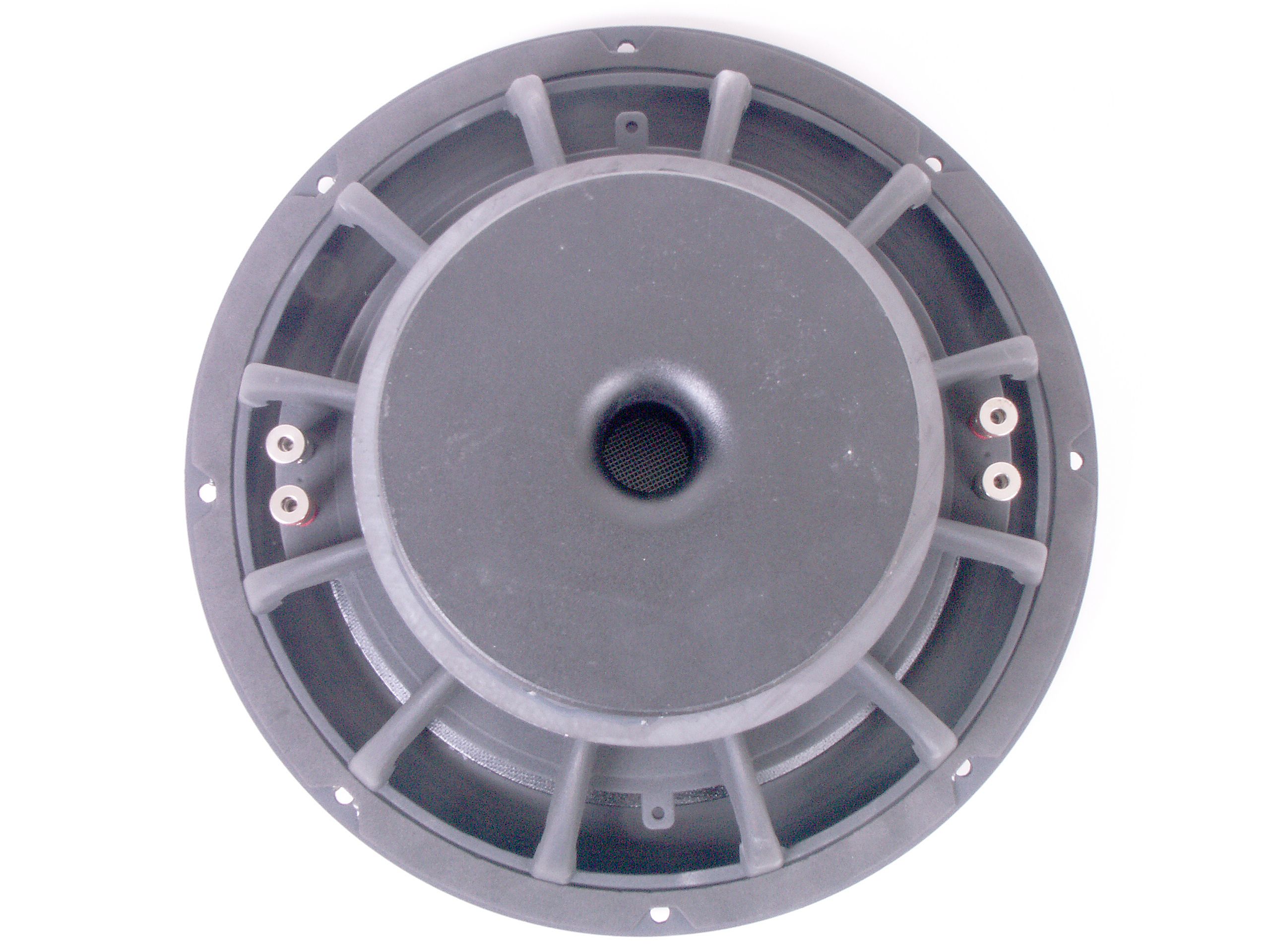

File comment: Bottom view

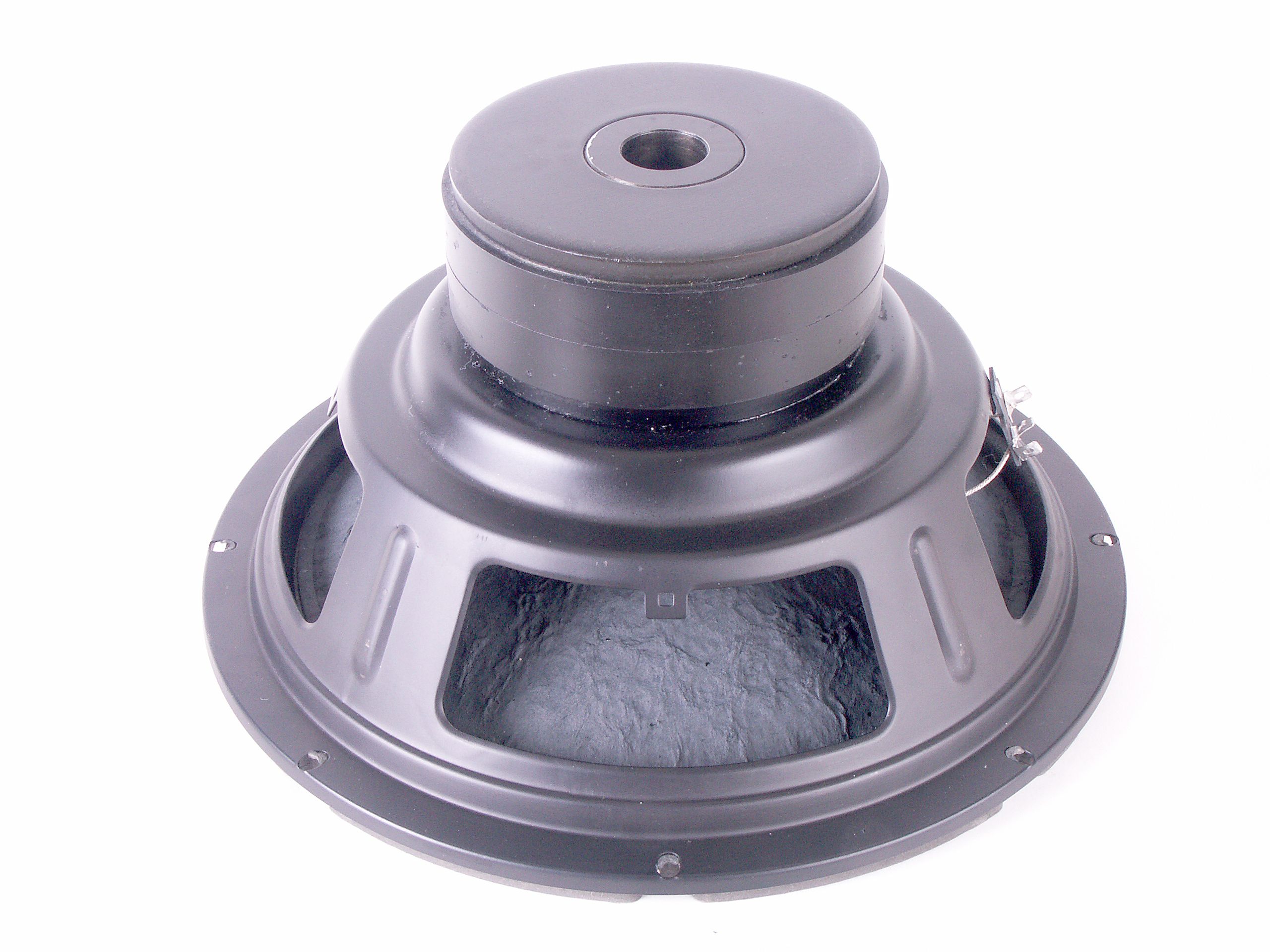

File comment: Side view showing flocked paper cone

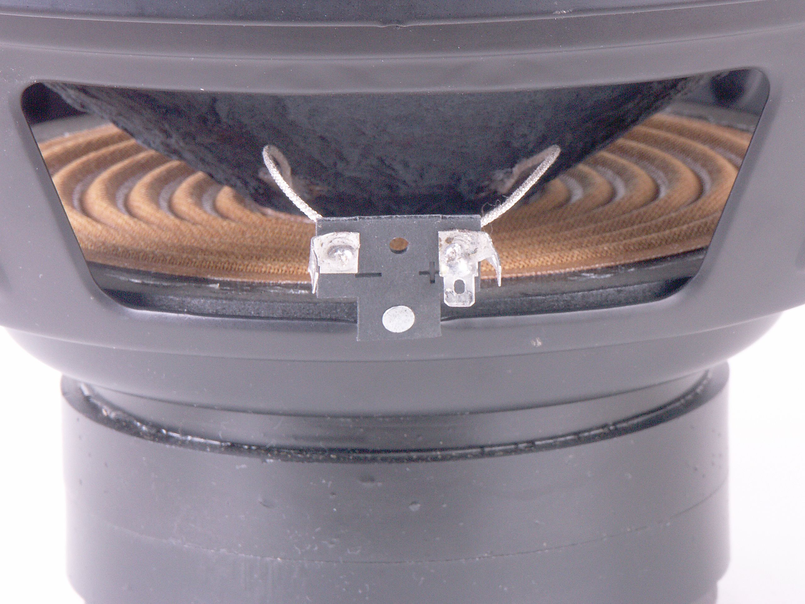

File comment: Terminals and free floating tinsel leads
