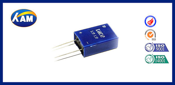

I installed a 1-farad super capacitor (1F=1,000,000-ufd) across the 5-vdc supply right at the input RCA connectors signal grounds on two different equalizers (E-1 and 003). The end result was the same with both. Actually, it wasn’t even contest. The super capacitors effectively locked the IR LEDs in a “DC supply vault” that disabled the cross-talk. The overall playback quality was beyond my expectations. It was bigger in terms of imaging – was more transparent revealing subtle details that were smooched over – and with the extra side benefit of being sweeter and more musical. Better overall focus is the bottom line here.

The cap that was used for this upgrade was the 5.5V 1F SP KAMCAP Combined Farad Super Capacitor ultra-capacitor. This is the standard power series in the product line with typical applications being RAM, detonator, car recorder, smart meter, vacuum switch, digital camera, motor drive, clock circuit, UPS, toy, program-controlled switch, etc.
