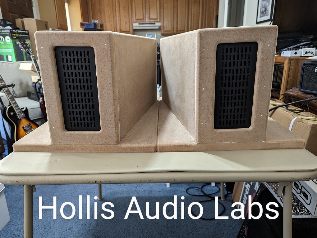

Got a pair of the new Radian LM10n planar drivers to try out. It is a wideband driver with response from 150Hz to 20KHz with EQ and XO.
Putting them in the original Magnetar speaker baffles for testing. This should be interesting. :)

PostPosted: February 13th, 2023, 2:54 am
I always wondered on the design of your "open baffle-boxes". What does onside open versus one side closed benefit sound wise?.
PostPosted: February 13th, 2023, 12:25 pm
Posts: 928
The asymetrical wing baffle gives extended low frequencies from the length, but minimizes any horn effects from a symmetrical folded wing. Also makes the speaker much more narrow than a open flat baffle. This helps with imaging.

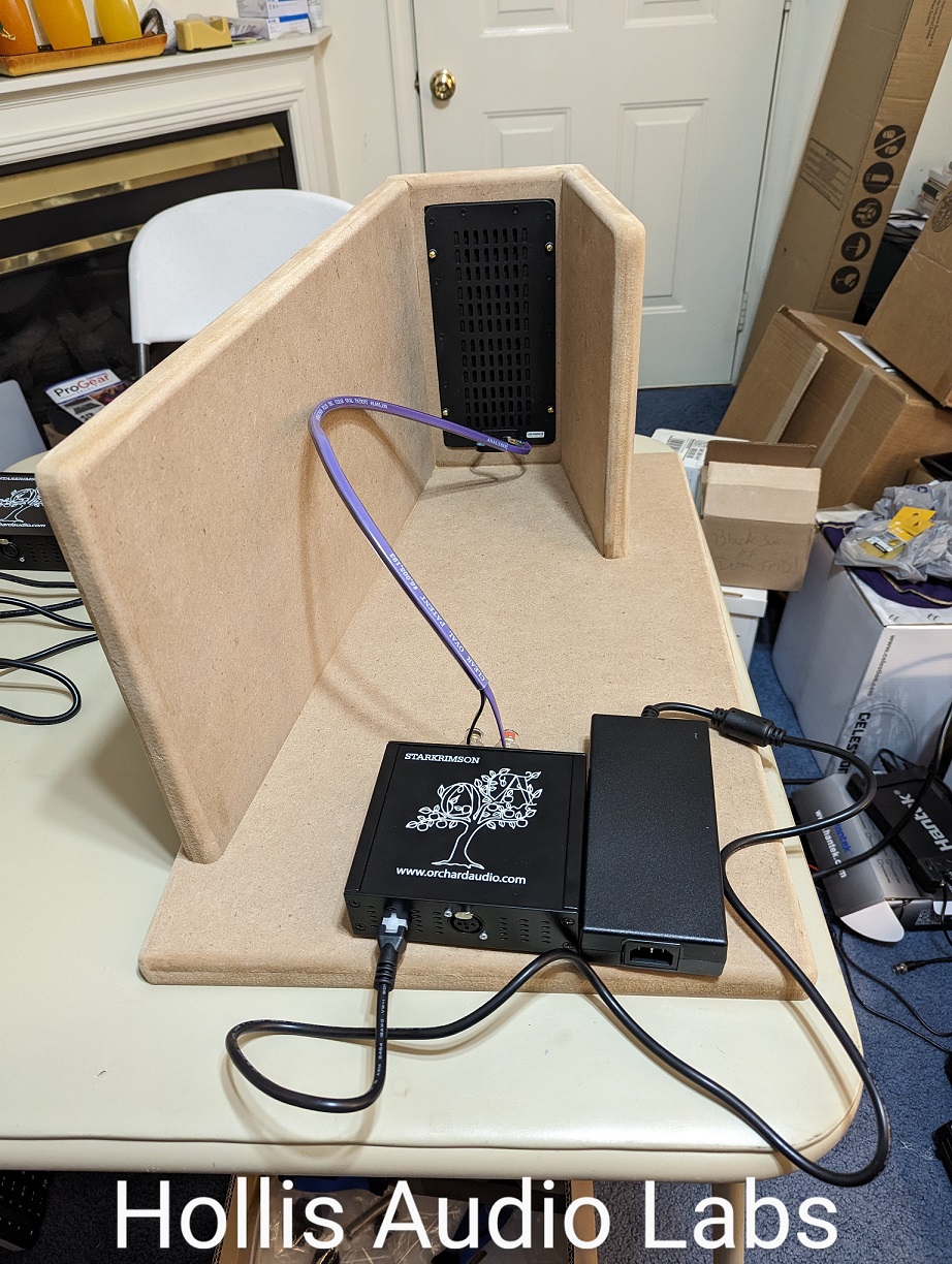

PostPosted: February 17th, 2023, 10:48 pm
Posts: 928
The Magnetar II planars are wired up and the Orchard Audio Starkrimson GaN Class D monoblocks are setup for testing.

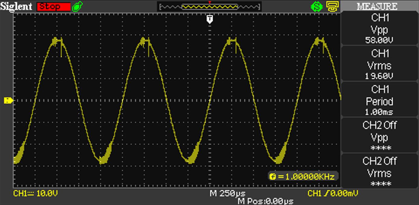

PostPosted: February 18th, 2023, 1:53 pm
Rich:
How does the Starkrimson behave when clipped? I have seen some of the new ultra low distortion amps create spikes and oscillations when clipped, unlike my traditional amps that come out cleanly. I think it is because they operate right on the edge to get those low distortion numbers. I'm including a measurement I made recently with the highly rated Topping LA90 amp.
PostPosted: February 18th, 2023, 5:05 pm
Posts: 928
Tom,
I have not tried to measure the clipping on the Starkrimson 150watt monoblocks. The AudioXpress article on the comparison of the BOSC (original name of the Starkrimson amp) to the PureFi did not include that as well, even though there is a PureFi sinewave picture, but none for the BOSC.
Not sure if my 8 Ohm, 220 watt dummy load is still around, but will look. Might be able to use CLIO Pocket for the measurement, just never tried it.

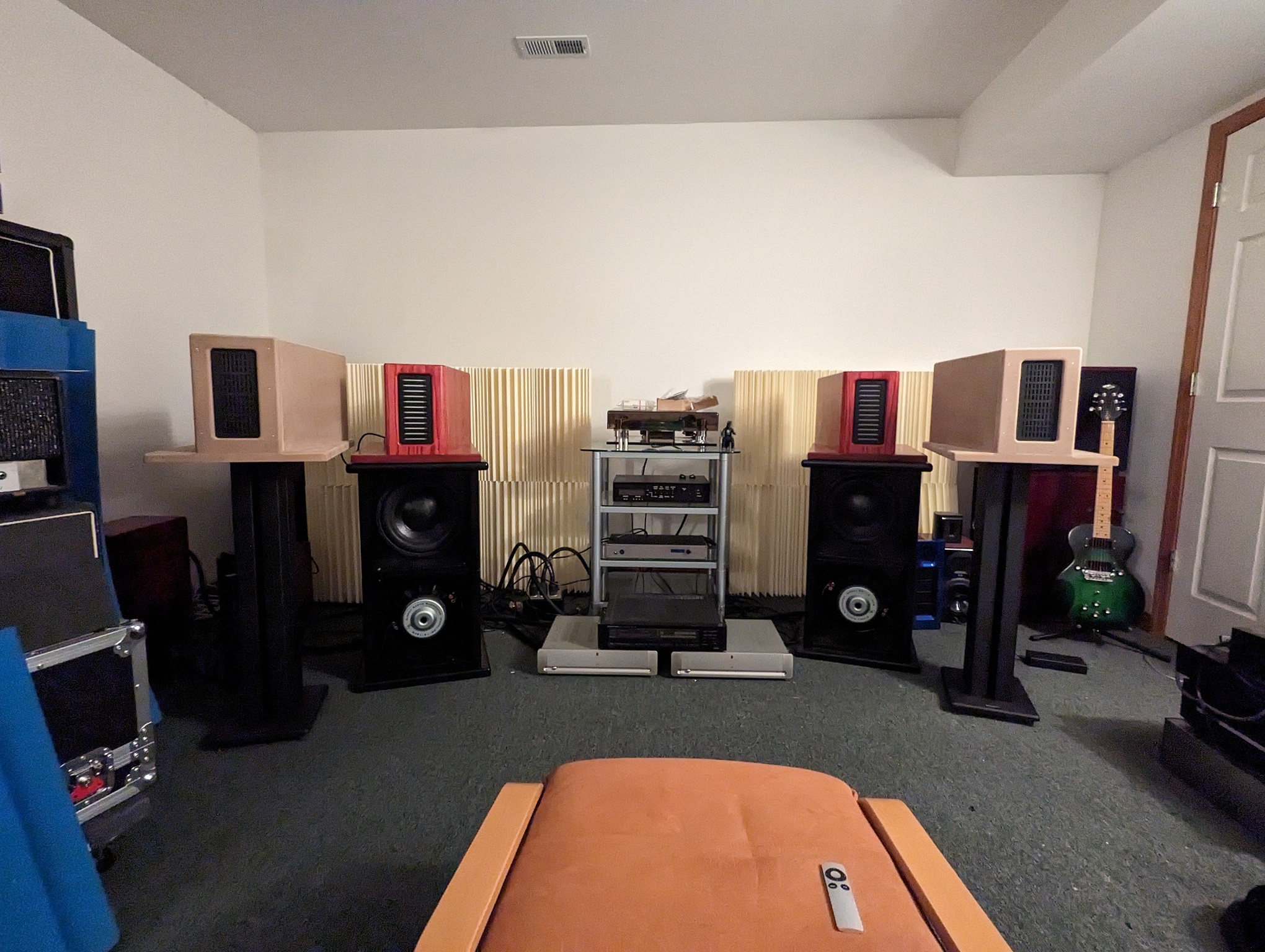

PostPosted: April 10th, 2023, 10:49 pm
Posts: 928
Starting tomorrow, testing of the Magnetar 2 speakers begins. Will be using the new powered measurement mic option of the dspNexus 2x8 prototype as the latest firmware update has the options for use included. Have a Behringer ECM8000 with calibration data files to try with Room EQ Wizard for the measurements.
The dspNexus 2x8 prototype is on the shelf waiting on balanced connections to the Orchard Audio Starkrimson monoblock amps connected with 2ft of Analysis Plus Clear Oval 14 speaker cable. The monoblock sits on the end of the planar folded baffle. An Intel NUC i5 will be running AudioWeaver for dspNexus 2x8 programming.
New room treatments arrive on Wednesday to install.
