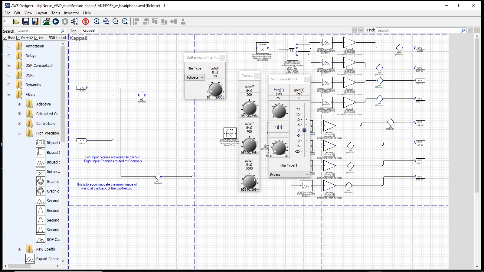

Will post pictures of the process along the way of replacing the passive crossover with the DSP crossover from measurements.

Which DSP crossover are you using?

Using the Danville Signal dspNexus 2x8 DSP processor:

Great speaker but the 90 Hz crossover point will put a lot of strain on the 5" lower mid driver. I'd try a 200 Hz crossover with the Nexus which should improve dynamic capabilities. The 12" woofer will still be omni at that frequency.

Already have a prototype DSP crossover ready, so will update it with the suggested XO for the 12in and 5in drivers.

The beginning of the Infinity Kappa 8 DSP crossover design with DSP Concepts Audio Weaver for the dspNexus 2x8.

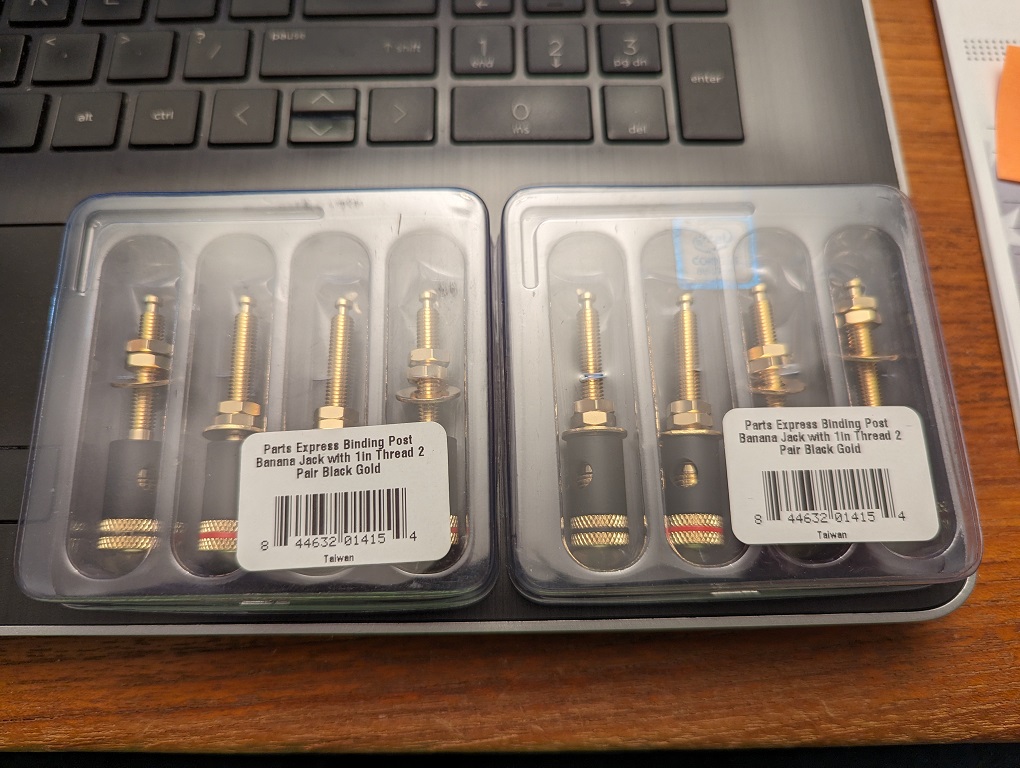

Parts to mod the Kappa 8's are arriving. Going to use Belden 1309A 14awg stranded cable to each driver that is already here.
Hope to hear about the Polydome K midrange and 12in woofer driver repairs by this weekend.
Some Parts-Express binding posts to add enough pairs for each driver in the speakers. Will be paralleling the two EMIT tweeters to make a bipole radiation pattern. The original design seems to be an ambience tweeter in phase with the front driver.
PostPosted: May 29th, 2024, 2:40 pm
:character-oldtimer: Be careful with those if you're using banana plugs, these have to be screwed down tight to get a good connection even with banana plugs...
