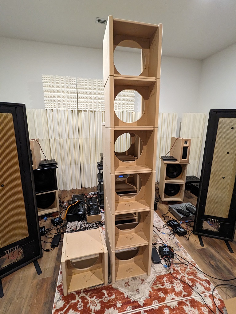

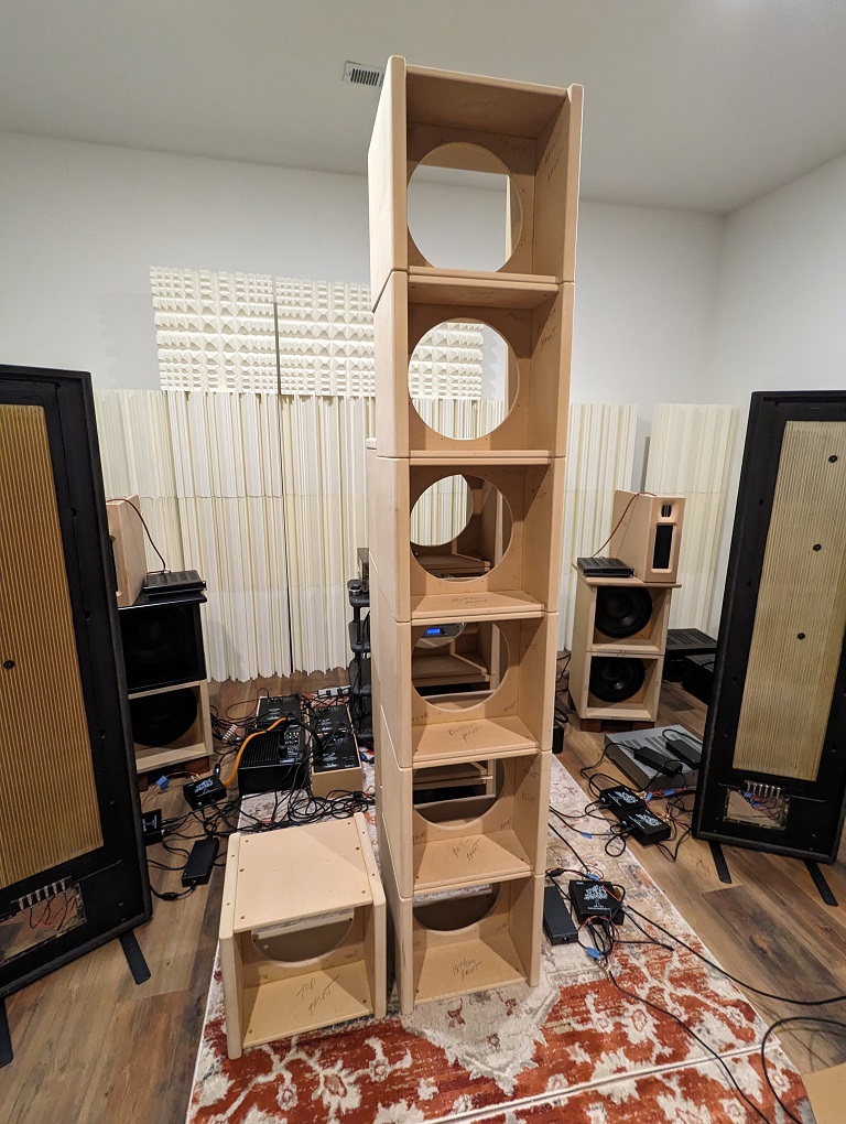

The AGN II is a two way line array project. It will use a modified version of the AGN baffle to use 6 Radian Audio LM10n planars for 200Hz and up with a 6x12in OB H-Frame servo sub array for 14Hz to 200Hz.
The two 6x12 OB H-Frame cabinets are complete and ready to paint. Dropping the off next week for finishing.
Will be getting the original planar baffles modified to install the longer LM10n's as the original DFA-510 planars are shorter. but the same width.

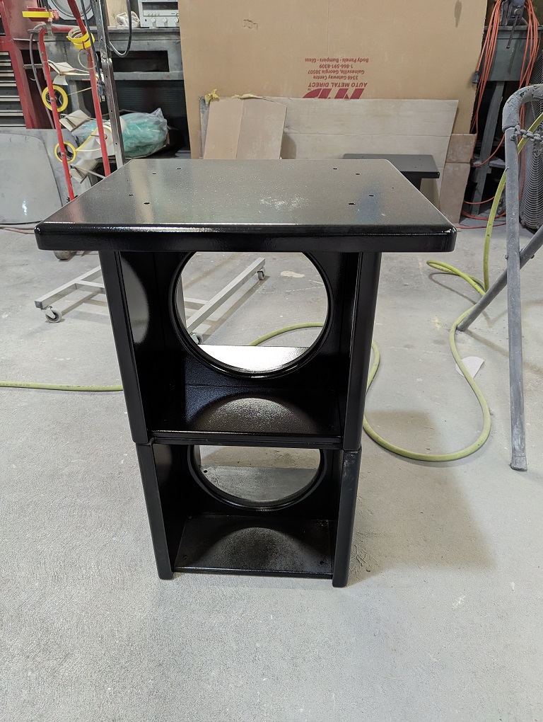

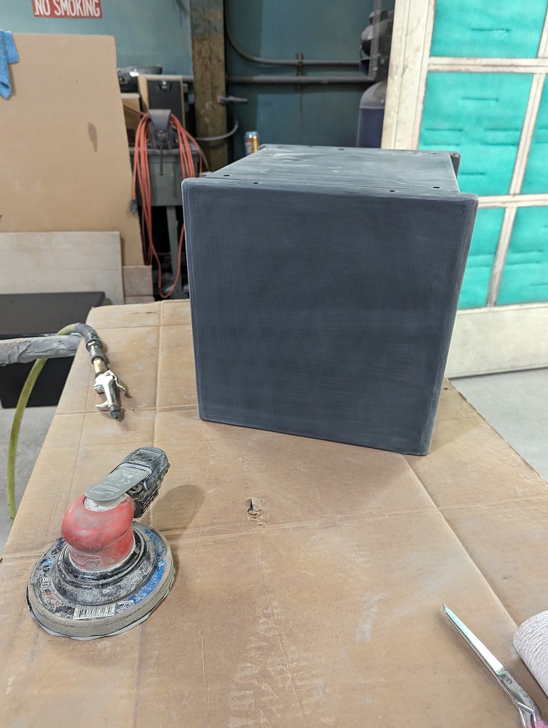

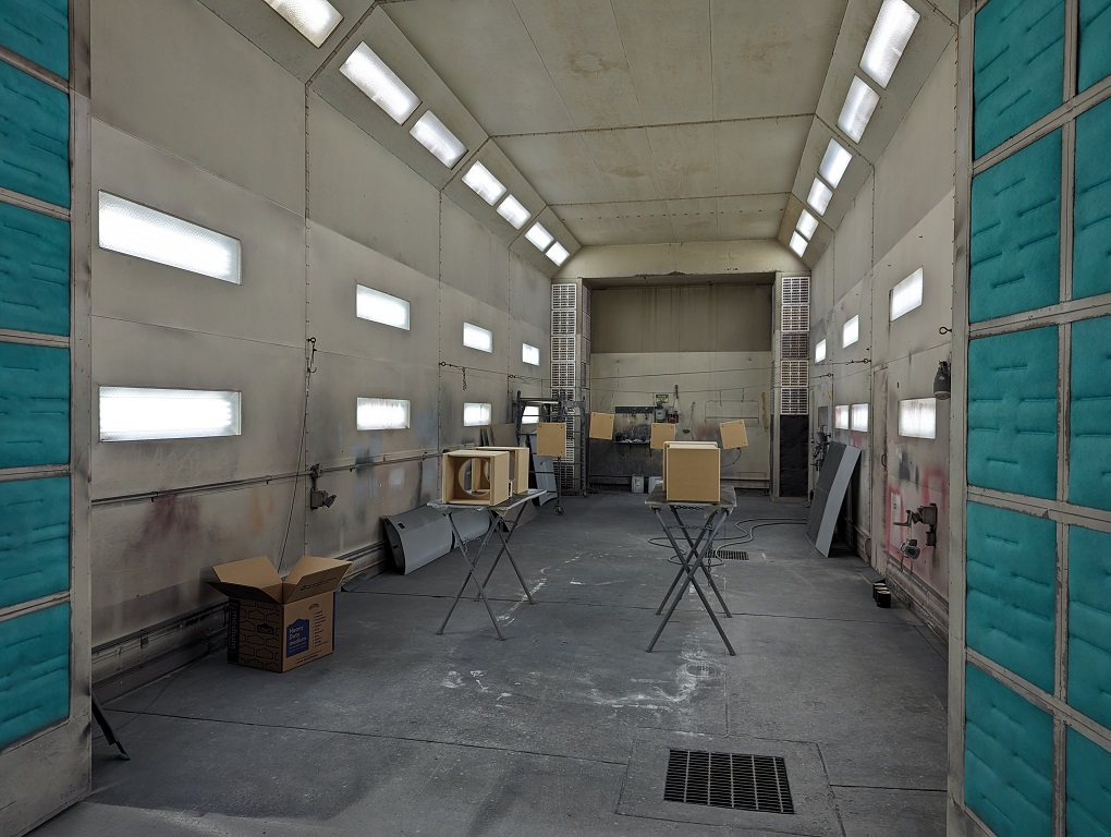

The 8 step automotive paint process has started.

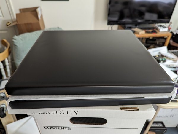

All the sub modules are now painted and here.
A low gloss Hot Rod Black color. They do a great job on finishing!
Next it installing the 12-12in servo drivers and wiring.
