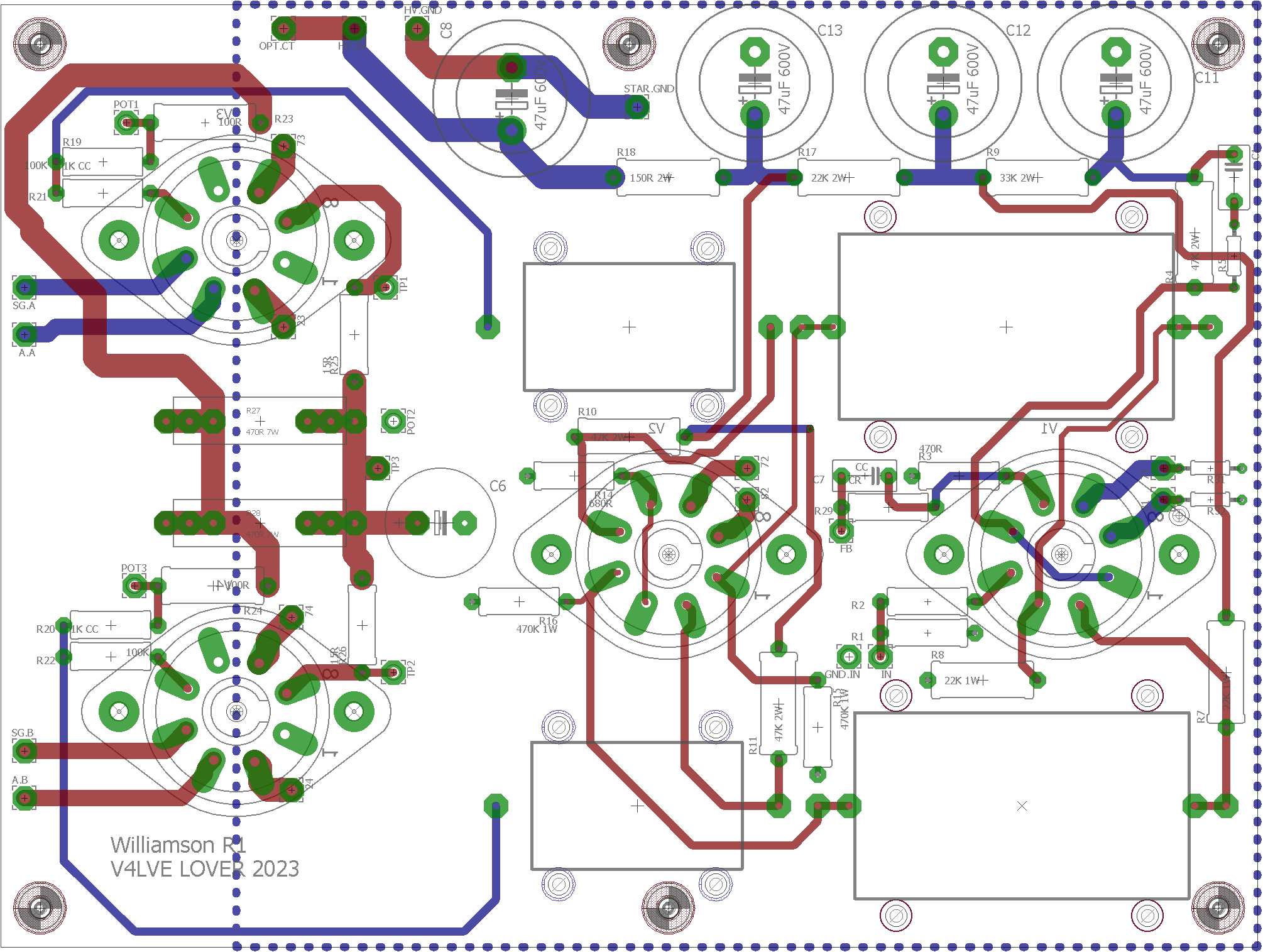

He worked up a nice, heavy-duty 6" x 8" PCB for a standard, Heathkit-style Williamson. The board contains everything except the transformers, choke, rectifier, first cap, balance pot and filament wiring, which must be added by hand to the provided eyelets. The octal socket spaces are designed for the Belton PCB-style one, with standoffs included for strain relief. I designed it specifically with the Heyboer copy of the Peerless S-265-Q in mind, but you could used any output transformer and tweak the step filter and phase-lead cap. A batch of 10 is on the way from the Netherlands, but I paid him for the design and he sent me the Gerbers etc. so I can have them made. Pics follow in the thread.

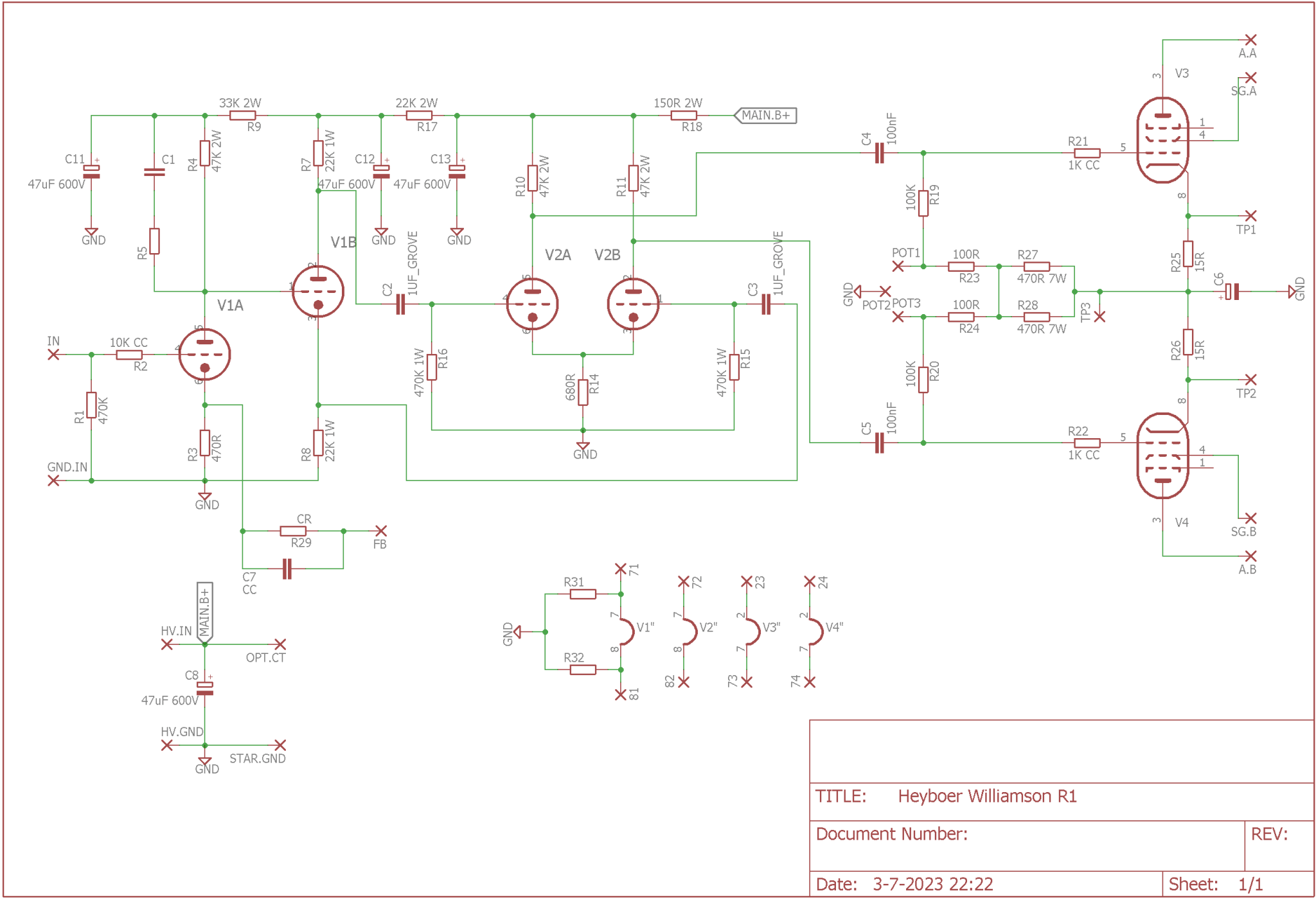

Here's the schematic. You could adapt this for fixed bias, also for any number of Williamson variants, like the Heathkit W-5, using 12AU7 tube adapters.

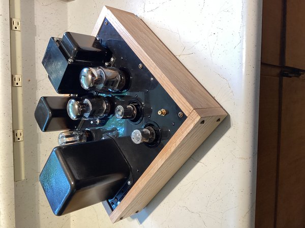

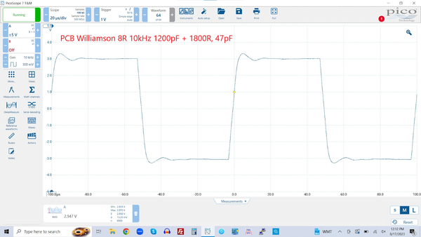

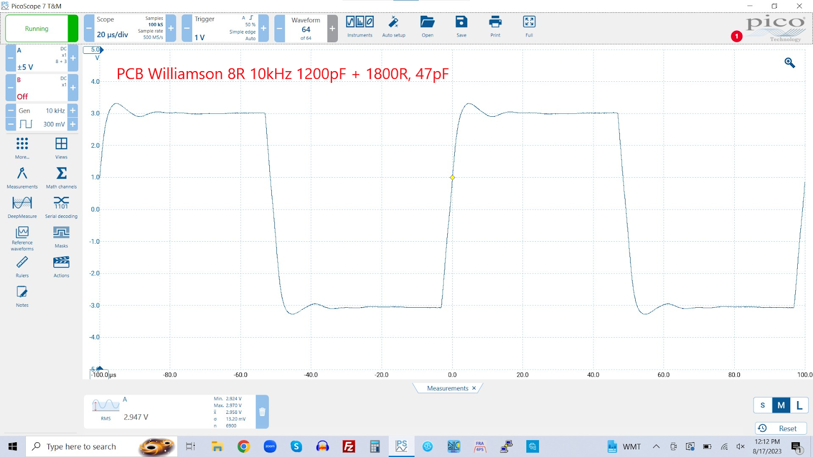

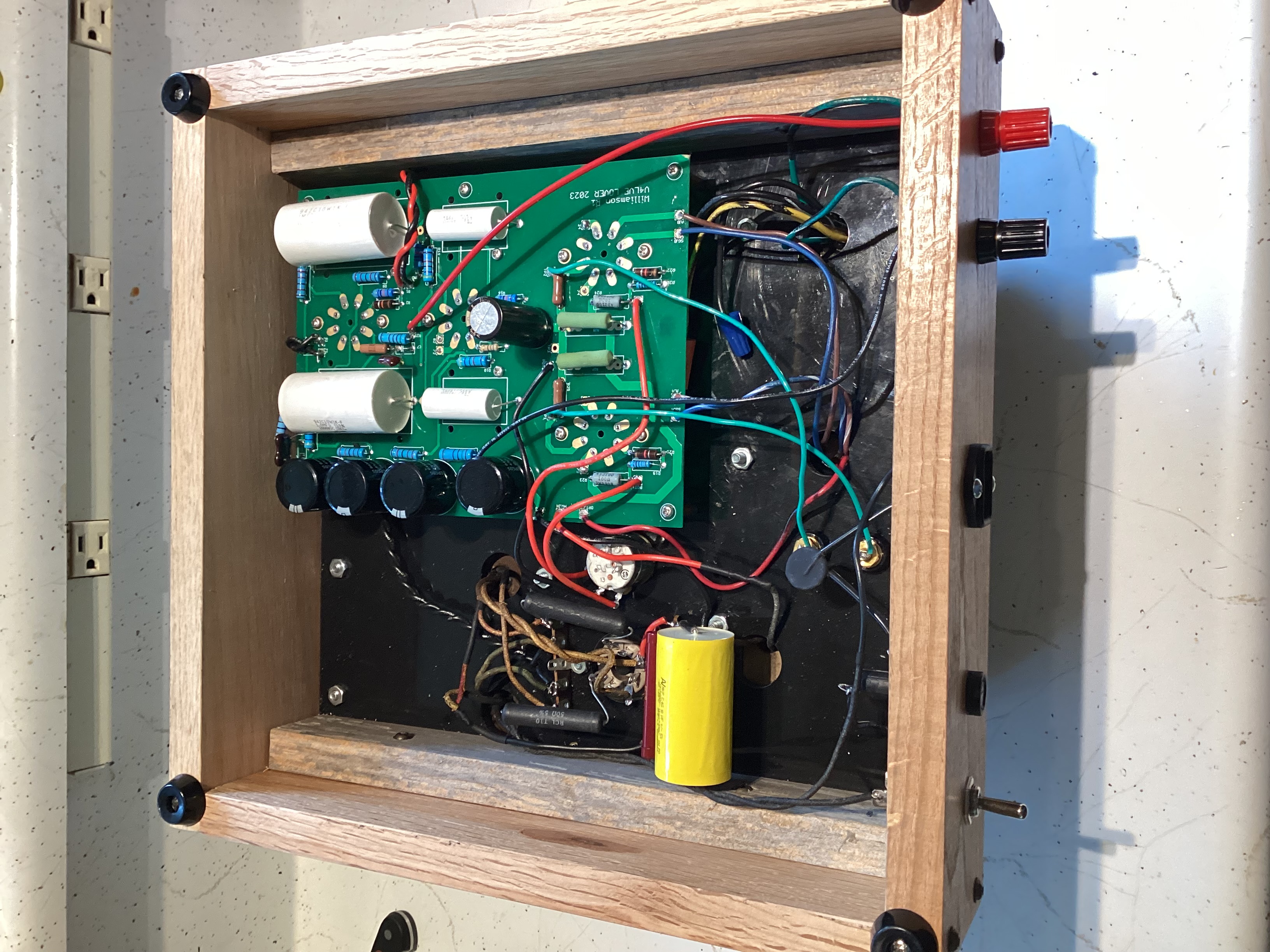

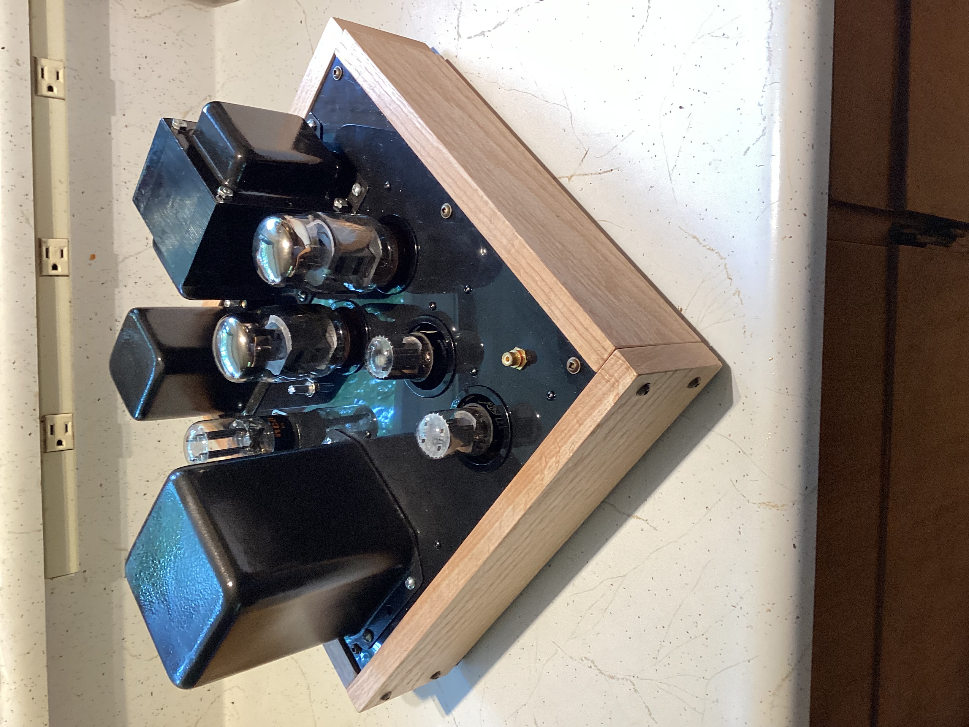

I finally built a pair of monoblocks with the PCBs and the results exceeeded my expectations. With some feedback tuning advice from an eminent Williamson expert at Audiokarma, I was able to achieve consistent results regardless of the output tap. The top plate is Delrin and the choke and power tranny are salvaged from old Heathkit amps. The stability is superb, and the amps sound just wonderful--very sparky and solid. I've posted the 10K square wave results below.
