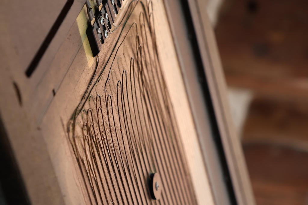

Pickup up a pair of SMGbs on the way up to WI for the annual family reunion... They needed the bass panel wires re-glued, but they're repaired now, and sounding pretty good driven by a Wadia 151 powerDAC. Next up will be some xover upgrades and better support, but those will have to wait until I get home...

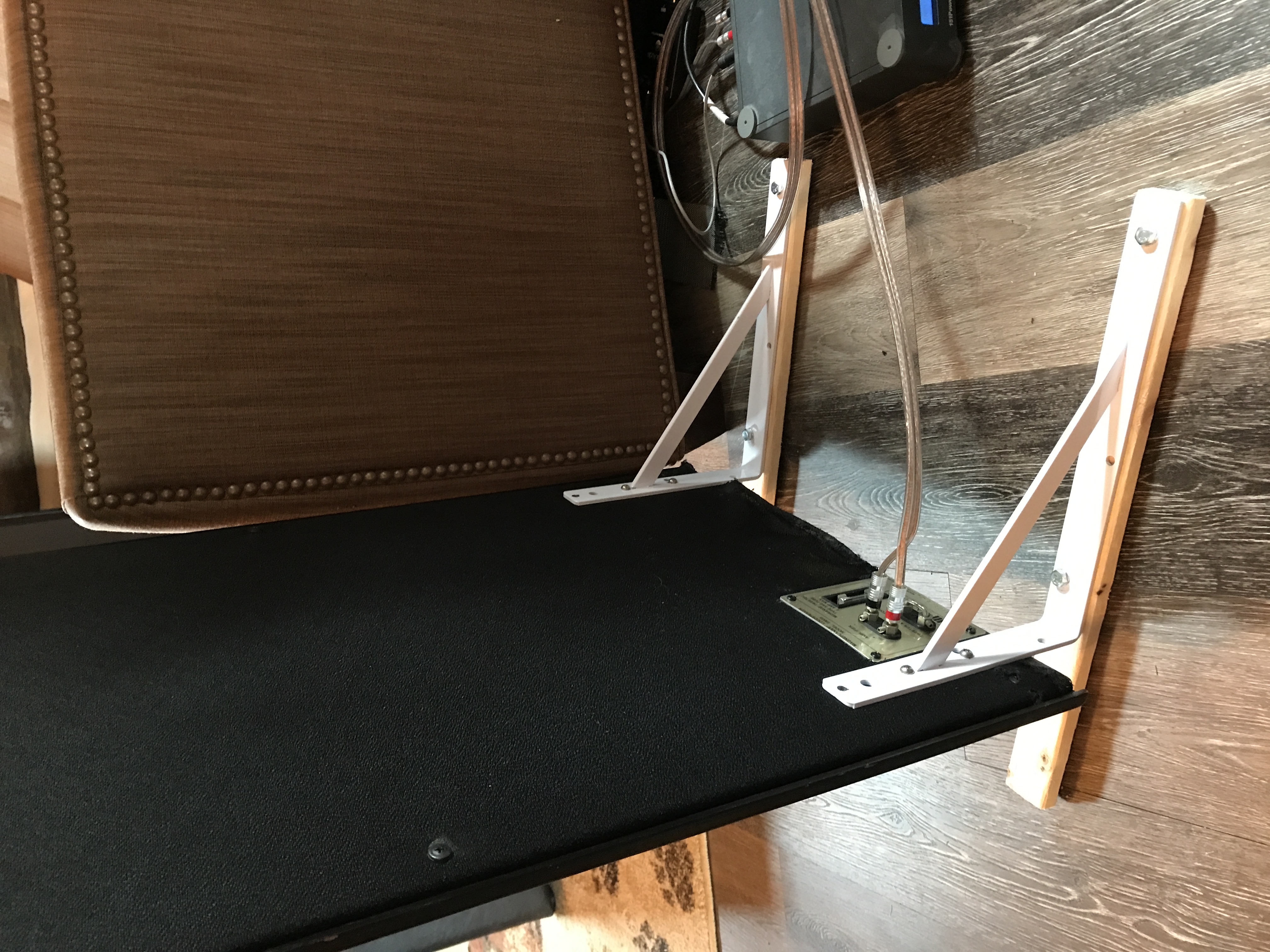

Made some new stands yesterday, based on the design here:https://www.positive-feedback.com/Issue4/magnapan1.htm Not as robust as I'd like, but a step in the right direction... The selection of shelf brackets here in the north woods isn't exactly stellar...

I had a pair of Maggie llla's that I rebuilt including replacing the MDF frame with a hardwood.
I found the biggest problem was that the speakers were only supported at the bottom allowing the tops to move about pretty freely.
I finally added a third leg from the center of the top to the floor.
PostPosted: July 18th, 2023, 6:15 pm
I'll probably run supports on both sides from part way up to the back of the stands. Different approach to the same problem...

I recall being in the Cardas room at one of the CES shows and they were using Maggies, don't remember which ones, but they had made a rigid frame that supported them over the entire length. I think it was Cardas. This frame effectively coupled the top of the speaker to the floor with some sort of flying buttress. This was a fantastic improvement to the sound. I had Maggies myself and I was familiar with their sound in stock form.

John Broskie told me the same in an email some years ago: he aimed a laser at the upper end of his Maggies with a mirror attached, and at such an angle that movement was amplified. He claimed he saw a lot of movement during playing. His solution was to connect the upper edge of the baffles to a fixed horizontal surface in the house. IIRC.
Hi Roscoe — how did you relaminate the thing? Aren’t those traces (wires) supposed to be bonded to a Mylar substrate? Apologies if I am hitting your mantra.
