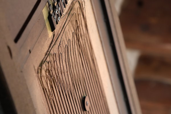

Pickup up a pair of SMGbs on the way up to WI for the annual family reunion... They needed the bass panel wires re-glued, but they're repaired now, and sounding pretty good driven by a Wadia 151 powerDAC. Next up will be some xover upgrades and better support, but those will have to wait until I get home...

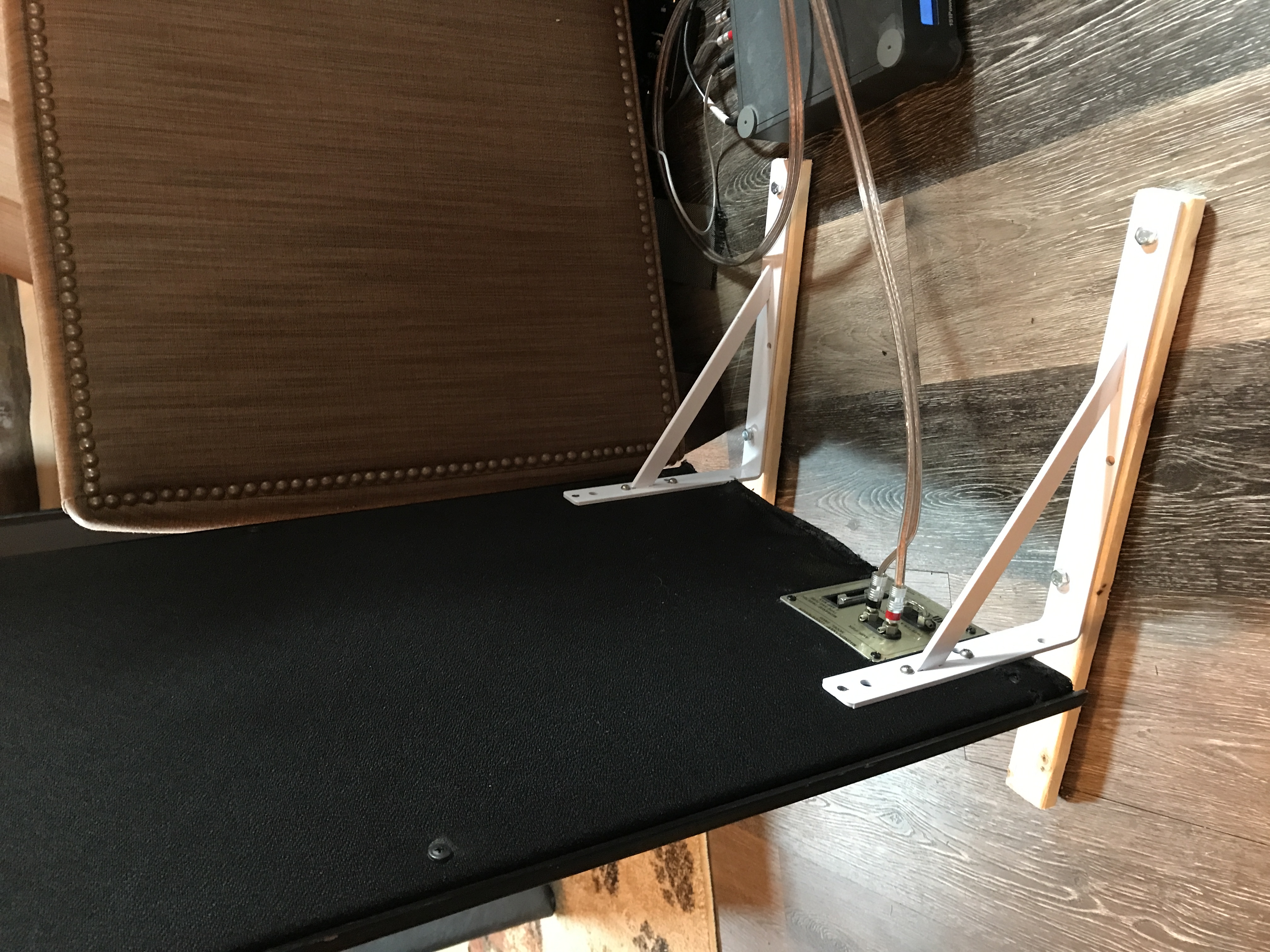

Made some new stands yesterday, based on the design here:https://www.positive-feedback.com/Issue4/magnapan1.htm Not as robust as I'd like, but a step in the right direction... The selection of shelf brackets here in the north woods isn't exactly stellar...

I had a pair of Maggie llla's that I rebuilt including replacing the MDF frame with a hardwood.
I found the biggest problem was that the speakers were only supported at the bottom allowing the tops to move about pretty freely.
I finally added a third leg from the center of the top to the floor.
PostPosted: July 18th, 2023, 6:15 pm
Posts: 1737
I'll probably run supports on both sides from part way up to the back of the stands. Different approach to the same problem...
Hi Roscoe — how did you relaminate the thing? Aren’t those traces (wires) supposed to be bonded to a Mylar substrate? Apologies if I am hitting your mantra.
