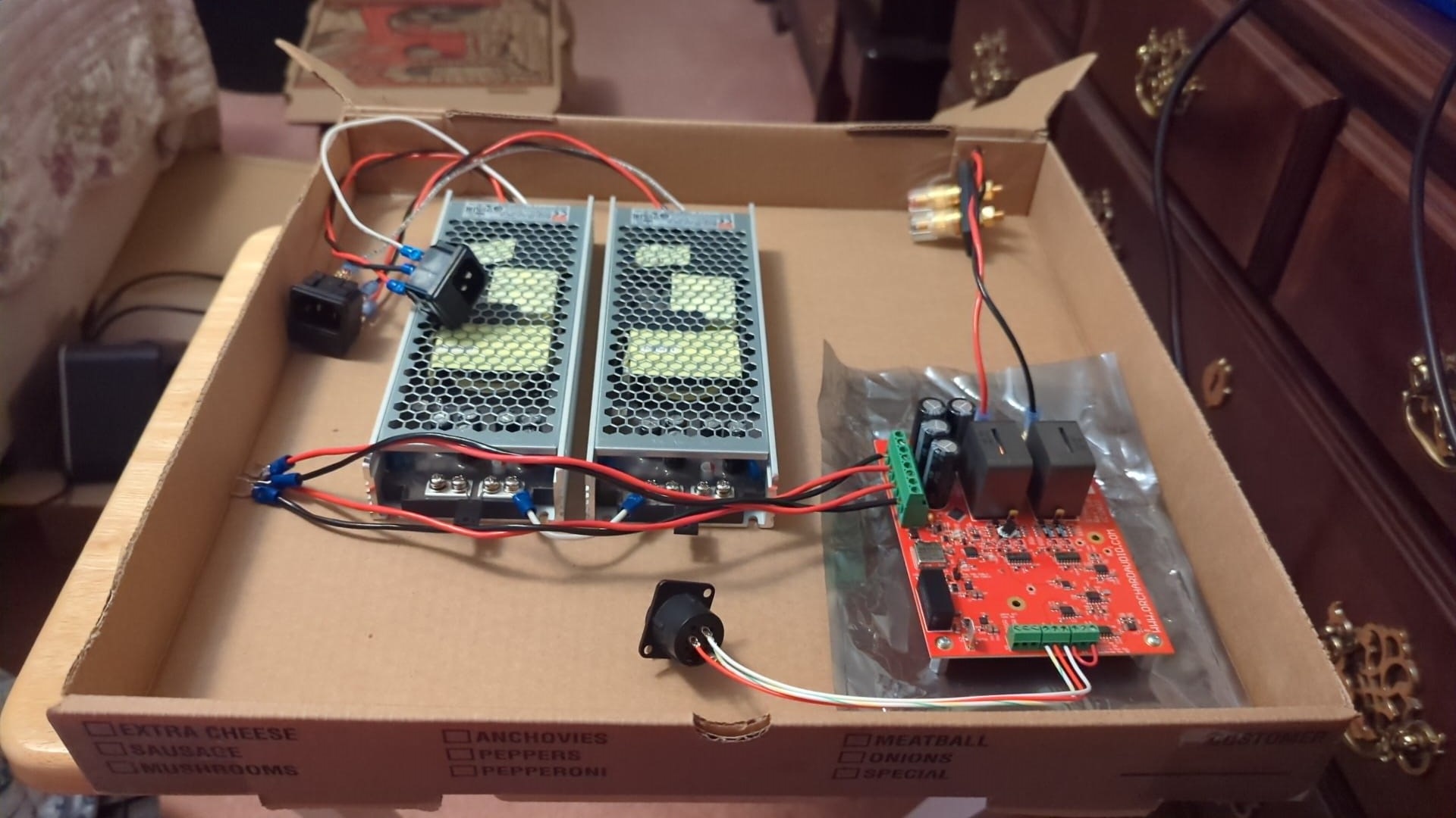

Wanted to try out the Orchard Audio Starkrimson Ultra Class D amp DIY modules and decided to purchase a pair from Leo.
Decided to try out a different SMPS DC power supply, so purchased a pair of Mean Well SMPS for 36VDC @13.8A PFC version units to stack for the +/-36VDC power supply requirement. This version SMPS has an aluminum case for cooling and shielding. Yes, this does mean the total SMPS is capable of 1000W power to the amp modules. This will probably need a soft start circuit added eventually.
I am terrible at making chassis for projects, so picked up some 16in pizza boxes for the temporary housing. Used something similar for the LM3886 Chip Amp project awhile ago, but these are better built boxes. The SMPS are actually lighter than the toroidal transformers I used for the earlier amp linear power supply.
Testing the SMPS first to make sure stacking is not a problem with small load resistors before connection to the DIY amp modules.
348687987_1430182067736026_9190901585916321282_n.jpg [ 310.23 KiB | Viewed 548736 times ]
