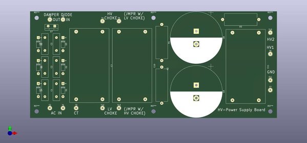

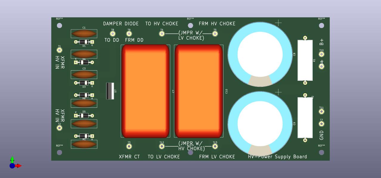

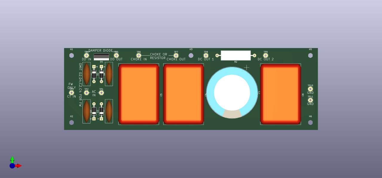

I have designed a couple of power supply boards using DC Link capacitors and KEMET high reliability electrolytic capacitors for the 211 SET rebuild project I am working on for Myles Burgess. I am doing the final check on them before sending them out to fabrication, but I have designed the Driver Power supply board to be applicable for other designs up to 600V. Since per board costs in qty are pretty cheap, I can make extras for use in other builds.
A few words about the boards.
The HV board is a CLC circuit for up to 1200V output using a FW rectifier with three (3) stacked UF4007 diodes per side with 0.01uF/1000V bypass caps to ensure equal voltage handling on each diode. Using a series SiC diode at the output of the FW rectifier to prevent any reverse recovery spike on the UF4007 diodes, optionally an offboard damper diode can be used for the same function plus soft start. Included is the provision for offboard power chokes, either on the HV side or the Ground side depending on whether your chokes can take the elevated B+. The DC link capacitors are Vishay 20uF/1200VDC, the two series connected electrolytics are nominally 390uF/600VDC KEMETs (15000 Hr). Of course using voltage equalizing resistors in parallel with the capacitors.
The Driver board is a CLCRC circuit for up to 600V output. Rectifier can be either bridge (no CT) or FW (with CT, omitting two diodes). Again, using UF4007 diodes with SiC or tube damper diode at the output of the rectifiers. Instead of a choke, the pad spacing will accept a power resistor in the first Pi filter. The design uses Panasonic 40uF/600VDC DC link capacitors and KEMET 220uF/600V long life electrolytic caps. There are two DC outputs after each filter stage.
Attached are some pictures of the design, the layout is compact and should fit nicely in a chassis. The boards are designed with the traces on the back side but through-hole pads.
Let me know if you are interested in a few boards. I do not expect the cost to be more than a few $ per board.

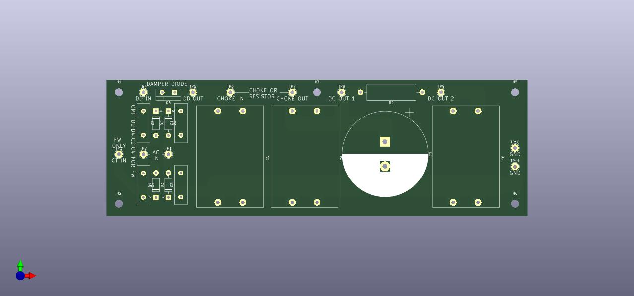

Now with the Driver Supply Board (more general application)
Driver Power Supply Layout.pdf [47.39 KiB]
Downloaded 2775 times

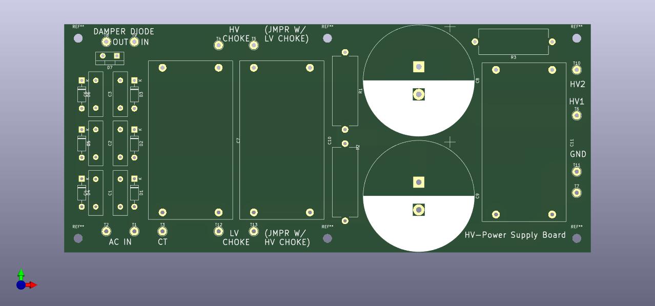

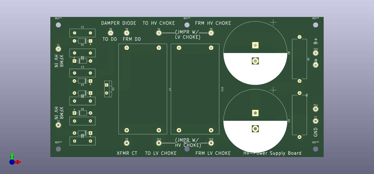

Jim,
No 211 amplifier for me...I have a GM70, plus SE output transformers for a transmitter tube amplifier are very rare and very dear. I am using the MQ FS-100 from Grover's amp. I have a pair of Tamura outputs on my GM70's.
What this project will propel me to do is rebuild my GM70 amps to a more compact (and more portable) size and rework the driver stage for A2 operation to get additional power. My current transformer coupled single stage driver does not have the voltage swing or current drive capability for much of any A2 operation (it is at least is immune to blocking at the transition), I need a two stage driver with PowerDrive to get there. The boards I am designing will work with that setup, should I choose. I am also looking at an all poly cap power supply arrangement, but probably not worth the extra cost.

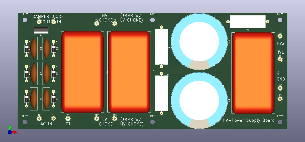

The boards are still being refined. I caught an error in the direction of rectifier diodes in the bridge on the Driver Board (quickly corrected), but based on some feedback from Charlie, I reworked the HV Power Supply board rearranging the rectifier and adding another filter stage. This will work better as a generic power supply board, basically a higher voltage equivalent to the Driver Power Supply board which is similarly a CLCRC arrangement.
