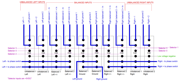

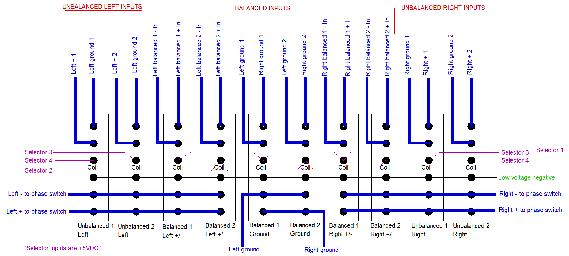

Four inputs, reed relay switched, and two outputs, one effectively high pass around 100Hz with my crossover, and the other full range. Two inputs are balanced, two unbalanced.

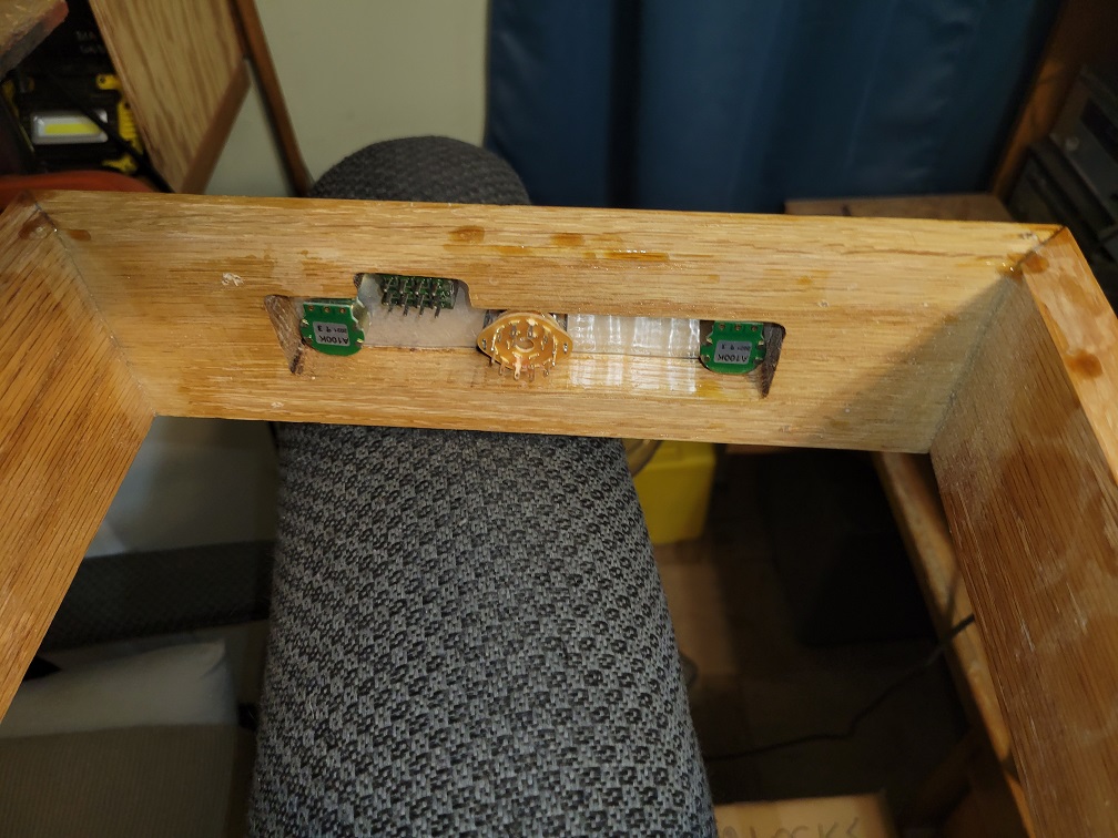

Each channel has a separate gain control. They are 100k stereo stepped attenuators (from eBay). Very small and they use surface mount resistors. Should provide very close tracking +/-.

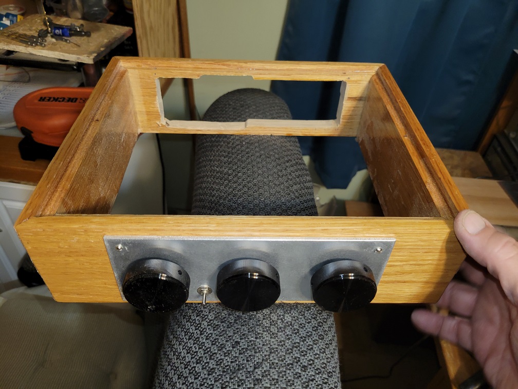

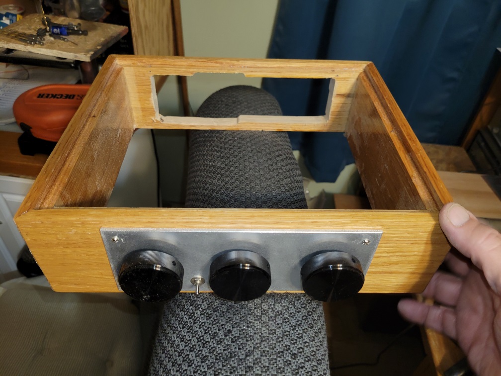

Using a chassis from an abandoned project: hardwood sides and 1/4" plastic top plate. So, yeah, true to form, it's not pretty!

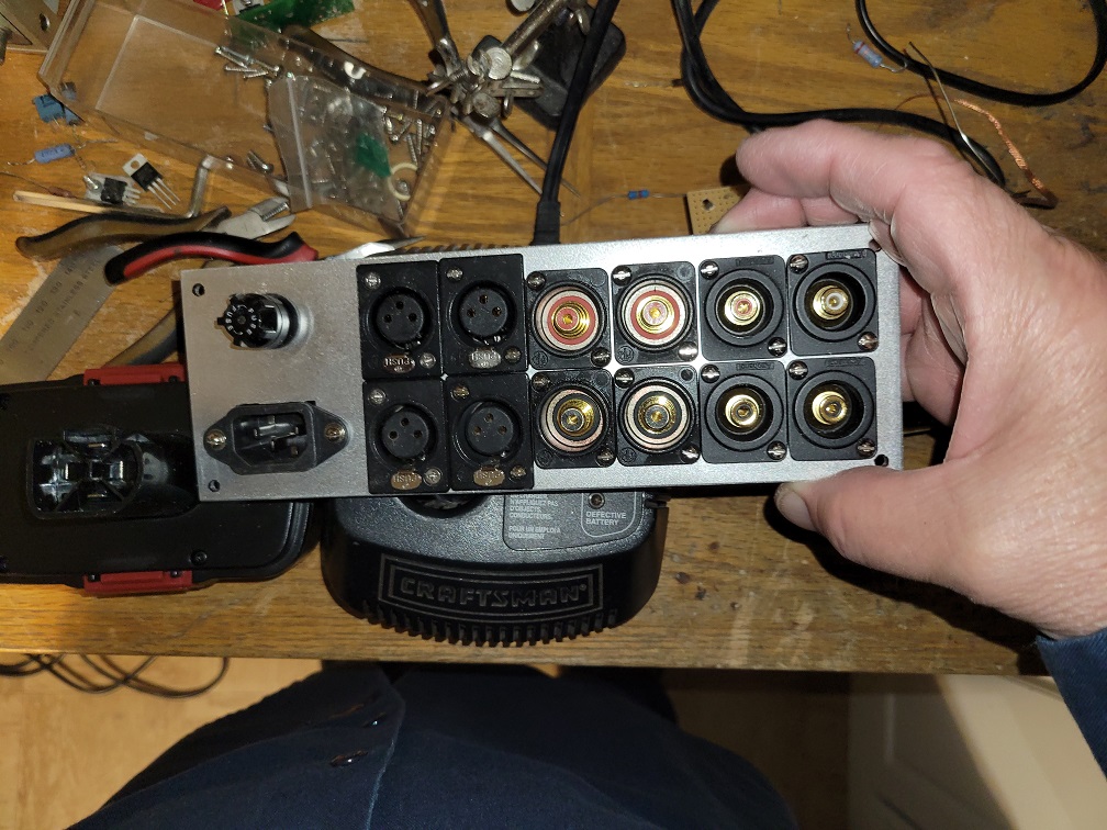

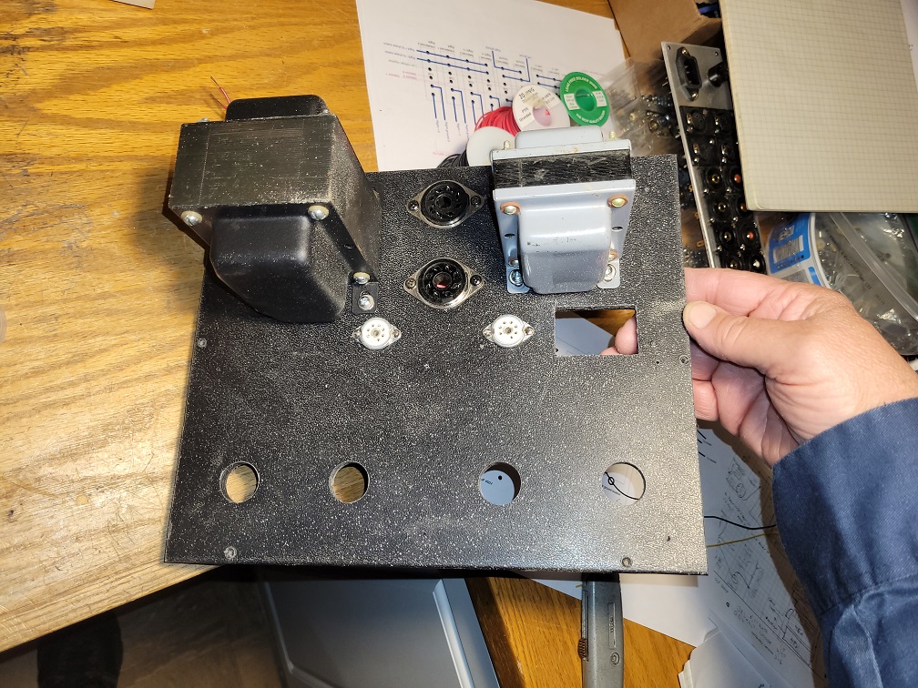

More pics
