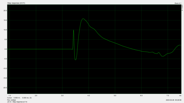

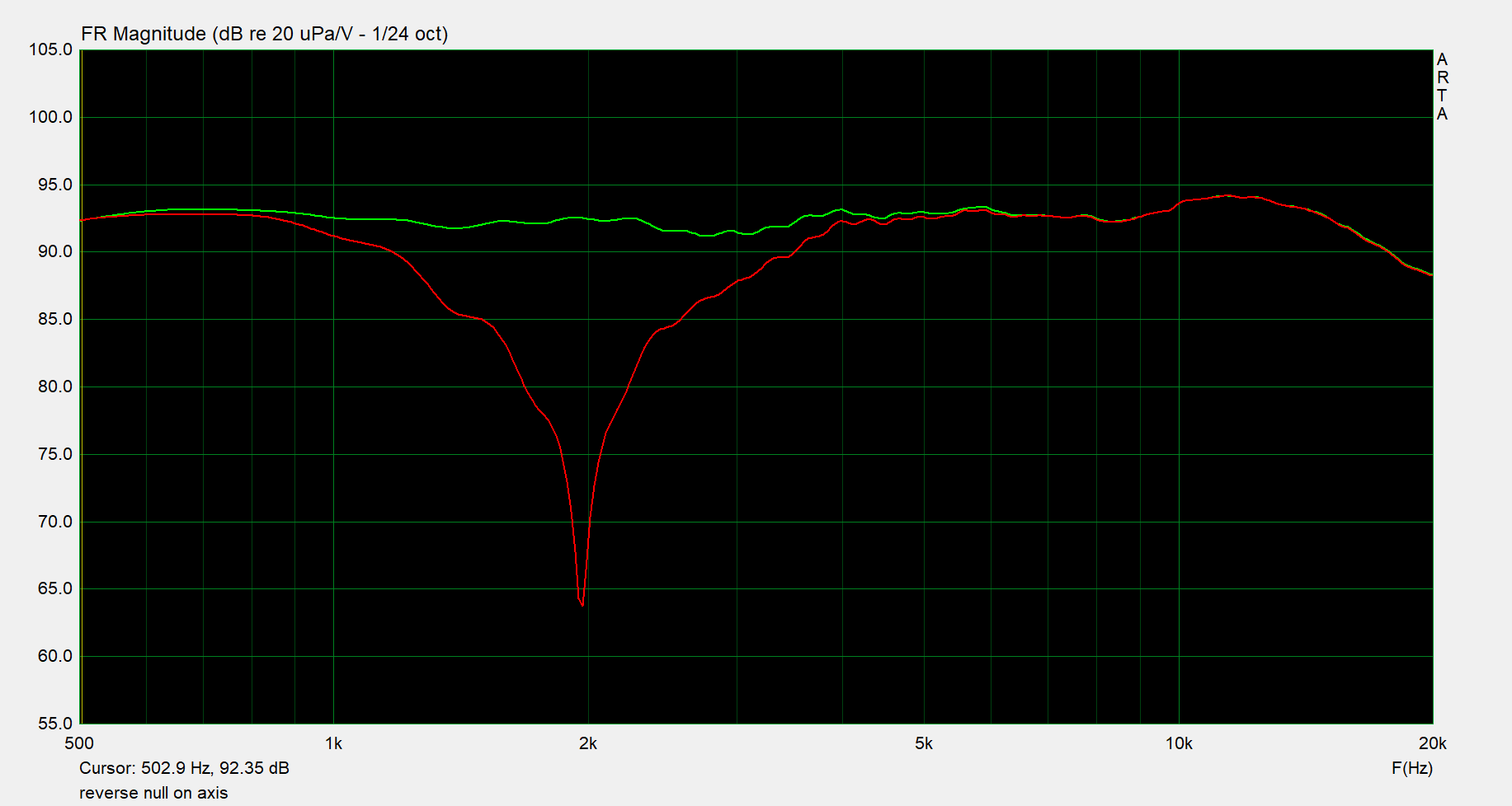

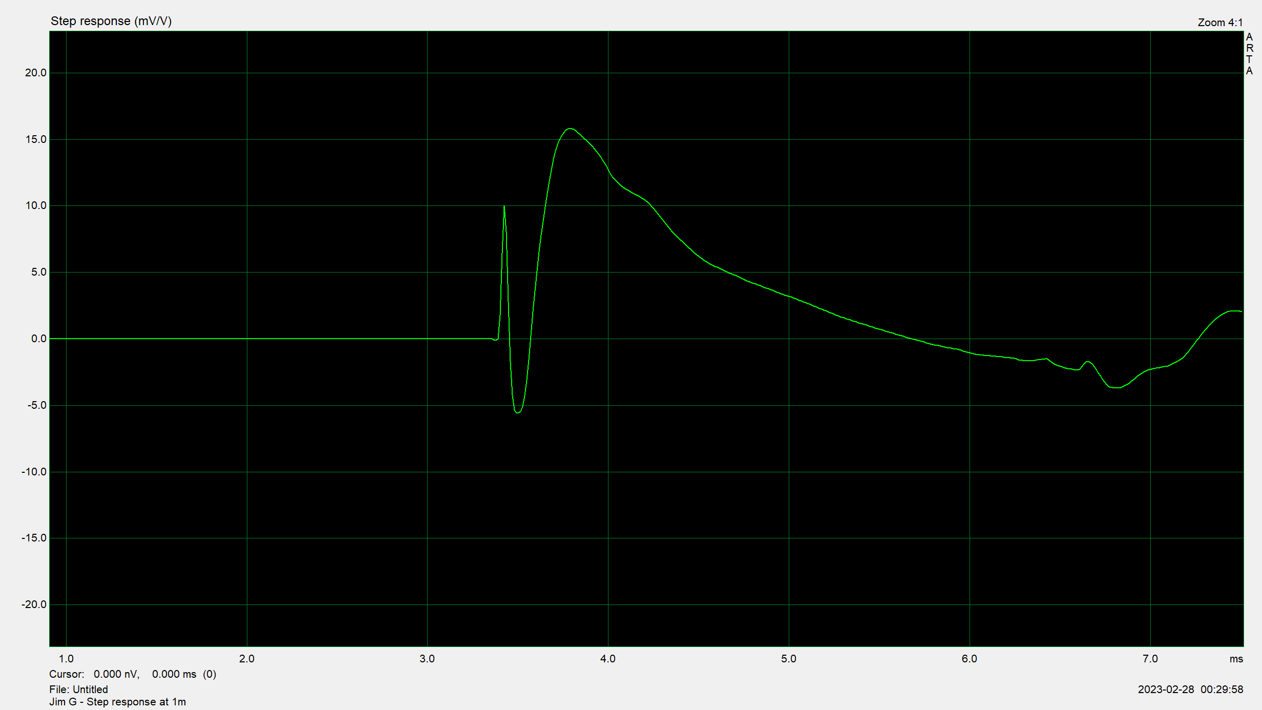

I'm not sure if Dhar has distortion measurements but they are extremely low. Here's the step response and null.
