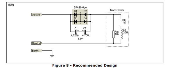

I have an iso-tranny on my low-level equipment that buzzes periodically. I added this circuit a while back and have never had the problem since
