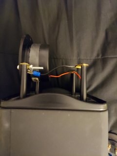

Tom has the "Eggs". Maybe, I should call them the "Toms". Tom gave me those Optimus/Lineaum bookshelf speakers. One of those funky tweeters was blown, and one of the woofers disintegrated. So, I started from scratch. I am using just the cabinet. They are not going to be great, but they will work.

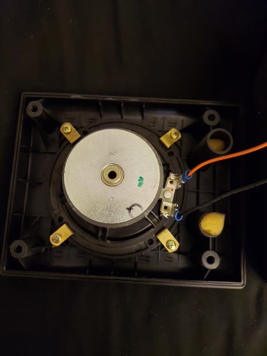

I replace the woofers with some drivers I had. I didn't have the exact size drivers I needed, so I used something smaller that happen to work using a little ingenuity. The driver isn't screwed on, it is clamped on. I wish I could have the proper sized drivers. I don't really have the bass.

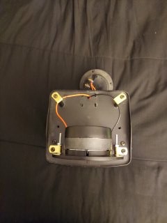

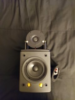

I used some ingenuity to take some tweeters and openly suspend them facing forward using the top grill mounts, as well as securing the wires before it goes into the cabinet. They look the part.
I wish I had some two-way passive crossovers to experiment with it. Right now, the drivers are wired in parallel without any crossover so the rear panel is removed with the wires sticking out.

Tweeter is a Vifa 6 ohm. It has a 5 hole mounting, but only two are used to suspend it.
Don't remember what the other driver was. I would have to disassemble the cabinet to look.

The mid-range driver is a Vifa 8 ohm.

Vifa 6 ohm tweeter, Vifa 8 ohm mid-range.

Looks good. No surprise that there is no bass there.
If you can cut the lower edge of the tweeter and mount it closer to the woofer, that will help with phase near the crossover point.
But that tweeter will die a horrible death if you don't get a series capacitor installed to it.
You could fill those voids in the cabinet structure with a pour-in compound, that will tighten up the sound, reducing resonances.
A separate woofer in a different cabinet will be the best bet for real bass.
Good job!
