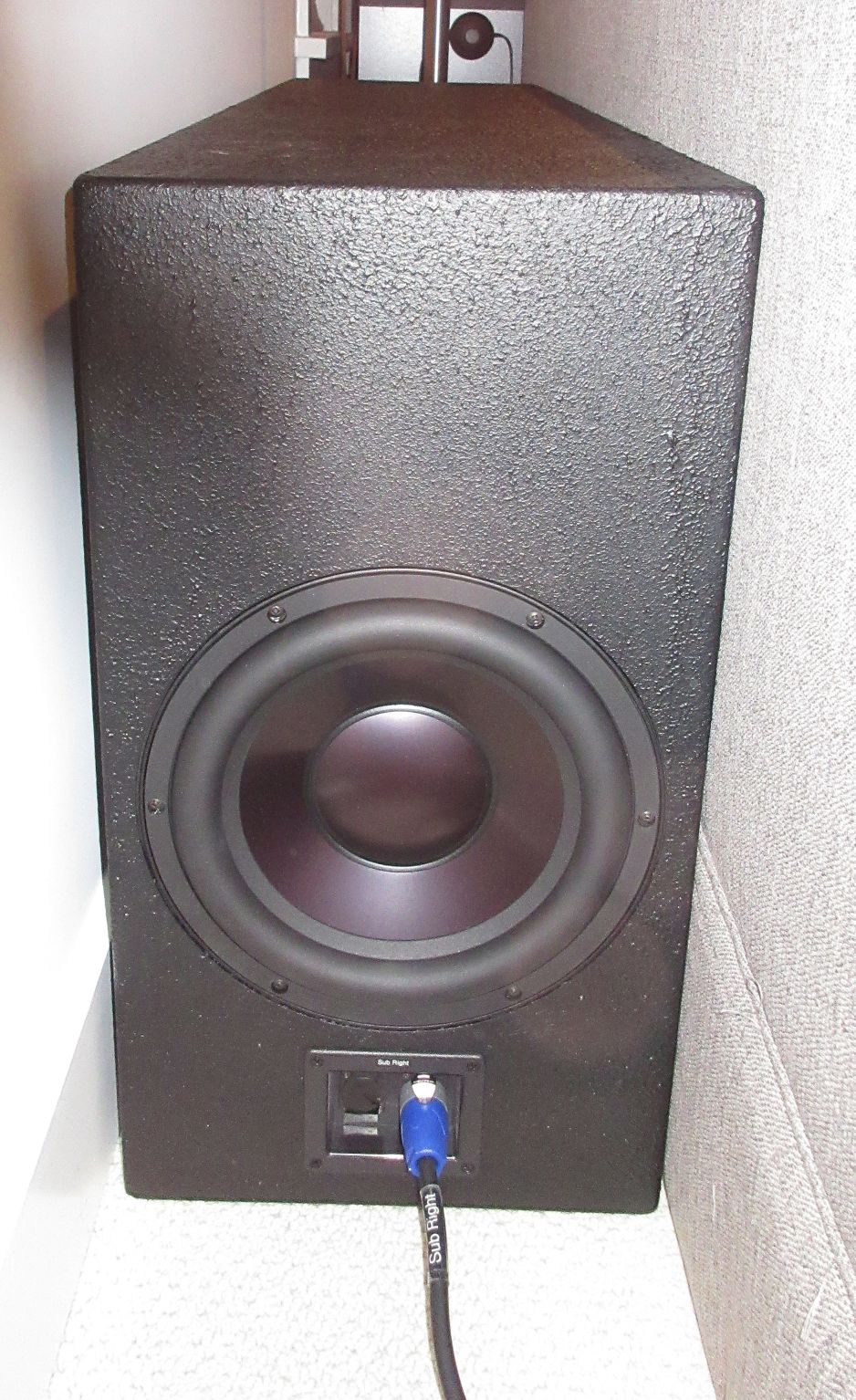

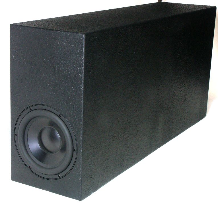

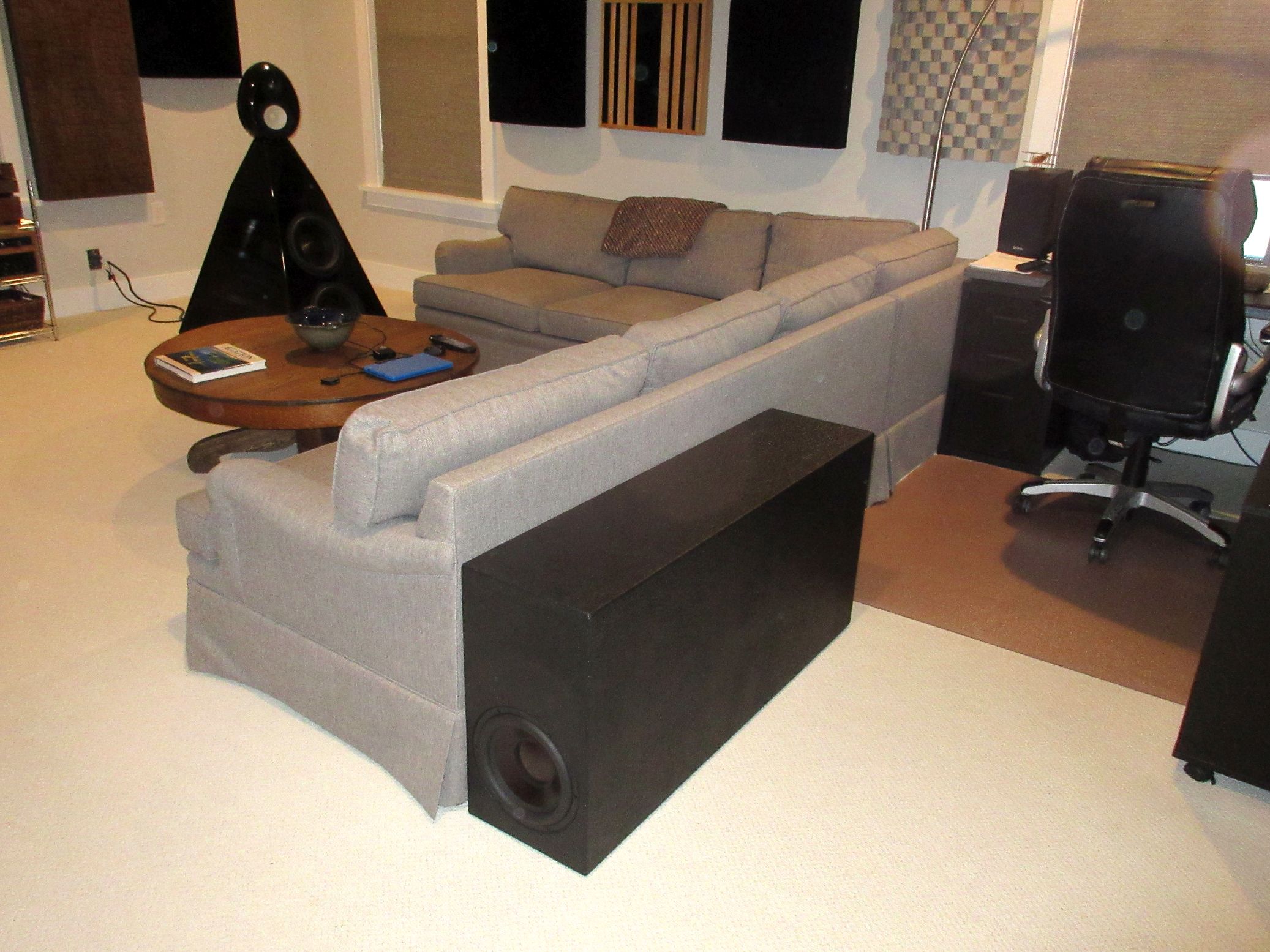

One recent project is the distributed subs I built to fill in the huge 40 Hz suck out I had at the prime listening position in my audio room. The article I wrote in in this month's issue of audioXpress.

Nice!
New room looks great!

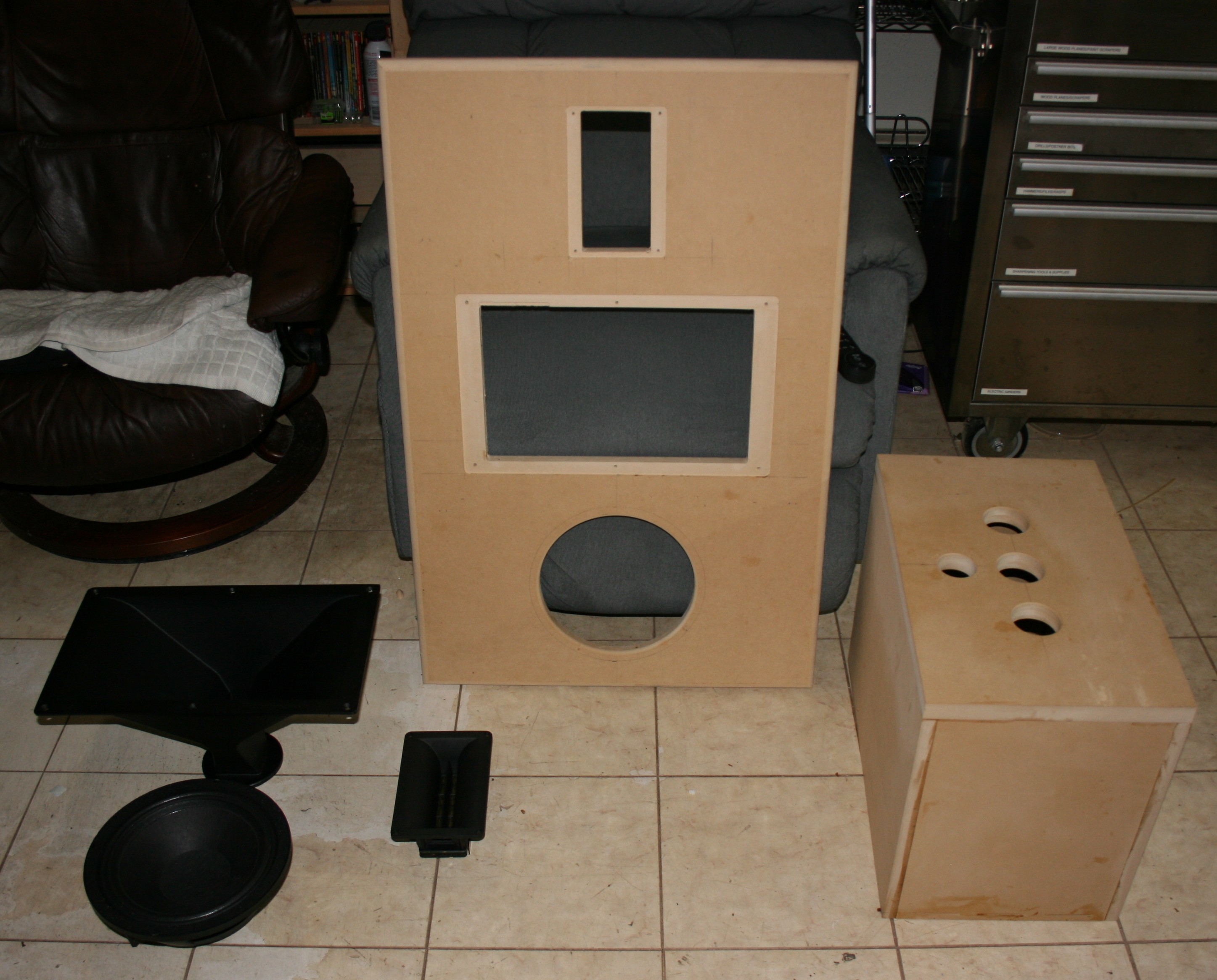

A work in progress:
Drivers are:
Tweeter - Dayton PHT1-6 Planar Horn Tweeter 6 Ohm
Midrange - Horn: B&C ME75
Driver: Radian 850PB-8/16
Bass - B&C 10MBX64
I would crossover at 100 Hz to a subwoofer. The system will have a DSP crossover I don't know which one yet. For amplifiers I am currently debating whether to use Ice Power boards for an all digital amp or get an Emotiva A6 (6 channel) which is classic AB pure analog with a linear power supply. The box on the right is the back volume for the bass driver. It is supposedly tuned to keep the bass reasonably flat tp 100 Hz. I will use my boat anchor (Emotiva XPR2 which I had gotten for my previous Carver speakers) to drive the subwoofers.
