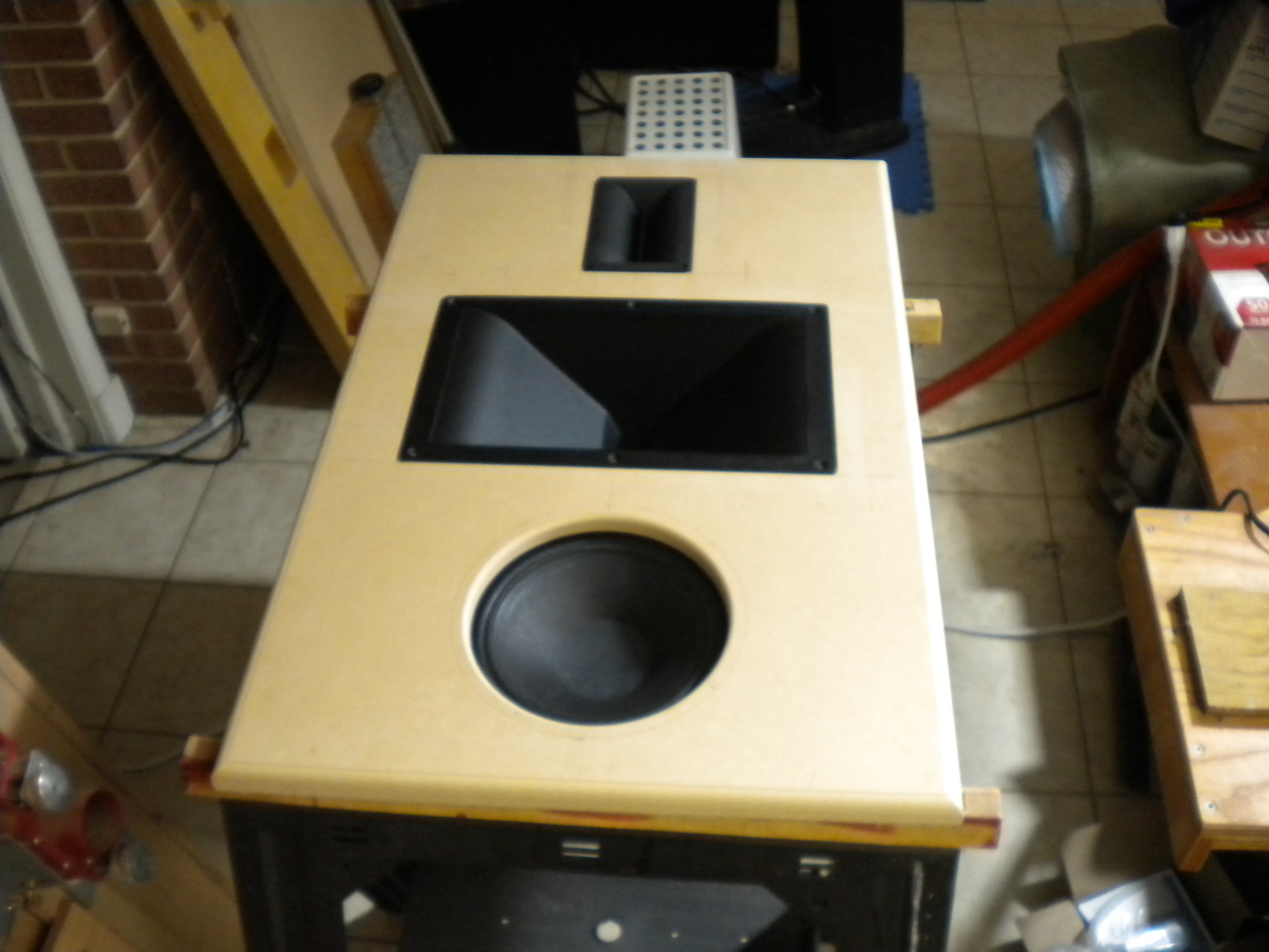

Speaker baffle construction so far. Per your comments I will build a box for the mid-bass driver I can bolt on to the back of the baffle sealing with a gasket. With regard to crossovers, in all my diy speaker systems the crossovers have all been electronic or dsp. In the early 70's my system had a home made electronic crossover using 741 op-amps. The power amplifiers were all Southwest Technical Product Kits. In this system I will use Ice power amps, Camilla dsp software, and a Essence STX II 7.1 sound card. Too bad the Essence STX II 7.1 sound card have become as rare as hen's teeth. I would like to get another one.
Horns + Solid-state electronics = PAIN! The more SS electronics in the signal path plus the extra interconnects (interconnects is another pain-in-the ass much less a pain in the ears with the wrong choices) the worst it gets.
