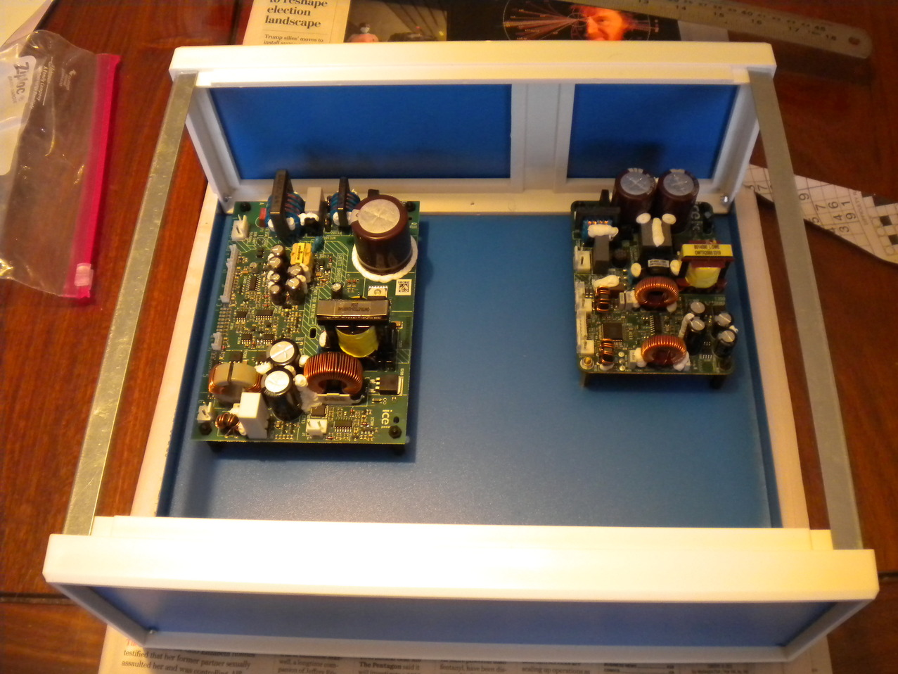

Amplifier boards in cabinet. Small board is stereo 50W per channel. Large board is mono 200W. Both boards have built in power supplies (120/240 VAC input) -

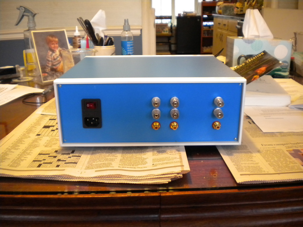

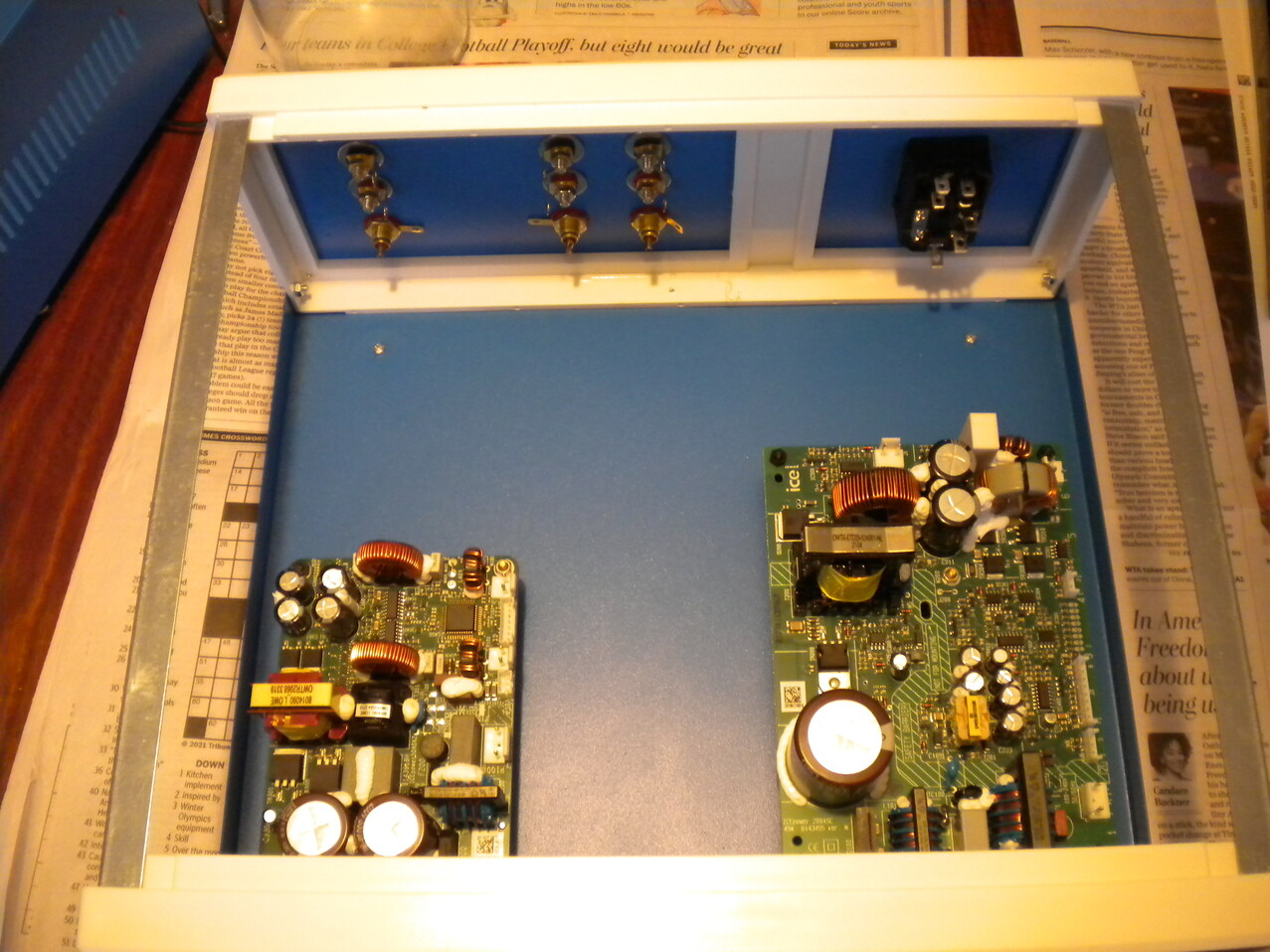

Some progress. Now it is on to laying out the buffer circuit board.
