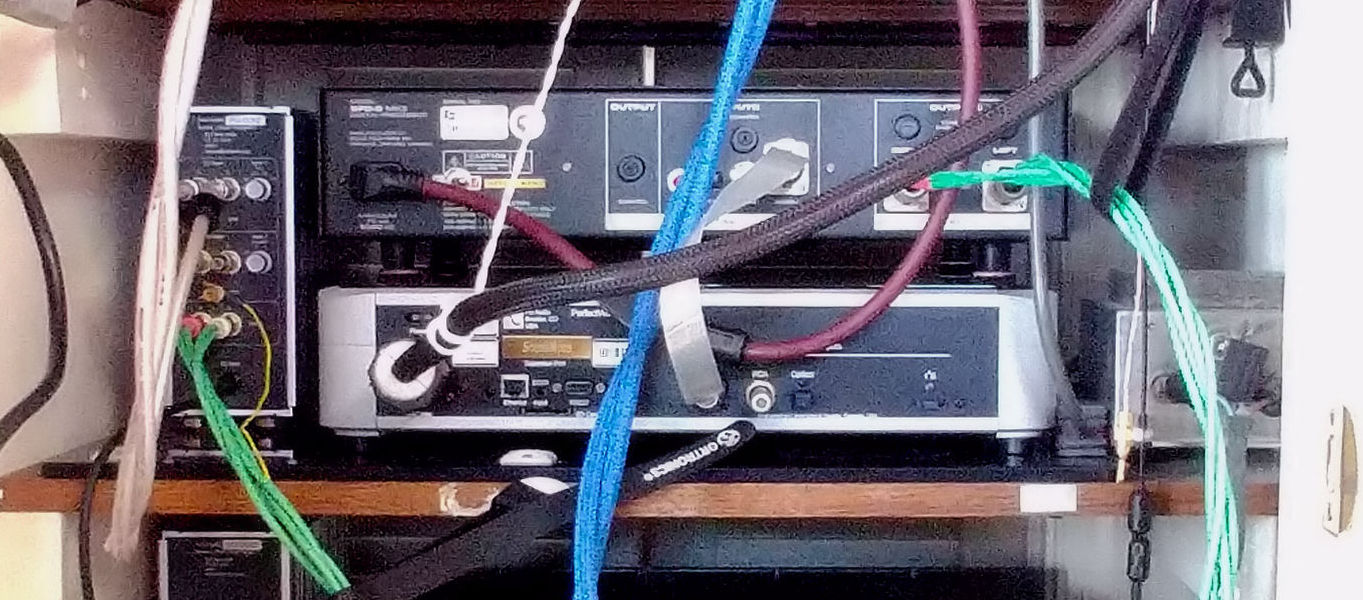

Since the AES/EBU standard was created to enable studios to use balanced-line microphone cable, just about any XLR interconnect can get the job done -- some better than others.
I found that ribbon cable terminated with XLR connectors really stays out of the way and enables the DAC to strut its stuff. I attached the only photo I have for an example.

I understood that you want to use a 110 ohm cable so I specifically went for an AES/EBU. At such short lengths perhaps it doesn't matter. But the Mogami Gold is often mentioned as a good cable for digital. I have no plans to buy an MIT. ;-) The always-reliable Blue Jeans sells two types for a very affordable price. I like their coax cable a lot.

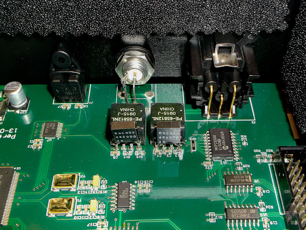

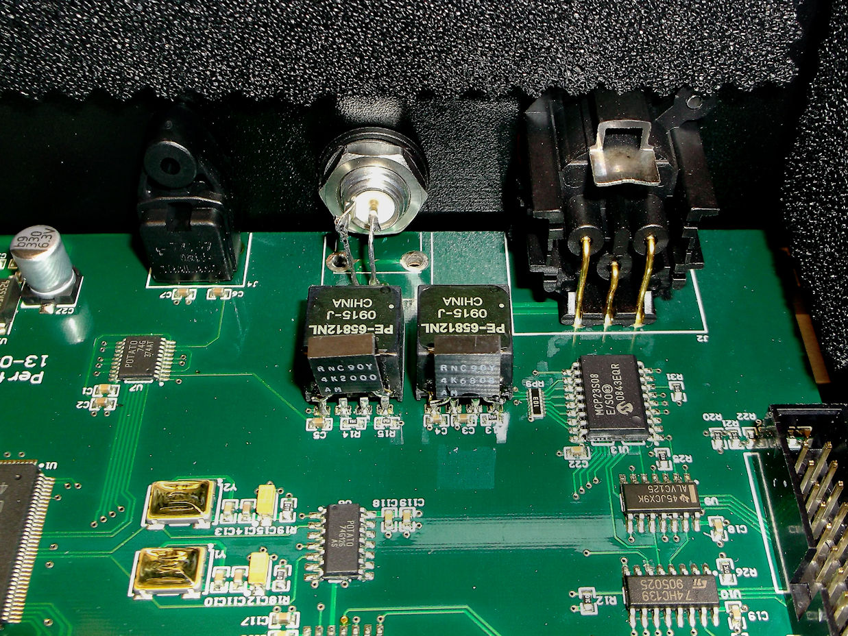

What's wrong with pulse transformers, besides the fact that the industry doesn't want to pay any more than they would for a resistor in the same spot, thus leading to crap performance?

Pulse transformers ring like any other transformer. Designers wiling to spend the extra money and time will make the source active with a differential emitter follower circuit or high performance op-amps. The receive end has only to have the proper termination. I've been having unexpected success with damping pulse transformers. The improvement in sound quality has not been subtle -- just cleaner and more open. Attached is a photo showing "dampers" added to the primaries. The secondaries were taken care of on the foil side of the board. The value is not really critical -- say 2K to around 4K -- but the resistors should have very low self inductance. Vishay bulk-film resistors have a self-inductance in the uH range at 100-kHz. I have also used Anstrom glass hermetic resistors to good effect.
