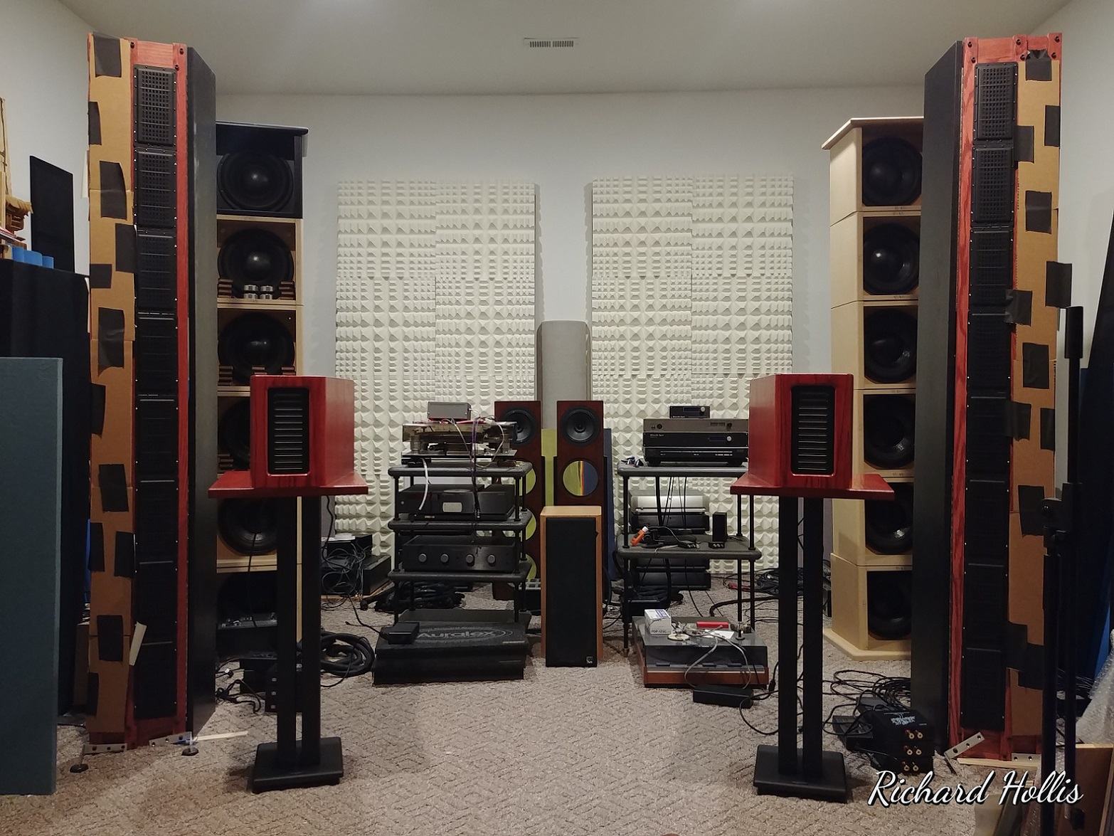

The latest in the open baffle planar speaker design trials.
This is a single planar in an open L style baffle that covers 250Hz to 20KHz response to match up with the 12in open baffle servo subs. The specs for the driver are 20 ohm impedance with 103dB/1w/1m sensitivity. Response is very good with EQ and crossover. Using the new prototype dspNexus 2x8 DSP crossover system as the entire front end with phono RIAA EQ via the ADC's and sounds excellent.
Using the Orchard Audio Starkrimson GaN based Class D monoblocks with 18in of speaker cable to the planars for direct drive. The amp gain is matched to the requirements of the planar driver.
Time for some listening.

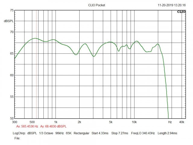

An early on axis frequency measurement of the Magnetar in the 3D printed open baffle before the final design in the earlier picture.

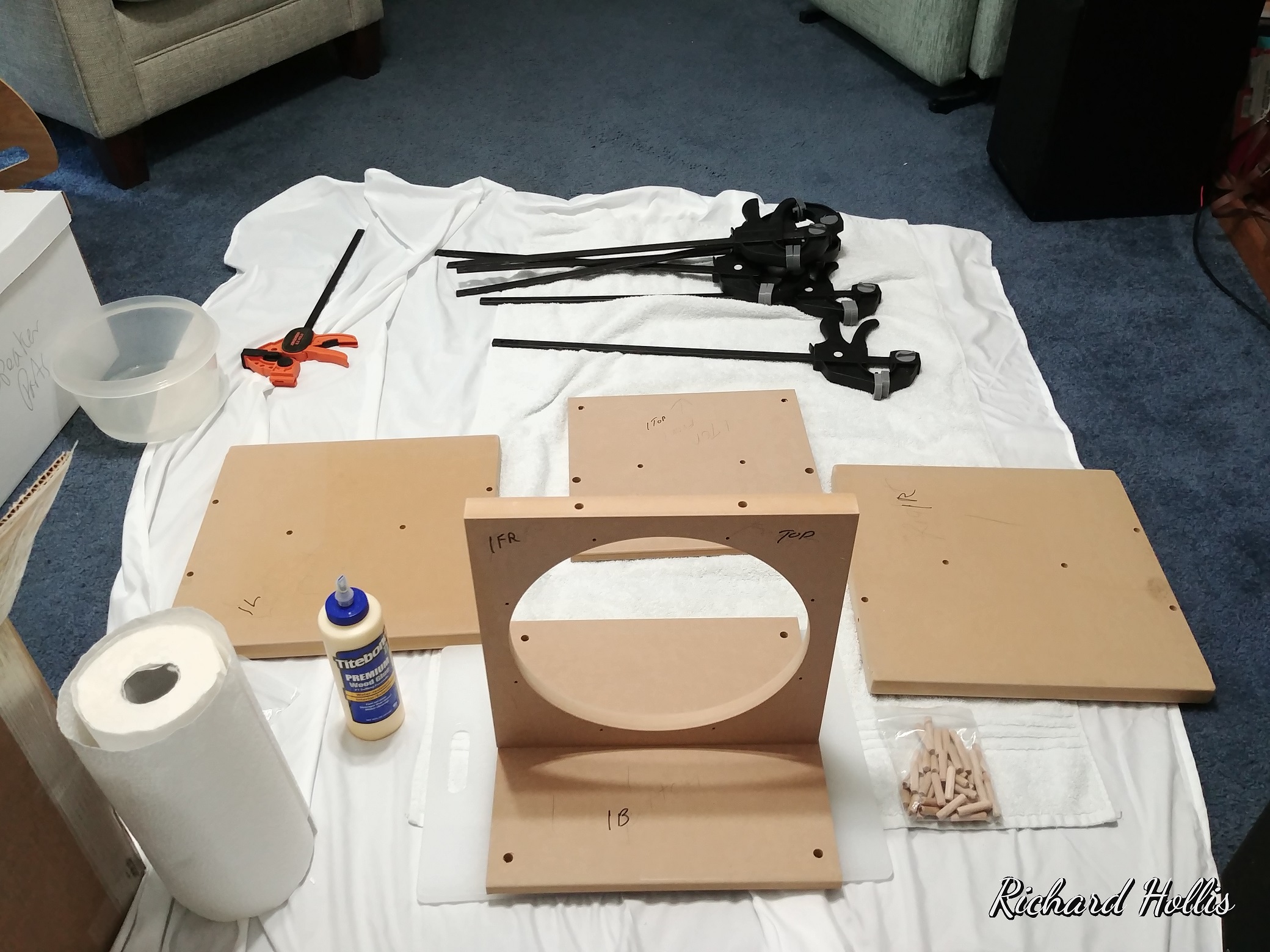

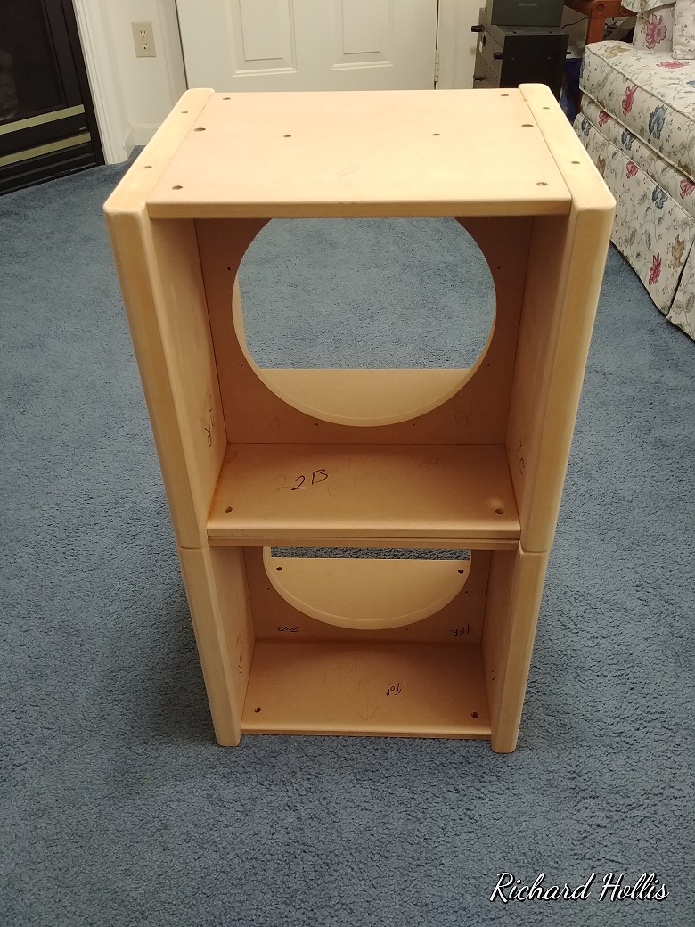

Also built some new open baffle H-Frame servo sub modules to go with the Magentar speakers. This lets me update the two 2x12 modules to 3x12 modules once these are painted.
These are flat pack kits from Reference North Audio that comes with dowels and bolts to build. You just need glue and clamps and I can do that.
