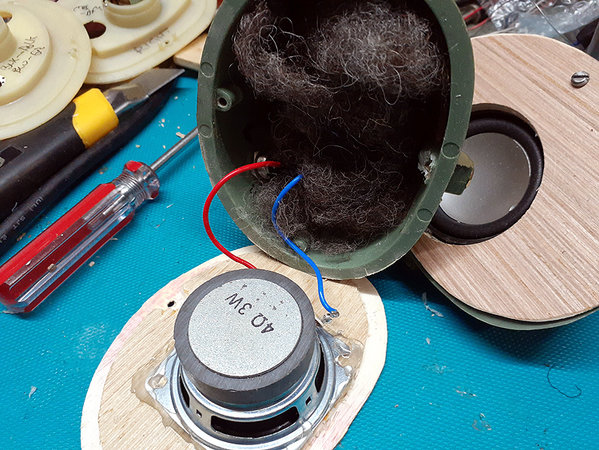

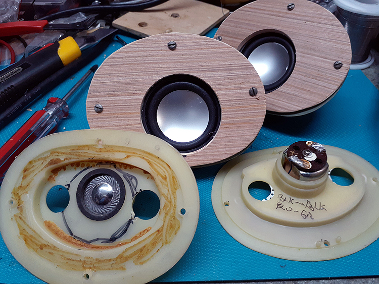

The drivers in the foreground are the originals just behind them are the new ones mounted in 1/4 inch ply baffle boards
the 1/8 deep 1/4 inch wide rabbit around the edge so it would fit into the original cup was an interesting exercise in not getting my fingers ripped off at the router table.

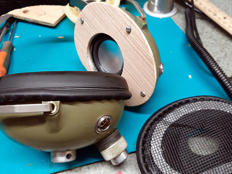

I got new cushions from Koss ($5 including shipping). These are for Koss P4 aaa's but I could muscle them on
How do they sound? Well much better than the originals. Highs and upper mid-range are MIA even though Amazon's description said the freq response was 20hz to 20khz. But I did answer the question of how to waste a few bucks and hours.
