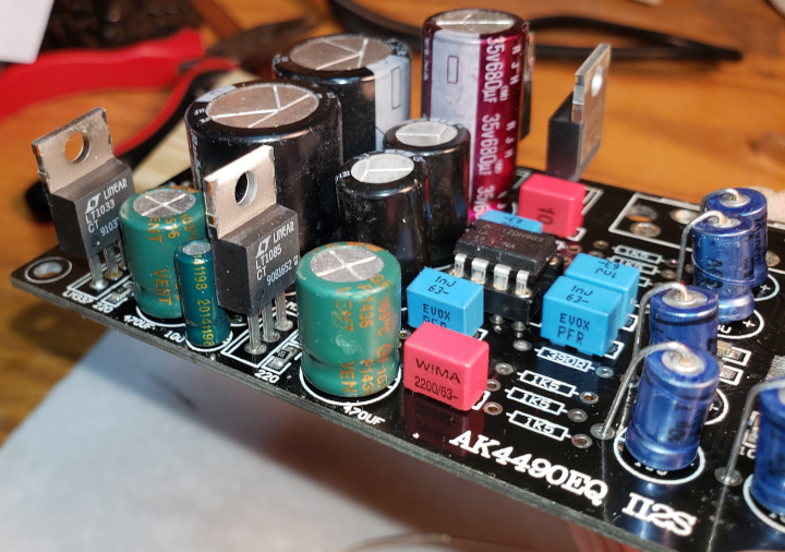

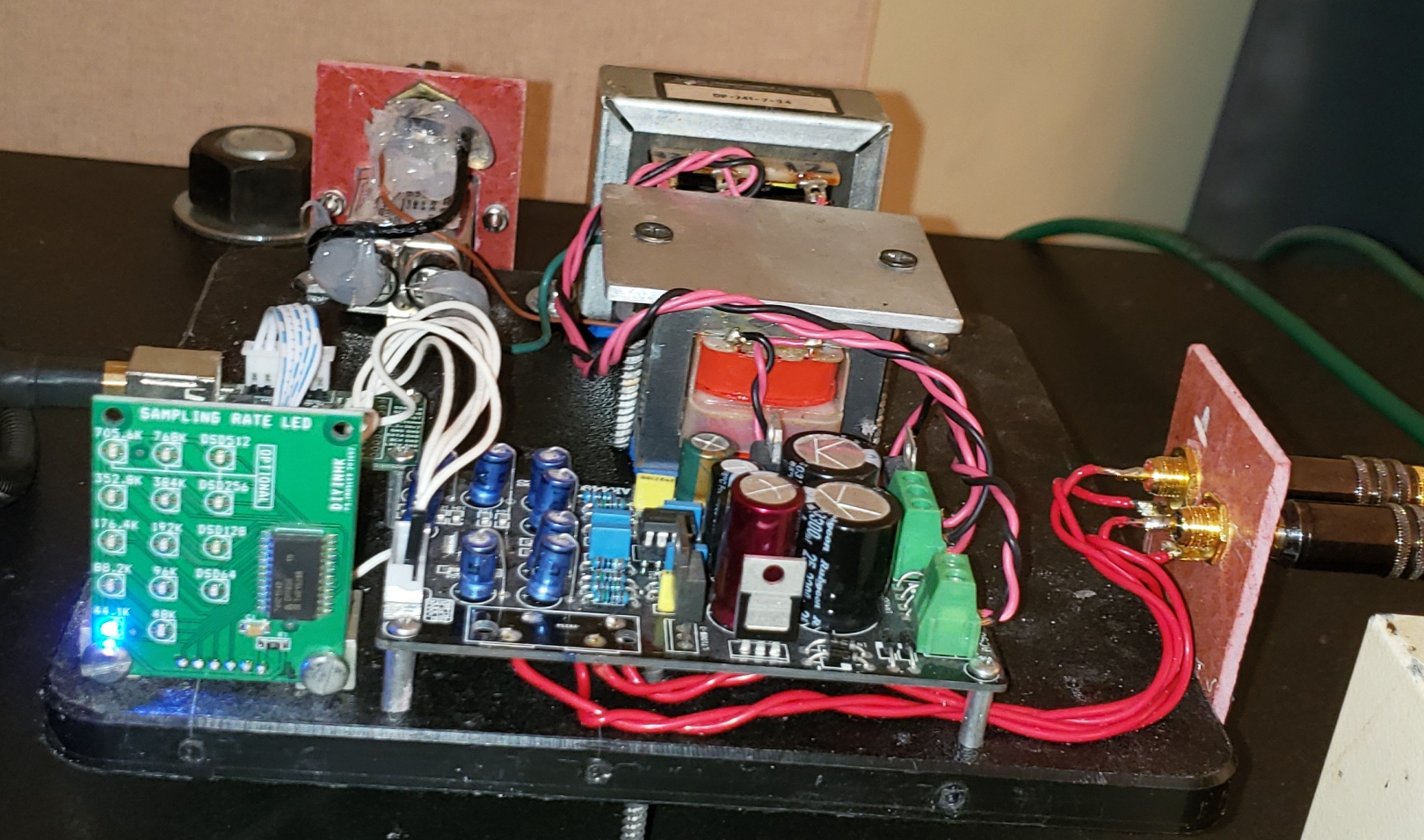

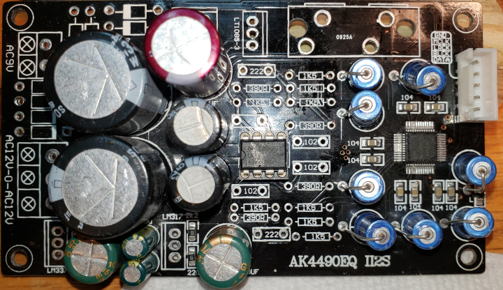

Well, at least we hope it's an upgrade. Several years ago, while recovering from shoulder surgery and using whatever was on the shelf, I cobbled up a DAC using the DIYINHK AK4490 board, XMOS I2S USB converter and a sample rate board. No driver needed for Linux or Apple machines. Sounded pretty good, several club members have heard it.
Since the initial build, and with the use of two hands, made a couple of minor upgrades. Changing the original AD827JN chip, which many feared was fake because of the cheap board price, to an LME49720 chip from Tom P. resulted in no audible (to me) improvement. Later, the on-board el-cheapo RCAs were removed and okay quality jacks mounted on an external plate. At the same time, a Corcom line filter was added and things tidied up a bit. Put the "chassis" which is a 1/2" thick piece of plastic on spikes. Noticeable improvement in sound.
Fast forward a few years and I'm gonna try a tube output stage for the DAC. Not sure if it will be an improvement, but figured I'd give the op-amp (DC coupled) version a fair shake by improving components to the extent practical, given the tight board. To that end, the AC terminal strips were removed (for physical space), diodes replaced with Shottkys. Original 3-pin regulators: LM317, LM337, LT1085-3.3 and LT1085-5 were each replaced. The LT1085s were assumed to be fakes again, but if they were real, it was a wasted effort. The LM317 was replaced with an LM1085, and the LM337 with a LT1033. Caps were replaced with real film and foil (2.2nF) and metalized (1nF) polypropylene caps, about twice the physical size of the originals. Resistors will be 1/4 watt PRPs once they arrive from Parts Connexion. The output jacks will be upgraded again and the wires feeding them will be Cardas 17.5. Also, the regulator output electrolytics will get film bypasses.
The whole mess will go into a little plastic instrument case with a 1/2" plastic plate under the DAC and I2S boards.
Hopefully, after the holidays, this will be complete. If any sonic improvement is heard here, I'll be anxious to find a Covid-Fear-Free home to listen with others and compare to a known good DAC.
Will post updates as I toddle along!

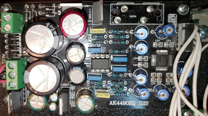

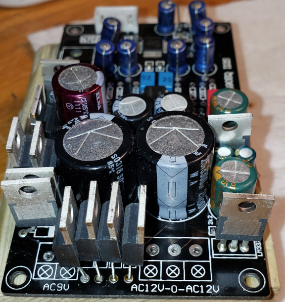

New components
