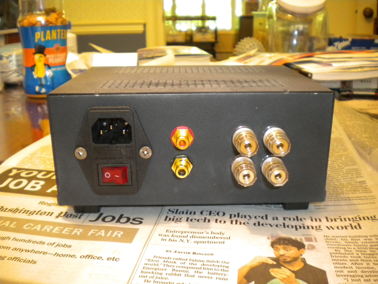

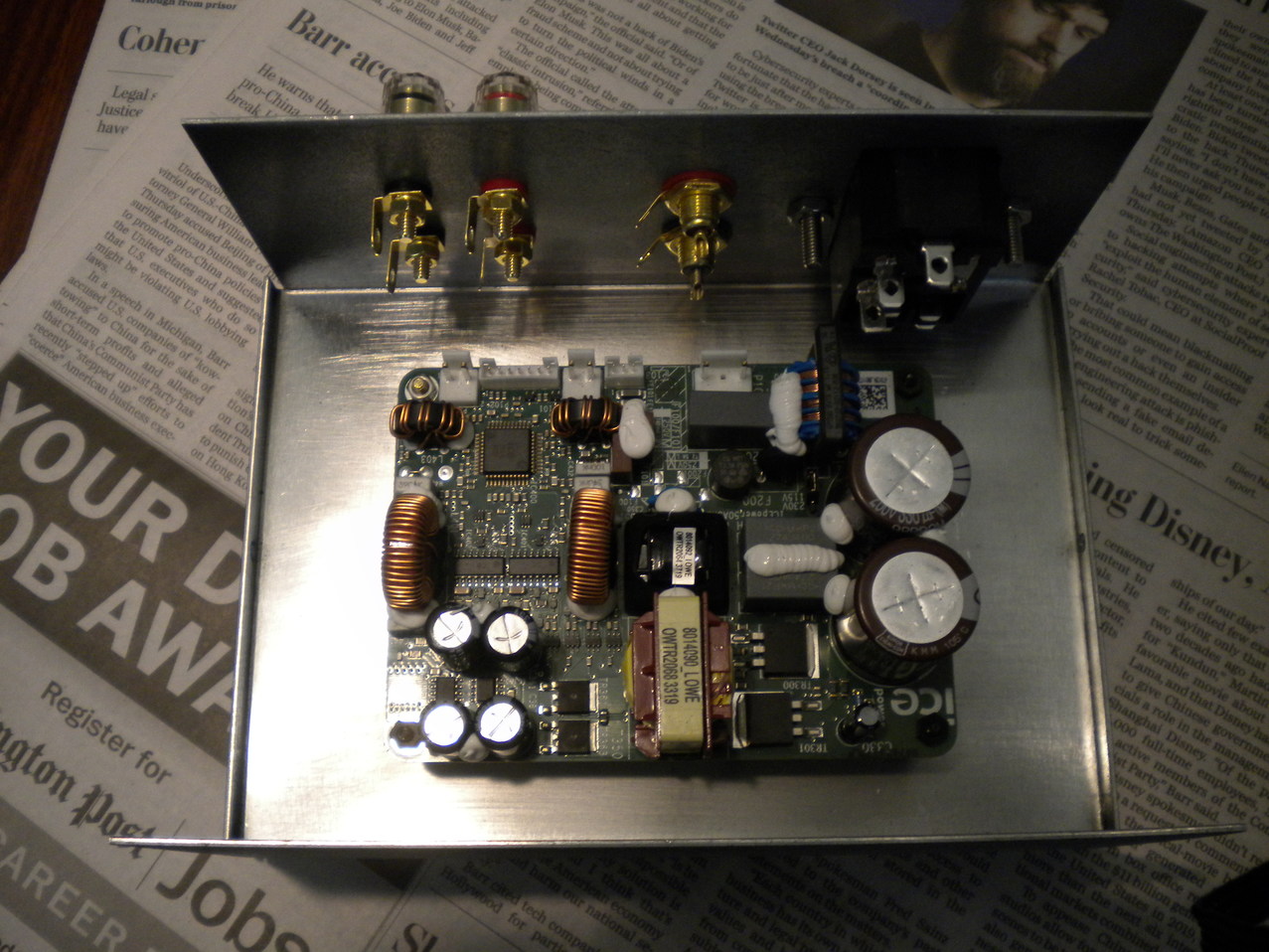

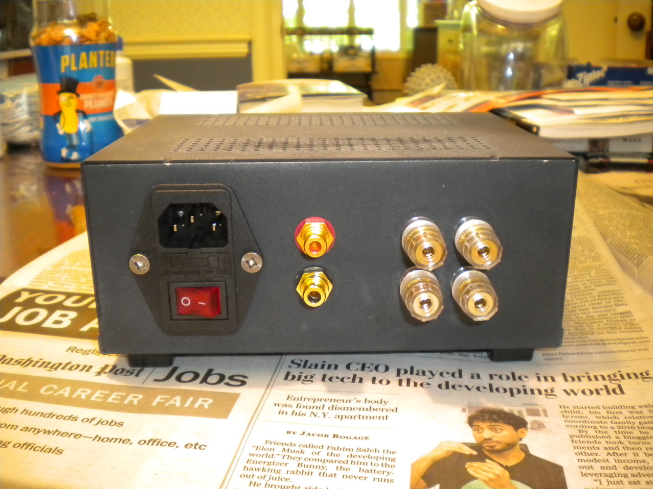

I am building a 50W/ch stereo ice power amplifier (ICEpower 50ASX2SE Class D Audio Amplifier with Power Supply Module 2 x 50W) -
I have the wiring harnesses and will do that next. Note that when wiring the AC line in you need to have the jumper on the circuit board in the 120V position and when wiring the AC line note that for the European (IEC) color code (wiring harness) brown is hot and blue is neutral. Since I am thinking of using the ice modules in a tri-amplified speaker it will be very interesting to measure the DC offset on the power outputs
