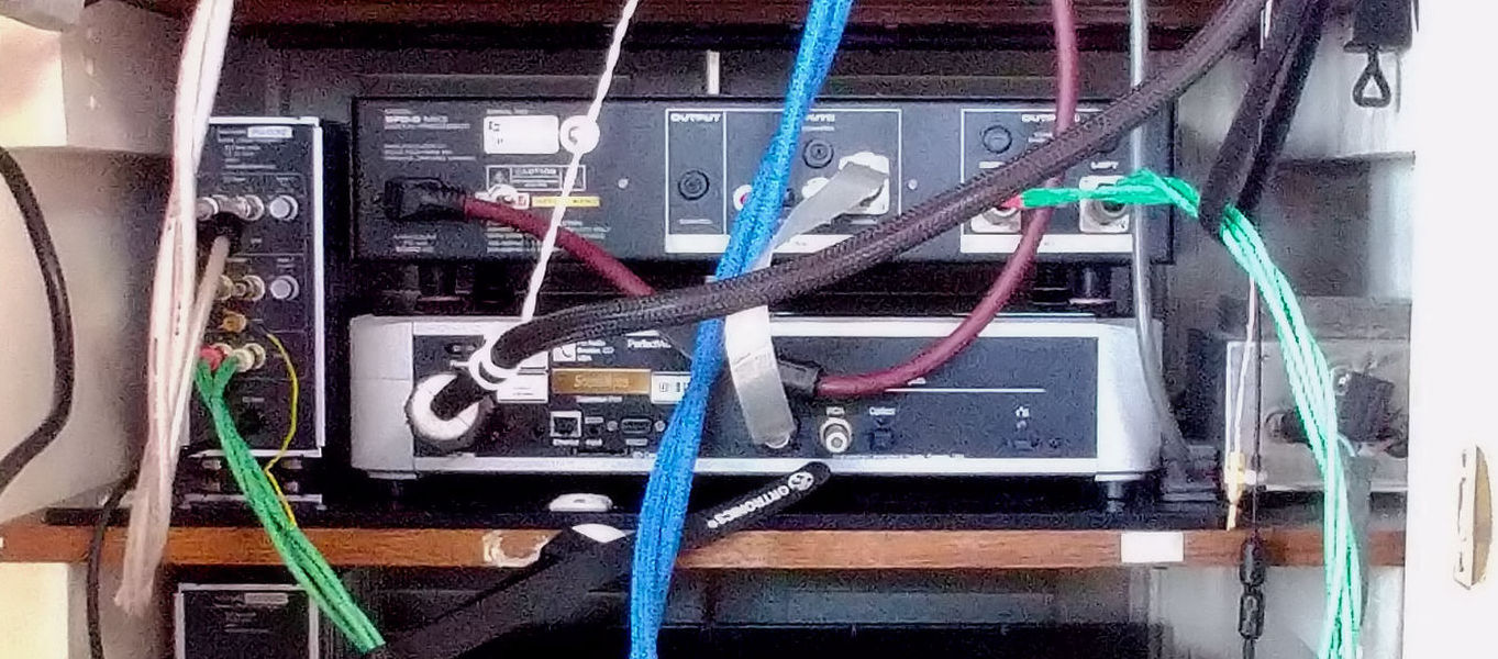

Since the AES/EBU standard was created to enable studios to use balanced-line microphone cable, just about any XLR interconnect can get the job done -- some better than others.
I found that ribbon cable terminated with XLR connectors really stays out of the way and enables the DAC to strut its stuff. I attached the only photo I have for an example.

I understood that you want to use a 110 ohm cable so I specifically went for an AES/EBU. At such short lengths perhaps it doesn't matter. But the Mogami Gold is often mentioned as a good cable for digital. I have no plans to buy an MIT. ;-) The always-reliable Blue Jeans sells two types for a very affordable price. I like their coax cable a lot.
