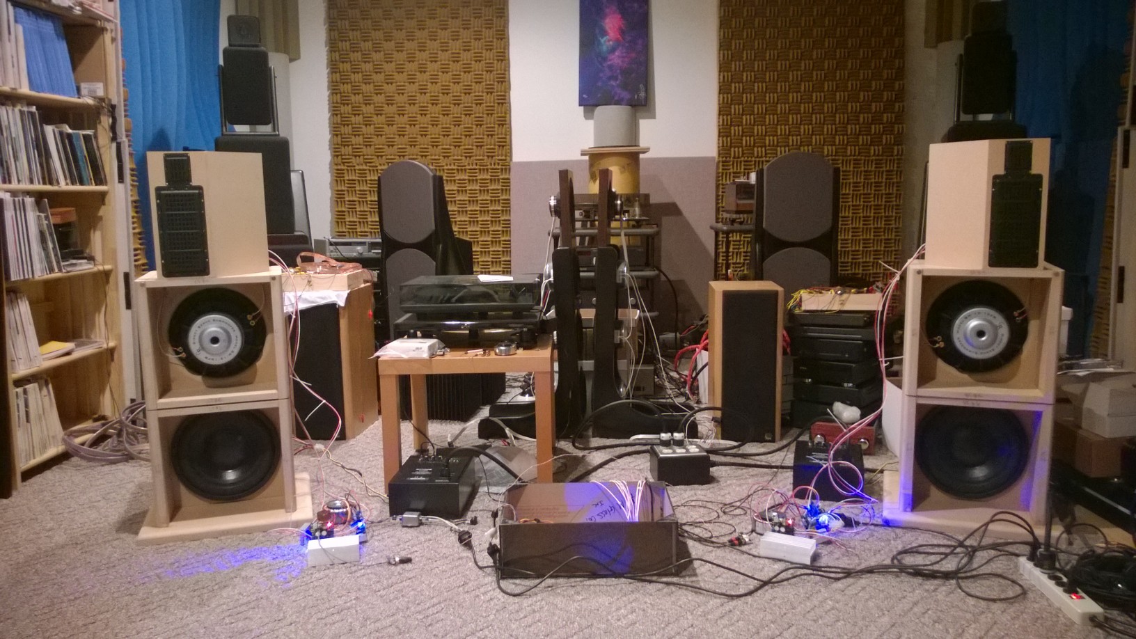

Here are my DIY OB planar hybrid speakers.
The OB planar section are a BG NEO3 tweeter and NEO10 midrange in a sidewing style open baffle. The design was inspired by some work done by GR-Research in OB planar speakers.
The bottom is a 2x12 open baffle H-Frame with two 12" GR-Research servo drivers with the Rythmik Audio HX800 amps. This is a section of a larger 6x12 open baffle H-Frame servo sub array I have been working on.
The system is run with the HAL MS-3 Music Server driving a Danville Signal dspMusik 2x8 digital crossover. Did measurements with Audiomatica CLIOwin and Room EQ Wizard for the system integration.
Since BG was bought by Christy Digital no more planar drivers are available, so turned into a one of a kind speaker system. Sounds really good in my setup for a full digital replay system. It does have A/D inputs for analog sources like my turntable system.
Attached is a picture of my room with the speakers and digital crossover prototype setup.

A question about your subwoofer to OB crossover point. In general, doesn't one keep subs to under 80Hz or so? Can the H-frame baffle subs perform well above this? [Maybe because of the servo, they sound good enough to use to a couple hundred Hz? Doesn't the Neo10 lose usable output below about 250Hz?
On paper, it would seem that there is an issue. How did that work out.
BTW, I'm very interested in your crossover and measurement knowledge, if you're willing to share it.
REW and a Dayton calibrated USB mike are in my tool bag, but not much in the way of experience....
Stuart,
The subs are with the main drivers, so no problem running them up higher in frequency to crossover to the NEO10. The servo subs go up pretty high at -6dB to crossover to the NEO10 without any issue. There is no localization issue with the subs and mains being separated. I do time align the subs to the main baffle with the digital crossover.
Since you are working with line array's, the measurement process has to be modified to take into account the line array length. The farfield measurement distance should not be closer than the vertical length of the array. REW use to offer gated time measurements to do the individual measurements needed to design the crossover. You need frequency response measurements for each of the driver arrays and the subs individually to design the crossover. Also only measure one channel at a time.
Be careful to start with the volume low for the measurements as to not blow drivers by mistake. I have to be very careful since the BG drivers are no longer produced and hard to get spares.
The drivers response is heavily influenced by the baffle design, so the response plots on the drivers from the mfg are just a starting point.
If you do speaker measurements, I am sure folks will post insights into the crossover design needed.

I meant more of a sound quality issue, were the subs fast enough in transient response to keep up with the Neo10?
Allegedly, the line array of 6 Neo8s on my drawing board will reach about the same lows as your single Neo10, about 250-300Hz. My assumption was that a fast mid-bass driver is needed to bridge from a ~12" sub to at least that frequency. That's why I've included the Dayton RS180-4 in an array of four from ~60Hz to 1kHz, where power handling of the Neo array is improved, and presumably distortion.
Is that not needed with the right (servo?) sub arrangement?
As to individual measurements, in the baffle, should these be preformed outdoors, to avoid room effects? I better read up on "gated time measurements" since I am clueless.....
Thanks again!

The 2x12" servo subs easily keep up with the BG NEO10 planars. They blend well for sound quality. These can work up to 250Hz at the -6dB point to crossover to the NEO10's. I have heard 3x12" servo arrays with larger line arrays and they are about the best low frequency reproduction I have experienced besides the original Infinity IRS Reference III's with the 6x12" servo arrays.
The servo corrects the response of the 12" driver to stop it after the signal stops. The servo sense coil is wound with the drive coil for very little response lag.
The gated time measurements allow you to make in room farfield measurements to minimize the effect of the room. Outside is better for low frequencies, but hard to do with large speakers. If you can keep the room reflections within the first 4-5mSec out of the measurement, it will be good down to 1/T = 200-250Hz. If you need to crossover lower, then measurements outside will work correctly as long as the distance from surfaces is far enough.
Another technique called ground plane measurements can work as well for low frequencies.
