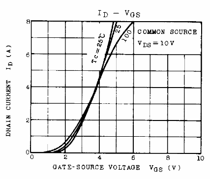

If you consider a single device with, apparently, multiple MOSFETs on a single die bonded to a copper base - it seems that the individual transistors within the device would reach a current sharing equilibrium quickly. If they did not I'm not sure power MOSFETs would be a viable thing at all. Temperature differences between the individual transistors has to be at least pretty close given their proximity and the copper they are bonded to. Certainly no where near the 155-165 degree differences shown on the transconductance curves in the App Note.
When you consider using multiple devices in parallel it's pretty much the same thing. Though here you need to match the devices and use ballasting resistors to help them share the load, which we do. It seems to me the biggest difference between MOSFETs on a die and MOSFETs on a heat sink is the time it takes the temperature of one device to affect the others. We have found them to be stable and reliable as long as you don't short the wrong thing out with a scope or meter probe. Of course that won't happen unless you have the cover off and aren't being as careful as you should be.
Current production of power MOSFETs, at least that I'm aware of, are in fact designed for switching applications. The ones we used in the Mirror Image amps have low transconductance, about 2 S. They are Toshiba 2SK405 and 2SJ115. I've atached the transconductance curve graph for the 2SK405. We also used Hitachi 2SK414/2SJ119 initially, but their cost was considerably higher than the Toshibas. Neither has been made in years. You can find fakes on eBay, but they won't work well in an audio design. I purchased some a while back and took them to David's to see how they behave on his curve tracer. They behaved like something designed for switching. Recently I was lucky enough to find a stash of genuine Toshibas and purchased all of them.
I can't speak to David's feeling that bipolar would be a better choice than MOSFETs for an audio amplfier output. I do know that David and my old partner Ken are the two smartest guys I know when it comes to this sort of thing. Ken chose MOSFETs, I think they sound pretty darn good.
