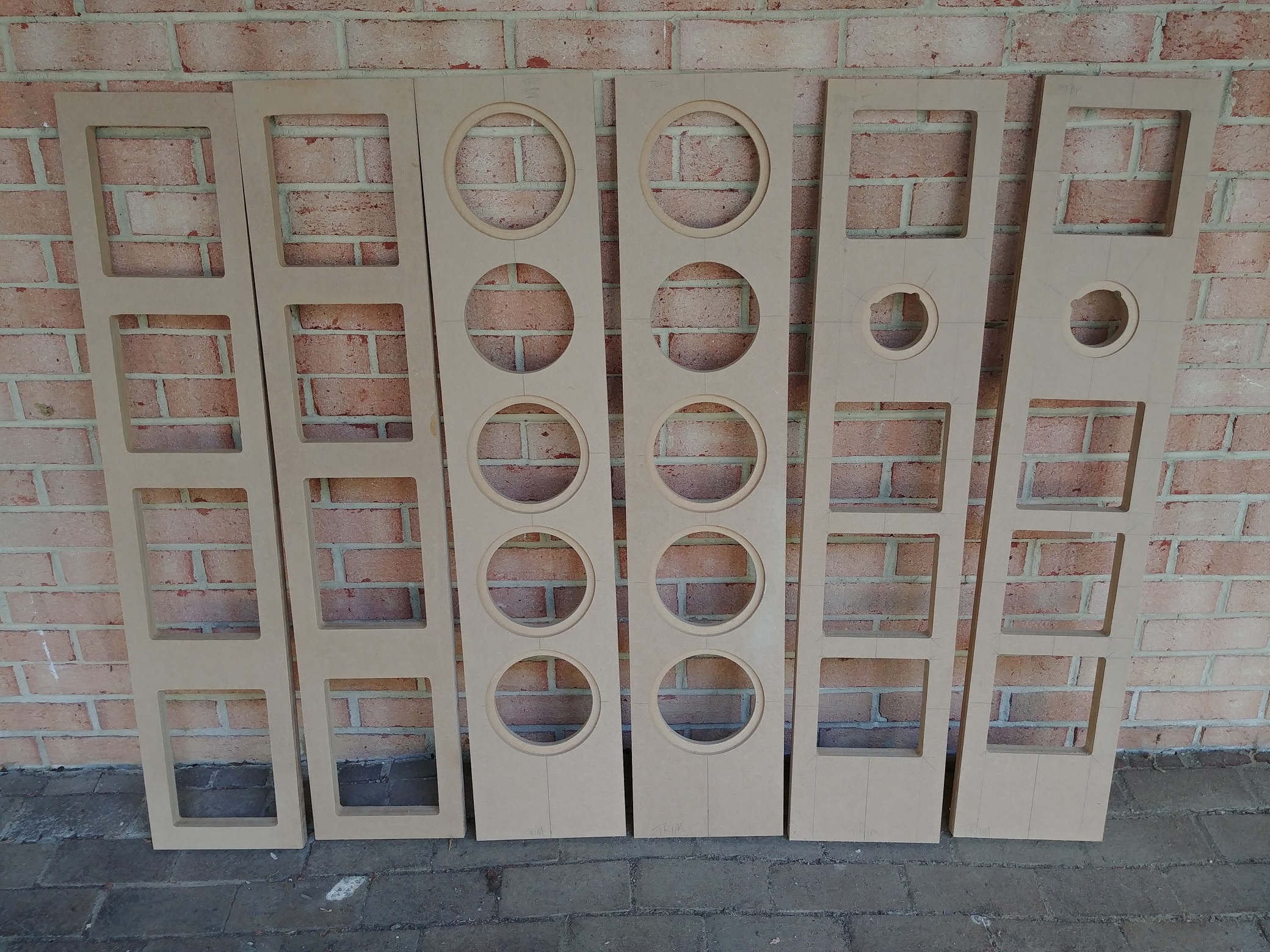

I have been working on the cabinets over the past couple of weeks, and have been making progress on cutting all the panels and routing out the holes. Having fun with my new Bosch 1/2" router (with fixed & plunge bases), as you can see in the attached. Had to make a template for the rectangular holes in the braces and used a Jasper Jig for the circular cuts. Hope to start assembling the cabinets in the next week or so.
Making the cabinets out of MDF, double layer 1/2" to get the 1" recommended thickness. I ended up making a very stiff torsion box press (i.e. veneer press) for gluing up 2'x4' sheets together maintaining a constant pressure across the entire surface. Based on my cuts, the glueline is tight throughout the entire panel, so successful effort. Actually, I am finding that making tooling to facilitate accurate cutting, routing, and clamping is taking about the almost as much time as working on the speakers. I have made, in addition to the press, an accurate crosscut sled and adjustable router template for the rectangular holes in the braces, as well as tuning up my Bosch contractor's saw.

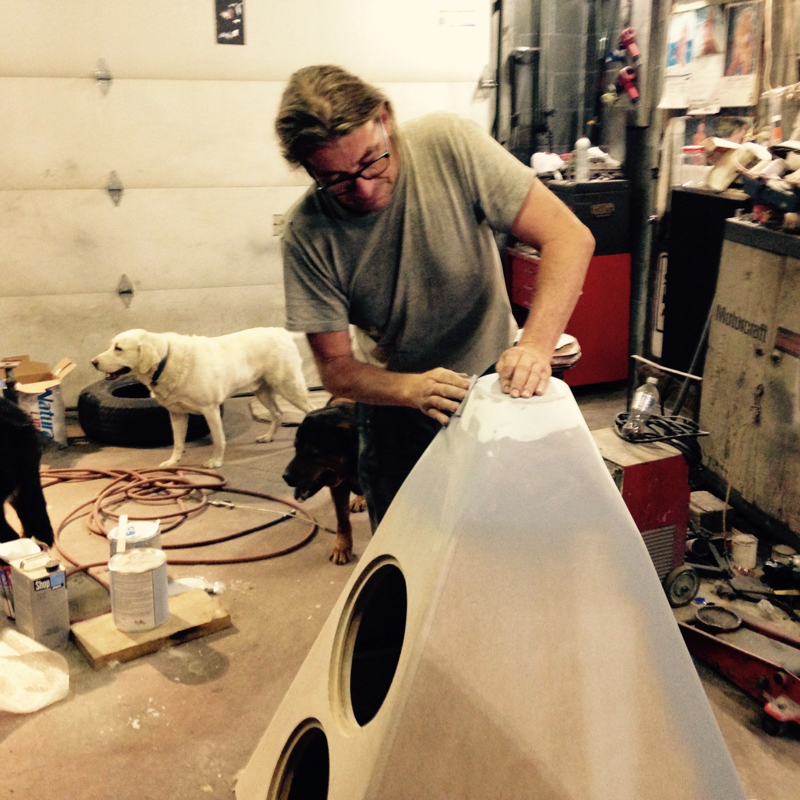

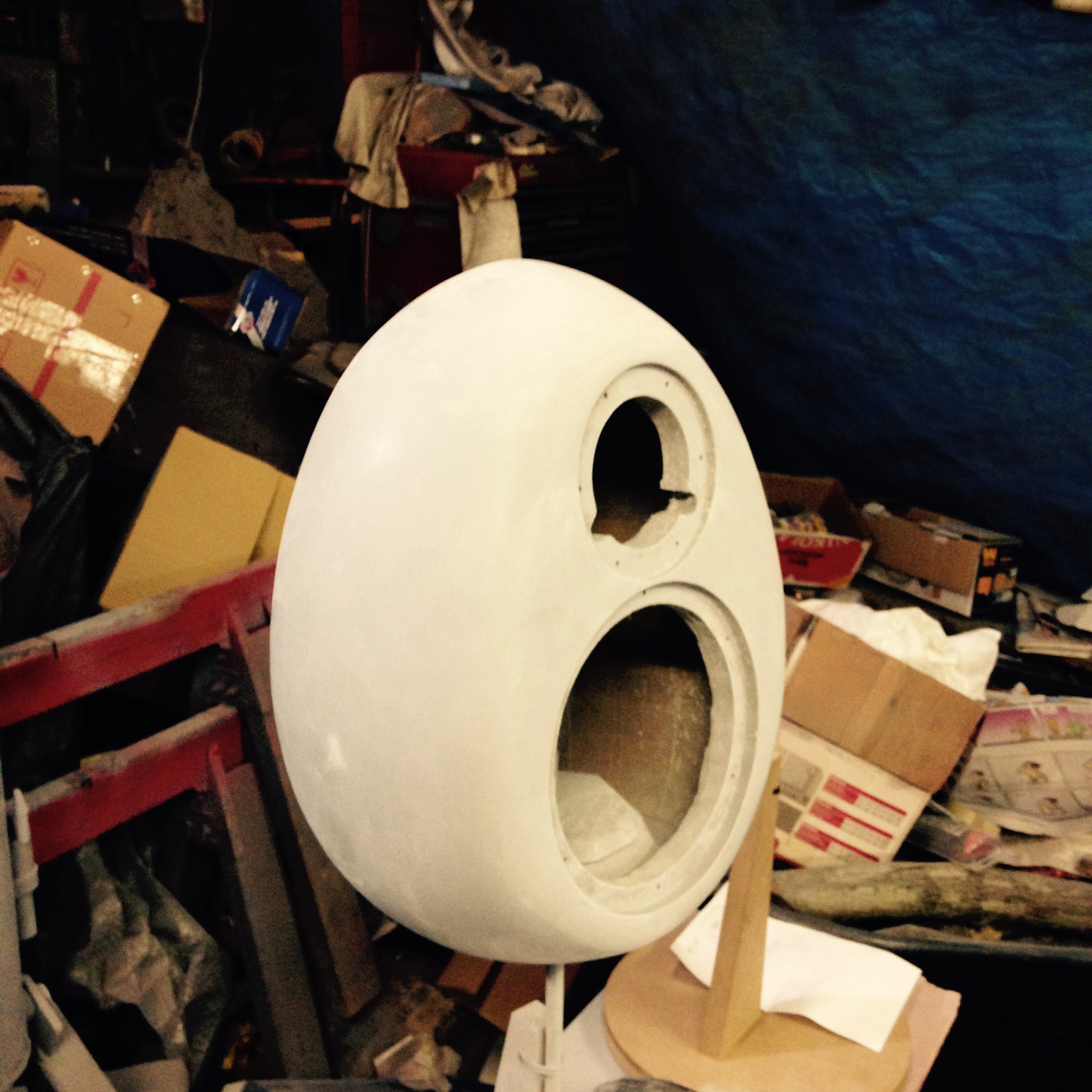

The person who painted the eggs with an automotive finish had never worked with MDF before. He discovered that due to the difference in hardness between the MDF and glue lines that no matter how much you sanded there were always ridges that would show because they did not sand at the same rates. He used a polyurethane material that they call "icing" in the trade to cover all the areas having different interfaces. Then he used primer, sanded, color coat, sanded and then several layers of clear coat with sanding in between. Here are two photo of Steve working with the icing at the top of the pyramid where the glue lines are showing and also the egg totally covered with icing. Note that the egg is sitting on top of one of the fixtures I made that allowed Steve to get to all sides by holding the egg in the air by means of the bottom hole that later housed the locating pin for mounting to the pyramid top.
