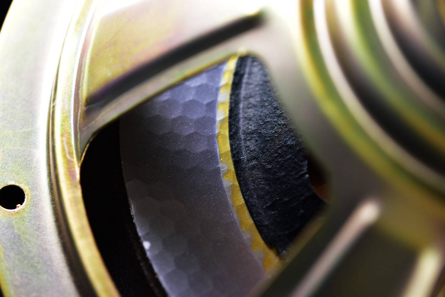

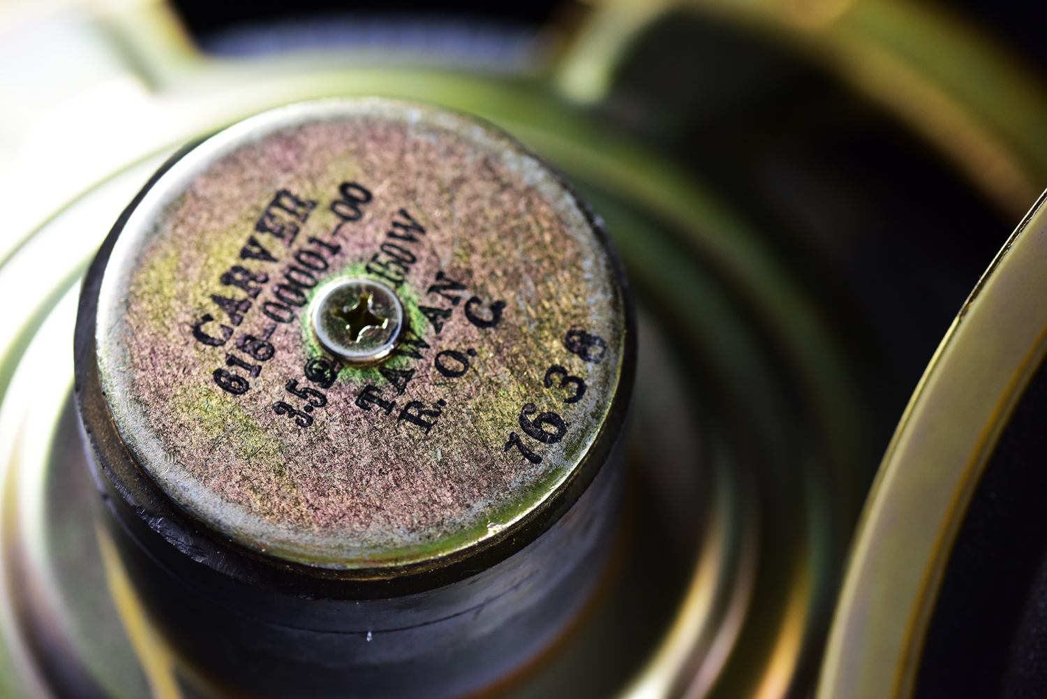

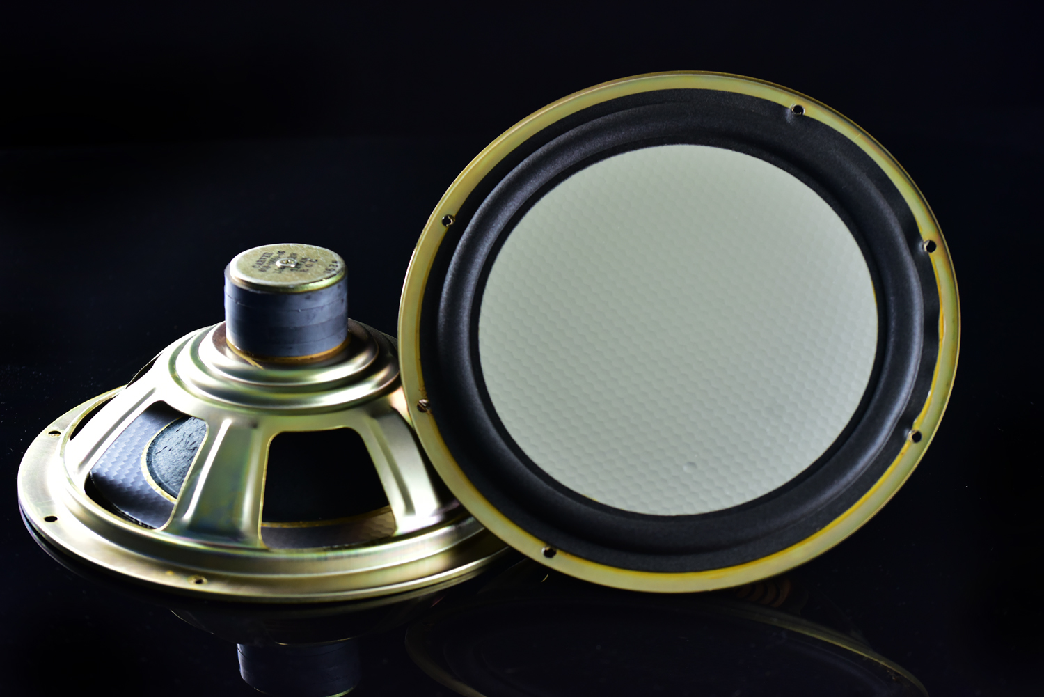

PostPosted: June 13th, 2019, 2:07 pm
this is what the Carvers look like I have eight
