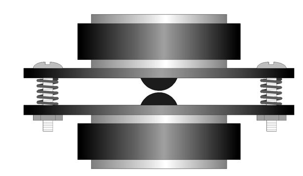

 Post subject: Re: naked OB speaker
PostPosted: May 29th, 2019, 4:06 pm
mix4fix wrote:
Could you use tweeter and midrange instead of a full-range driver?
2: Most tweeters have sealed backs, to you won't get the dipole radiation pattern you'd get with a full-range driver unless you mount a second tweeter pointed backwards and wired out of phase. You may want to pad the second tweeter down a bit as well.
Or
PostPosted: May 29th, 2019, 4:10 pm
That's not going to work.
