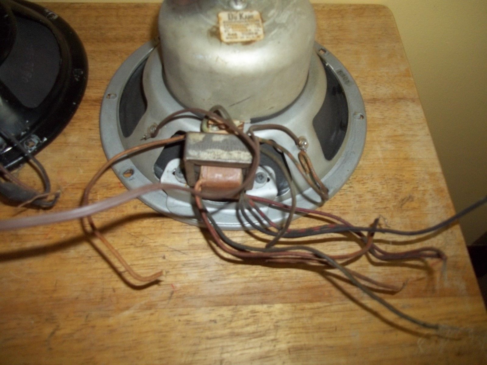

Anyone know that is the purpose of this transformer on a driver?

My project is horn loaded until 10kHz. 416's are for the bass (50/60Hz - 250Hz). Looking for a matching cone driver above it.
As I recall DuKane was big in public address systems and it's possible that's a step-down transformer to go from a 70-volt distribution system to the driver's impedance whatever that is.
PostPosted: January 14th, 2019, 3:42 pm
Posts: 1210
That solves the mystery. Thanks Walt.
PostPosted: January 14th, 2019, 4:45 pm
You're welcome!
