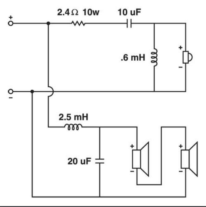

PostPosted: December 3rd, 2018, 2:43 pm
You have the schematic, just buy the parts if you must go passive.
5 parts per channel: one resistor, two inductors, two caps. Done.

3) This is the huge question for Steve (mix4fix). Please, it's not my intention to insult you, but something in your posts is bothering me: your questions about buying pre-made crossovers and trying to discern the crossover point of a filter in a schematic already designed for the speakers you have.
Can you read a schematic? If the answer is no, there is no shame in it. We are willing to help someone who wants to learn. I had several books I would have loaned to you, but sadly, I loaned them to another club member who failed to return them. In fact, he threw them away. So, if it is the case that you need some basic tutoring, I know there are lots of great member suggestions for written books and online educational sites. If you want to know.
If you would like a wiring diagram on how to assemble the recommended crossover on a small piece of 1/4" pressboard, I and I'm sure lots of others, would be willing to make and post a drawing.
