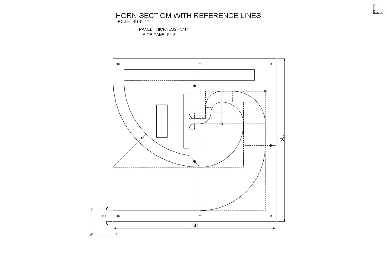

Hi All,
I have project I'm trying to realize. It's a horn built out of multiple sections of 3/4" plywood, each cut with a horn shaped profile in them.
The most efficient way to produce all the parts is with CNC.
I'm having a difficult time locating someone that someone that can do this work at a reasonable price.
Workpiece is 30" x 30"
Does anybody have connections with someone with CNC capability, that will entertain an "experimental" type project?

Also, would any of the other horn guys have any comments about whether there are any glaringly wrong problems with my horn profile?
The horn will accomodate a 10" woofer, and it will have a slotted trhoat about 1" by 7.5".
I'm assuming it will be a relatively long throw horn for pro audio use. I'm going to test it in my listening room, but I don't really have any intentions of keeping it there.

If you use 8 3/4" panels, it'll only be 6" wide, how does that work with a 10" driver or a 7.5" slot?

Personally I would use a jig saw for a prototype before I would go to the expense of CNC.
 Post subject: Re: CNC Speaker Design
PostPosted: December 13th, 2017, 12:11 pm
Suggestion. Print out drawing full size (printer software can print out full size on multiple sheets of paper with alignment marking). Glue printout to high density fiberboard. Cut out and use for template with jigsaw (cut off line) and sand to line (bench top oscillating sander best for this). Use hand router with guides to cut actual pattern in wood. I have all the wood working tools to loan to you if you can to come to Silver Spring to pick them up.

Depends.
Only one cross sectional view is shown . The horn flare could be expanding on all four sides which makes it extremely difficult.
