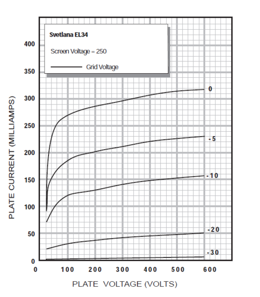

Mr. Wrong here,
But I'd always heard that regulating the screens, not B+ is adequate, since cathode current is dependent on screen voltage to a large degree. It is necessary to NOT regulate the bias supply if fixed bias is used (why is fixed bias adjustable??? Crazy terminology). As B+ changes vs. line voltage, so does unregulated bias voltage. The tracking of those two minimizes cathode current variations due to line voltage variation.
A look at a typical set of plate curves shows current variation vs B+ and vs G2 variation.
Hope this helps
