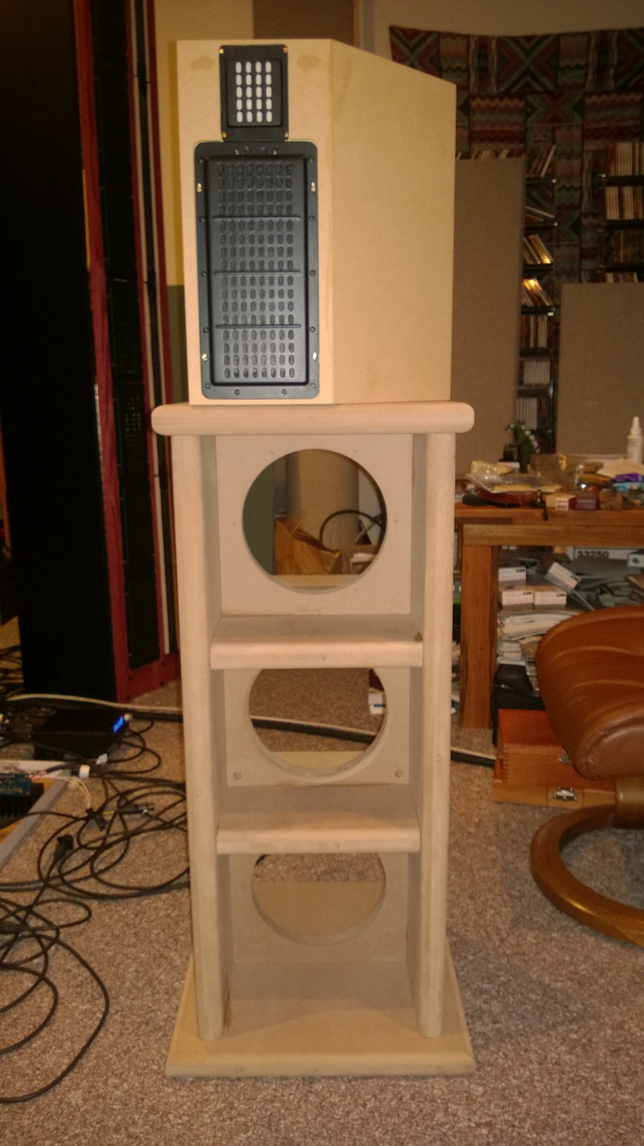

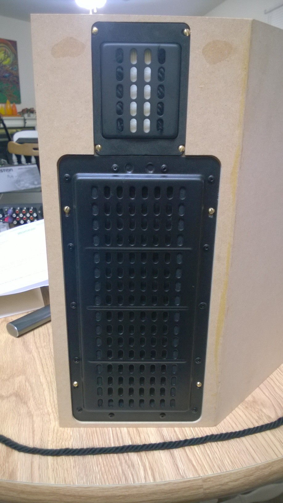

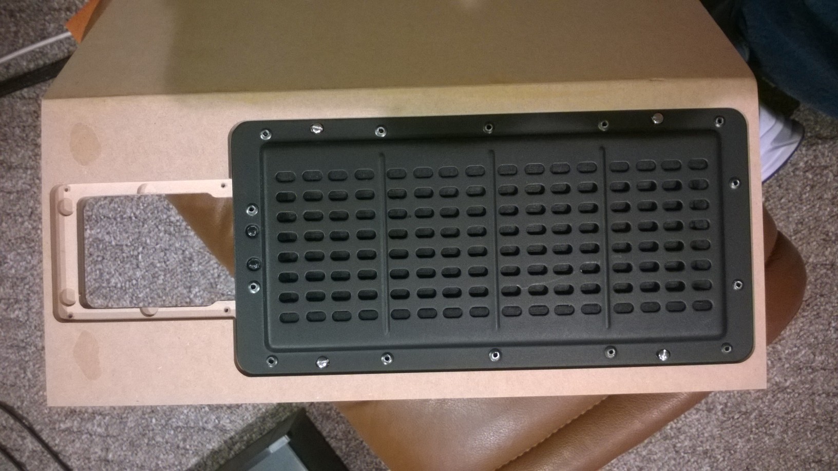

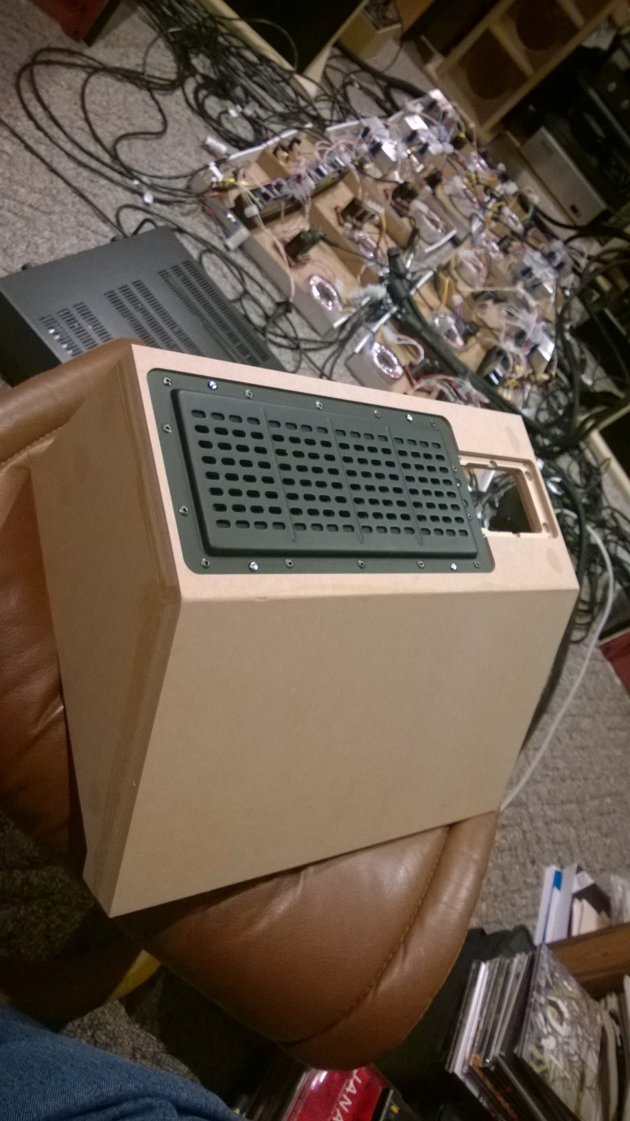

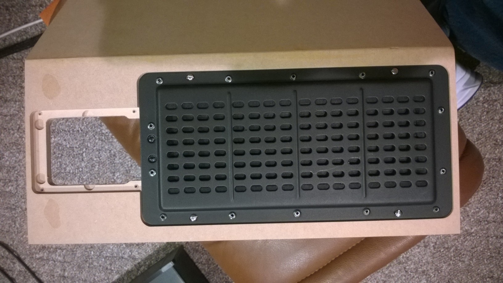

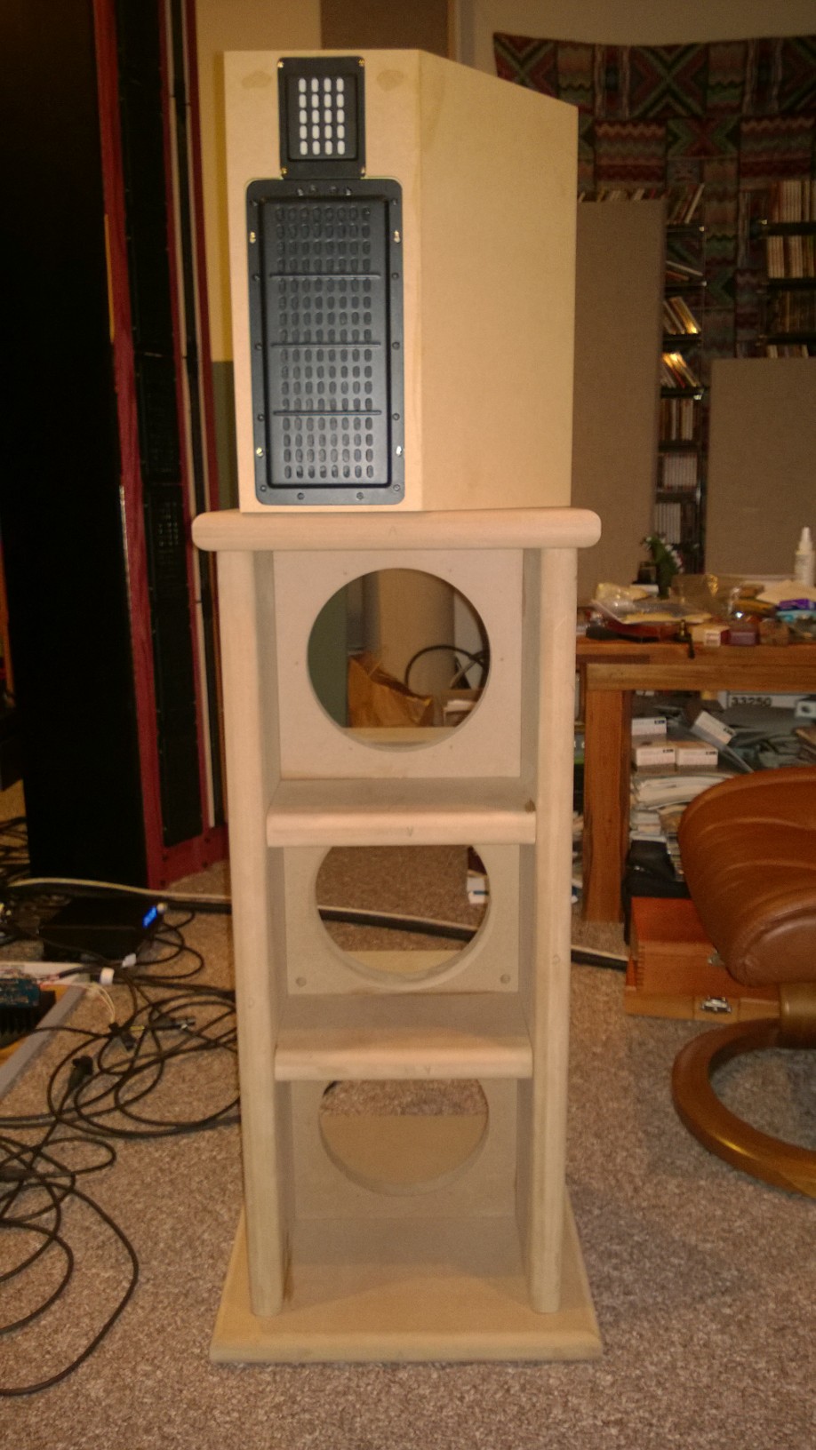

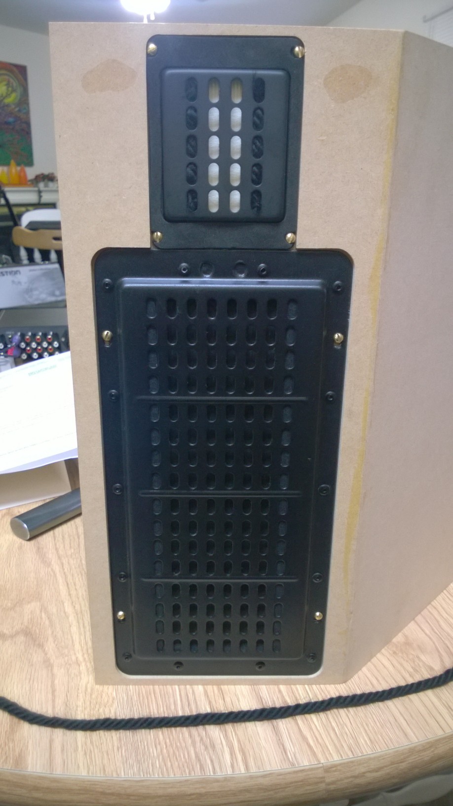

Here are some pictures of the small open baffle planar speaker with a 3x8" servo sub array as stands.
This is one of my test baffles for the planars. The GR Neo3 and BG Neo10 are going to be installed for testing. Since there are new and old production Neo3's and Neo10's trying both to see if they are the same. The tweeters will be different, but the mids should be the same.

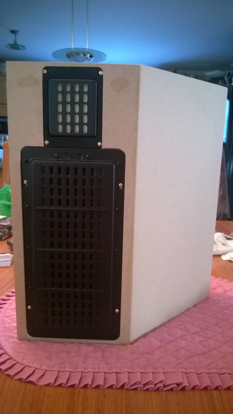

Posts: 943

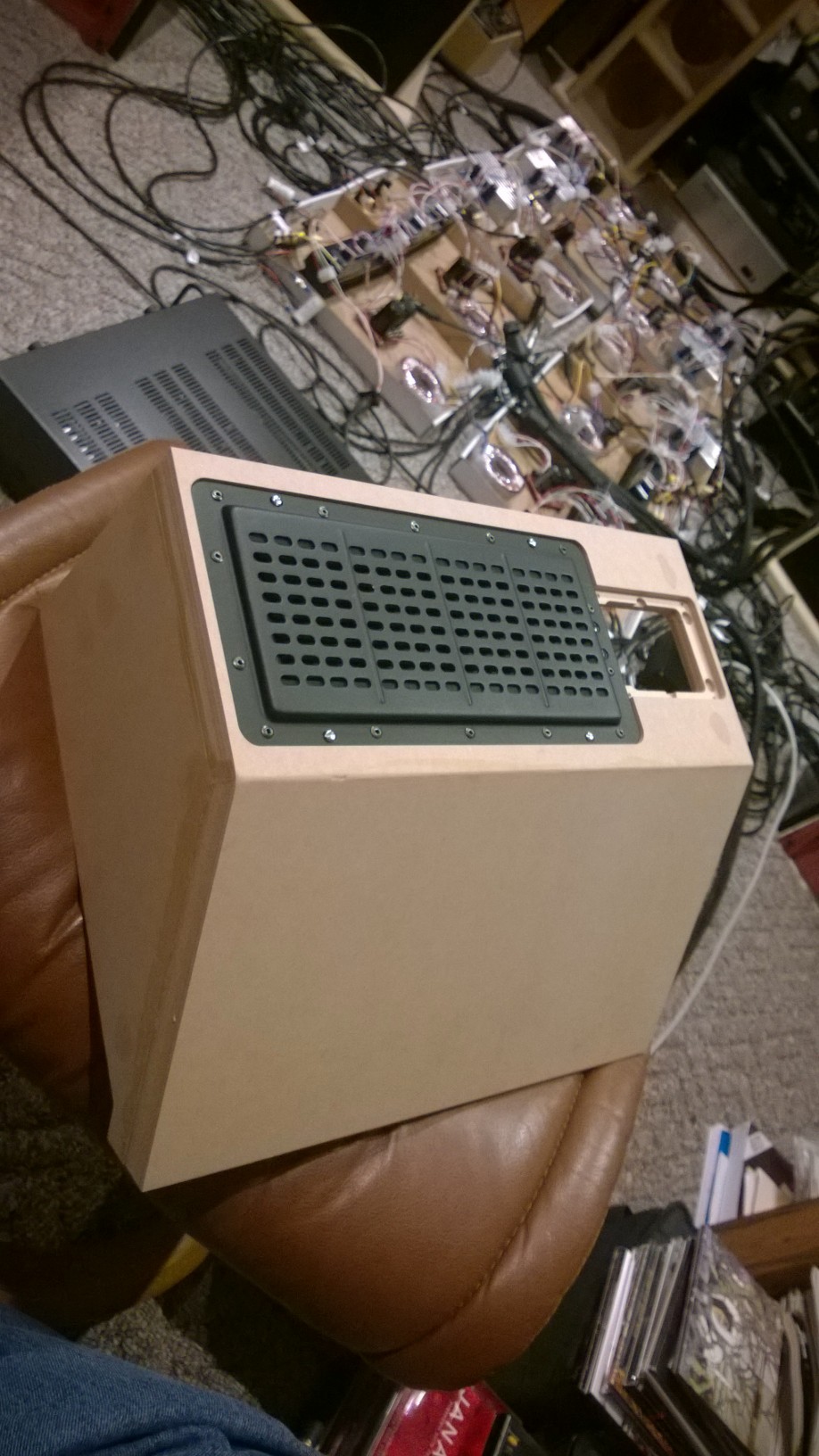

The Monolith test baffle with the new GR Neo3 and BG Neo10 installed. Next for some wiring and checkout.

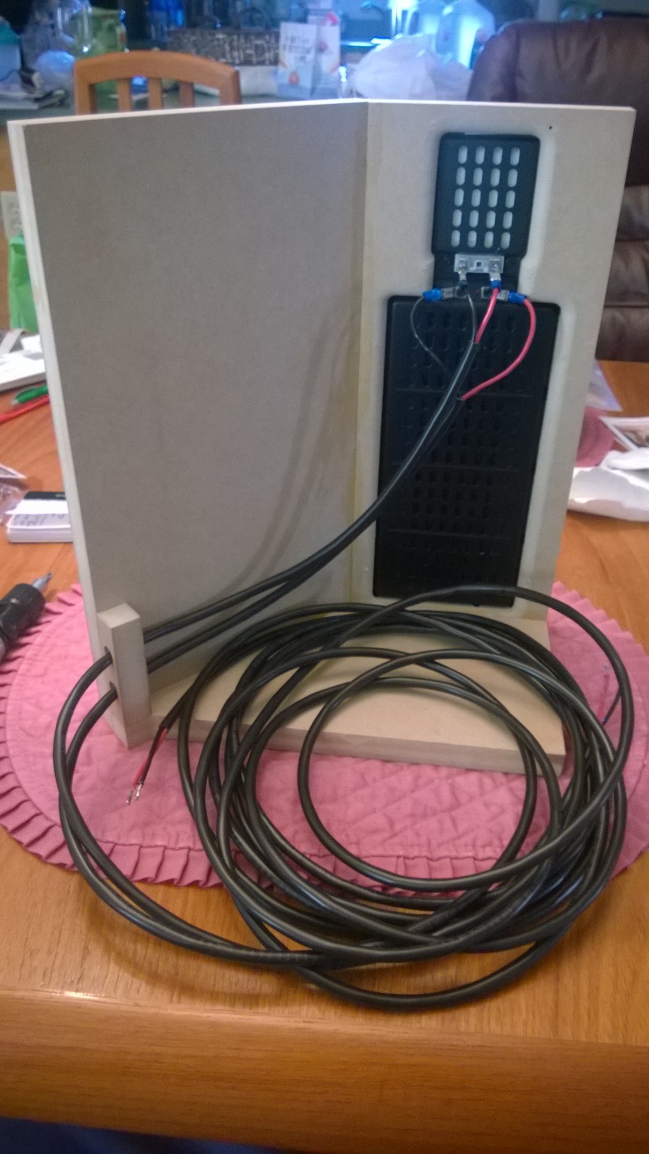

Posts: 943
The planar mid and tweeter are wired and ready for testing. The 14awg polyolefin insulated wiring has been very easy to work with for the drivers.
Now to connect up to the Parasound A23 and see if we let out any magic smoke. If not, measurements.
Next is wire up the two 3x8" servo sub arrays and HX300 amps.

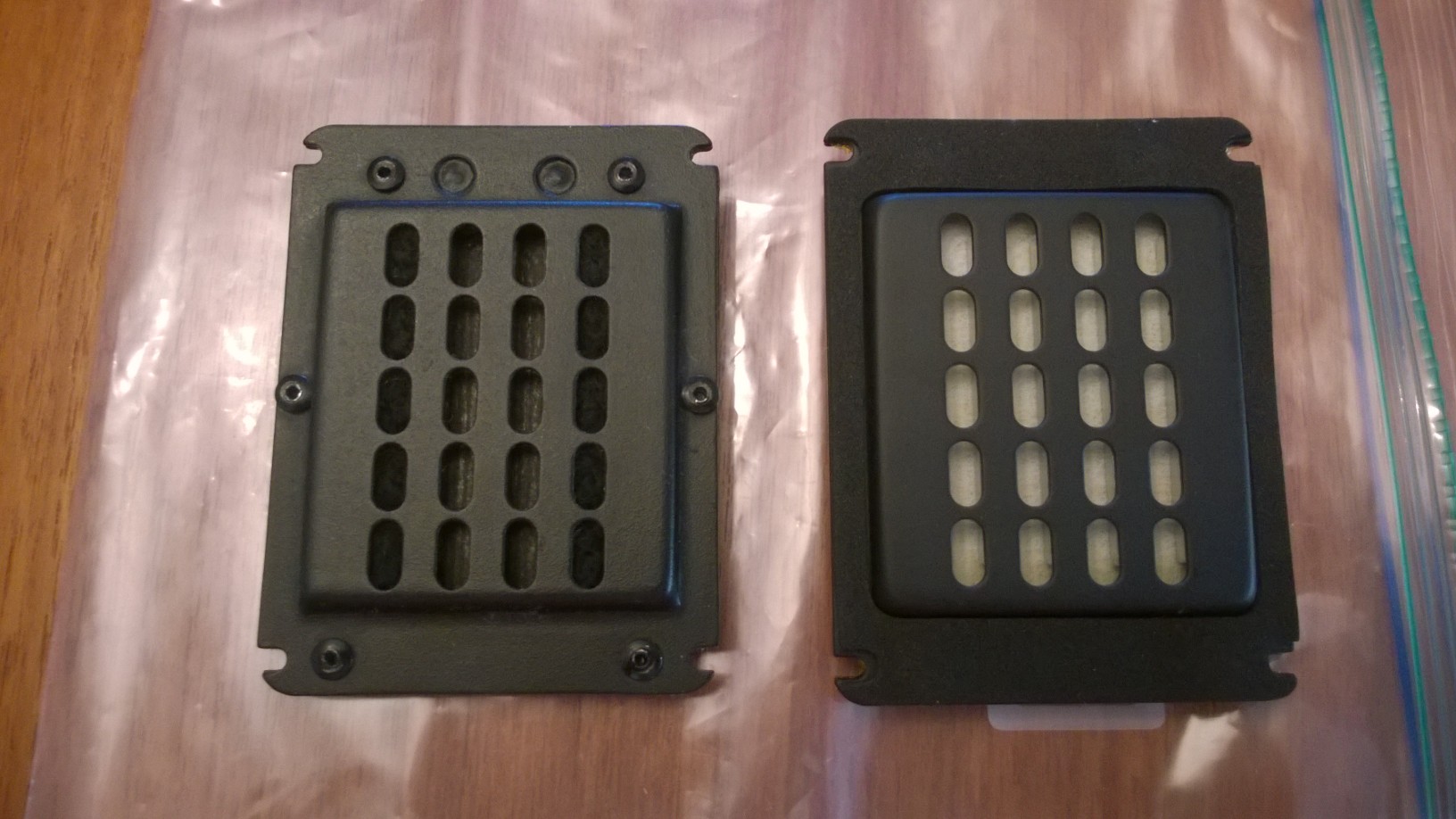

Did some measurements of both styles of BG planars in the open baffles. Nice day to be out for awhile.

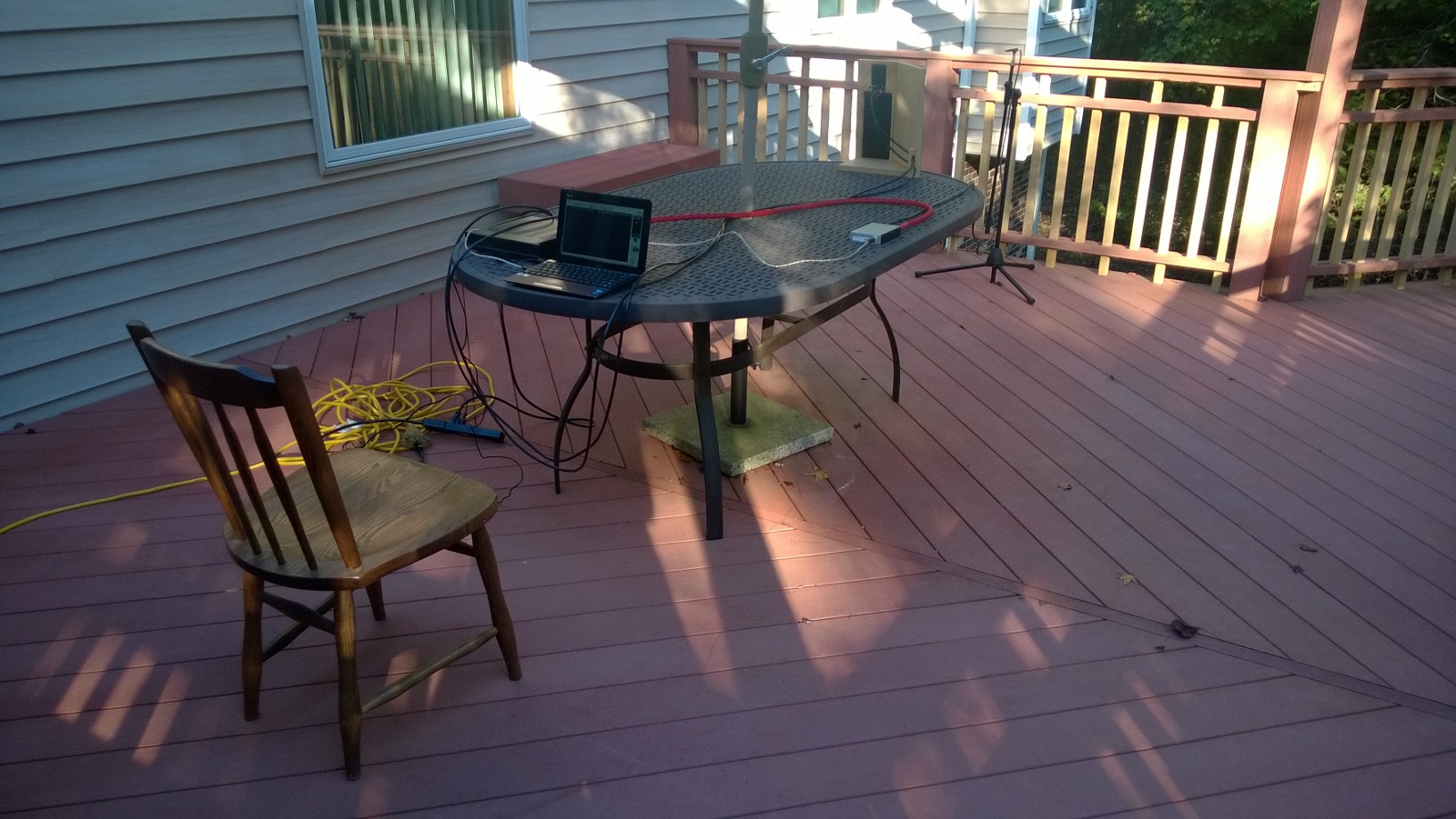

Posts: 943
The weather was good today, so did measurement tests outside with the moded GR Neo3 and new production BG Neo10 on my test baffle.
These were far field gated time measurements on tweeter center axis using Pocket CLIO and calibrated mic.
Now to build a digital crossover and see what happens.
