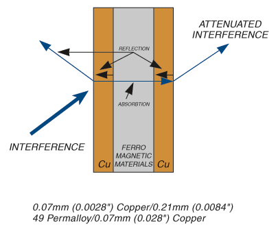

Attached is a diagram of the TI-Shield.
Any thoughts or input will be appreciated.

Mu-metal is what is typically used for transformer (magnetic) shielding, which is a 77% nickel alloy, roughly corresponding to the Ultraperm alloy you mention above. Mu-metal is more effective than permalloy (which was developed and marketed by Western Electric, BTW). It does not tolerate bending or forming without loss of magnetic shielding properties, so has to be re-annealled after mechanical forming. I do not know if Permalloy is subject to a change in it's properties if you form itm, but this is something you should be aware of before trying to use it for shielding. You can wrap a transformer in a rolled tube of mu-metal, taking care not to actually bend it, if you have sufficient shielding material extending beyond the transformer (about 1 diameter or so), it will be as effective as if it were completely enclosed. At least that is what I have been able to run across on shielding.

The Mu-metal and Ultraperm 80 both have the need to be re-annealled after bending or cutting. Supposedly the 49% permalloy does not. The change in magnetic permeability is only where the metal is bent or cut thou. The rest remains the same. So a sharp right angle bend would only loose some permeability at the crease but even there it would still retain some shielding ability. I am planning on cutting the Ultraperm into pieces and overlapping the edges creating a box inside of a box. The boxes will be alternating layers of Ultraperm and copper. Depending on if I can find a suitable steel box or not, I may use steel sheet also. I will do some tests this weekend to get an idea of what this stuff can do.
