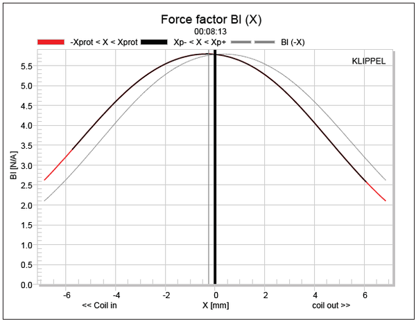

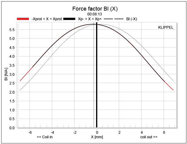

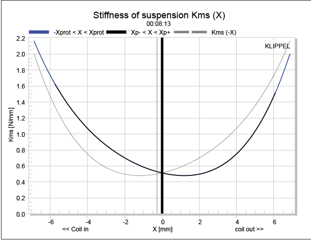

Dave:
That is only true if the motor strength at large excursions is symmetrical. I have seen many drivers that for several reasons have a BL curve that is not symmetrical around center. At some point no matter how much power the servo forces into the voice coil there is not enough motor strength to control the nonlinearities. That point will vary in the in and out directions if the BL is not symmetrical. What is worse, the non symmetry of the suspension compliance (Kms) often is worse in the same direction that the BL is weakest making the job of the servo even that much harder. I'm including two graphs of a good driver that illustrates the case where the BL decreases faster in the same direction that the suspension stiffens faster.

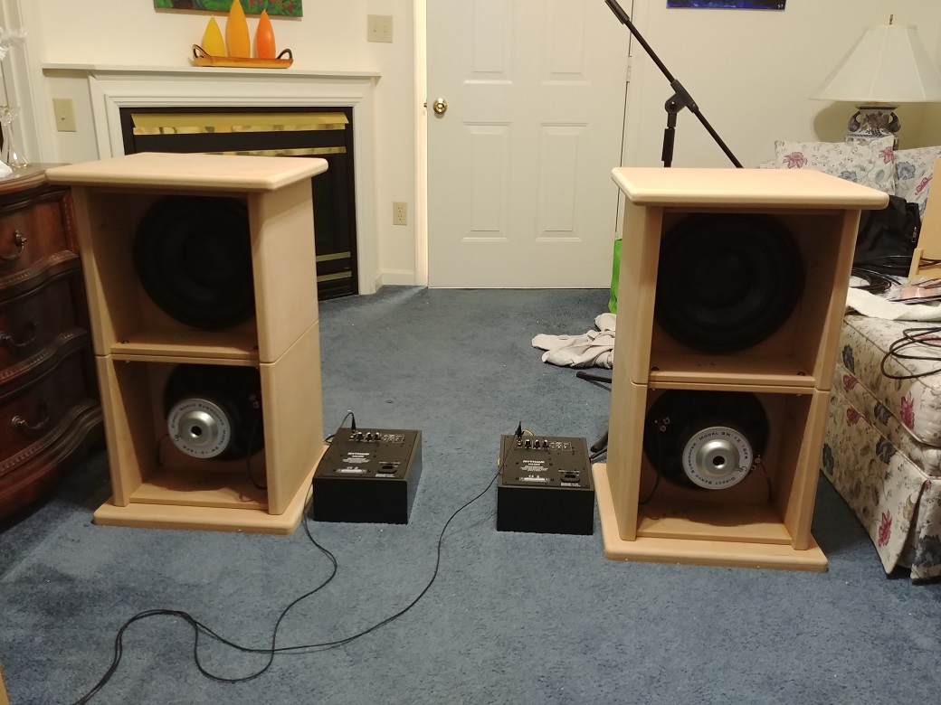

PostPosted: January 30th, 2018, 10:46 pm
Posts: 926
The Rythmik Audio HX300-12OB servo amps arrived today and now installed with the subs.
Tomorrow will be testing with the digital crossover and see what happens.
