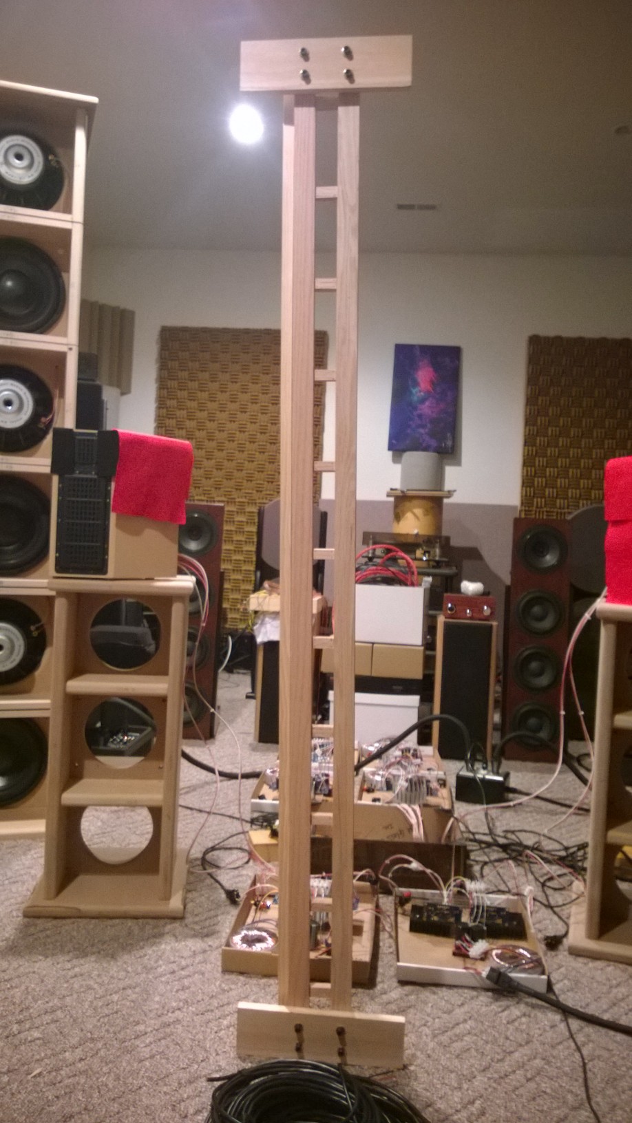

PostPosted: April 7th, 2016, 8:58 pm
Posts: 926
Right side open baffle ready for FPS planar install.
