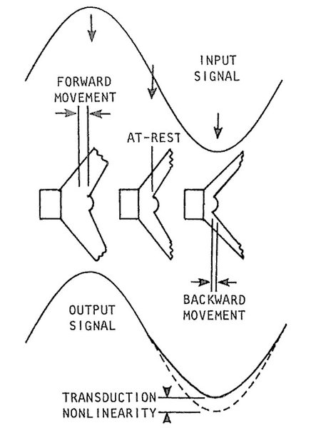

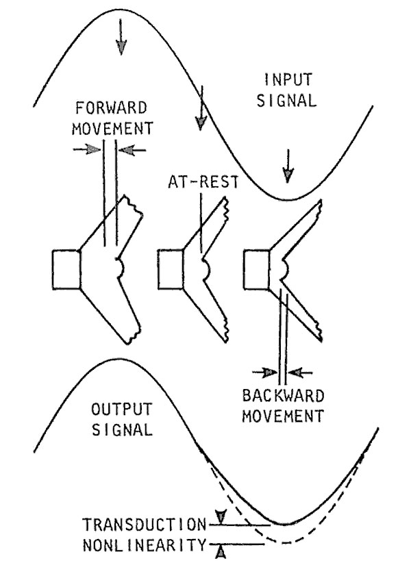

Shashi:
I don't think that is correct. As I said I am not an expert on the mechanism but you might want to look at this patent:
US 5537479 A
Here is what the author claims. I can't verify that myself. It might be an interesting test if I ever get time.
This push-pull configuration is a prior art concept in which the major even-order distortion harmonics (which contain the 2nd harmonic, usually the largest of all distortion harmonics) are greatly reduced because they are intentionally caused to be precisely out-of-phase as radiated, as between a normally mounted driver (or drivers) and an axially inverted mounted driver (or drivers)
