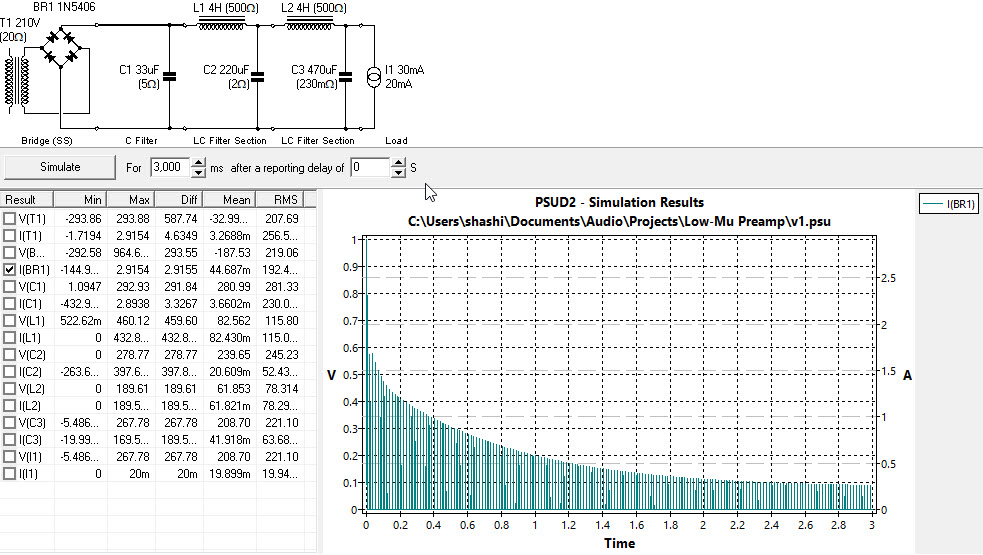

The large caps in the PS are generating huge inrush. Will be using an NTC inrush current limiter on the AC input before the transformer.

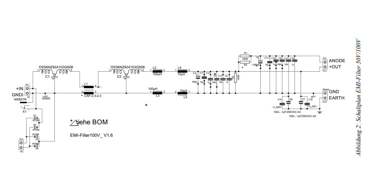

I am big believer in the need for a robust low-noise Power Supply is crucial for good audio. During my research for effective EMI filtration came across a German guy explaining the principles of EMI filtration and design. Its a lengthy video, 1:20hrs. He goes thru the basis. Believe it or not, he even teaches capacitor bypassing. Very worthwhile video if you have time.
https://www.youtube.com/watch?v=cSWUMly3nUE&t=176s
Here is the circuit he discusses in the video.
Fortunately, he is selling it as an assembled module. I am ordering the 400V 0.5A version to install it on B+ supply after CLCLC filter.

You need to pick your rectifier based in part on the inrush current. Is there a particular reason you are using 1N5406 diodes in a bridge? Personally I would use SiC Schottky diodes which are available in higher forward current. They also are free of switching noise, and are the best solid state diodes for audio. Don't let the default rectifiers in PSUD limit yourself. Look for the Cree and IXNS devices. Recommend 1000V capable and 6A forward current or more.
PostPosted: October 31st, 2021, 12:56 pm
Posts: 990
Shashi,
That is probably way overkill for a linestage. A low-level source like a phono preamp maybe, but you may be wasting your money. I would build it first with a well designed supply conventional supply, use rectifiers that won't generate switching hash, and see how it sounds.
PostPosted: October 31st, 2021, 1:26 pm
Posts: 1210
Shashi,
IN5406s are the closest thing to Schottkys I could find in PSUD2, so used them for modeling. Shall use Cree Schottkys in the build. I might also try the damper diodes 6AU4/6AY3 at some point.
