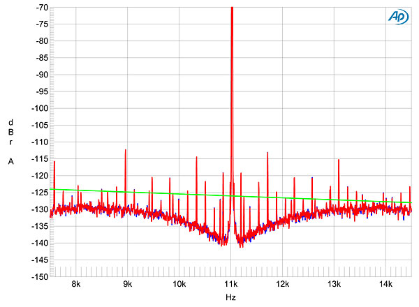

We are talking about background noise, aka noise floor.
John Atkinson says:
Quote:
Other than the peculiar behavior of its noise floor with high-level, high-frequency signals, the DEQX PreMate, considered as a D/A processor, offers superb measured performance. That it also has an enormously flexible DSP engine is a bonus!

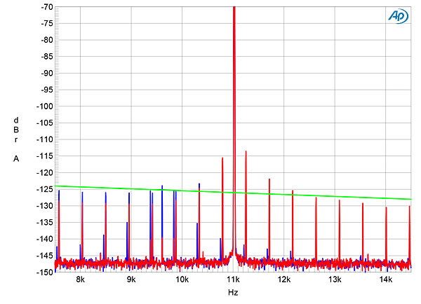

Also look at the stereophile's jitter comparison between DEQX Premate and Holo Spring below . Since we are literally comparing these two gizmos, jitter could have influenced my subjective impression.
DEQX:
https://www.stereophile.com/content/all ... urements-0
Spring:
https://www.stereophile.com/content/hol ... asurements
