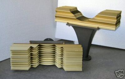

Example of JBL horn with lens -

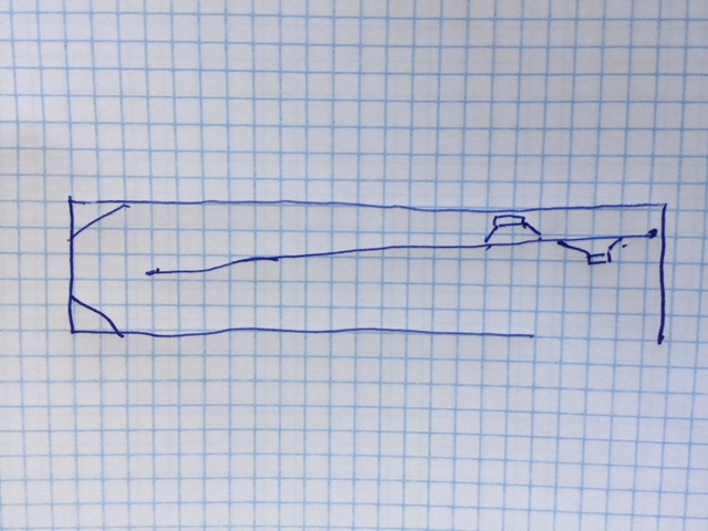

Danley's products are geared towards pro-audio and HT markets. His primary design goals seem to be compact size for portability and very high spl around 45Hz for the thundering bass effects. He uses large high excursion and stiff woofers, IOW a typical HT sub driver.

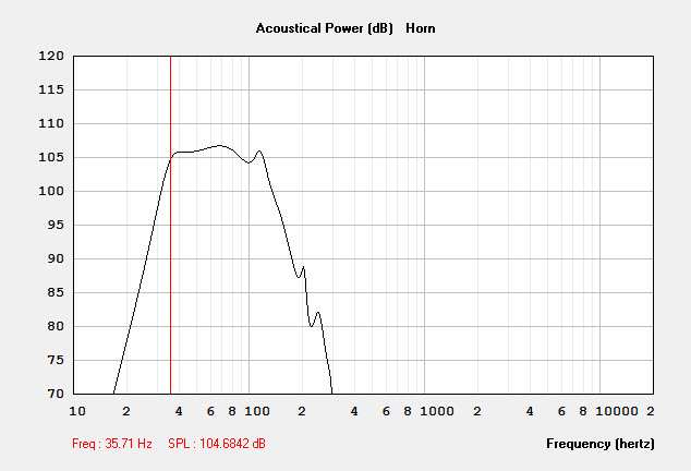

I am taking a different approach. Using two 8" high complaint and small excursion woofers (not subwoofers) in parallel push-pull configuration. My goal is to preserve the micro-dymanics in a low distortion and high efficient horn loaded sub. Hornresp modelling gives me flat 105dB from 35Hz to 100Hz.

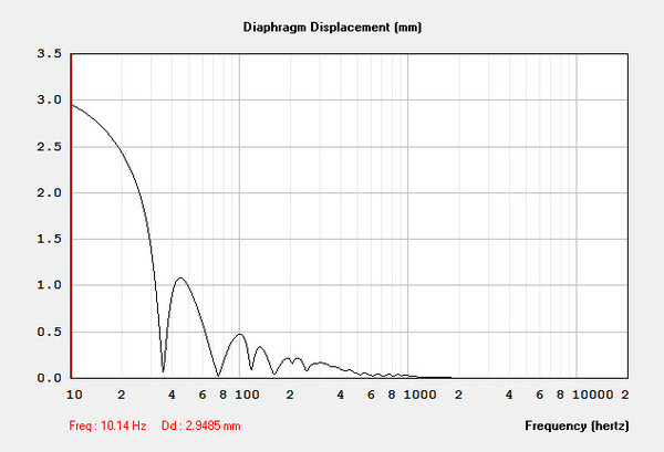

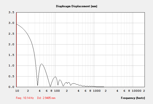

FR curve is shown with high-pass and low-pass filters applied.
If this is successful, I might build the 12" driver version which goes down to 25Hz flat.
