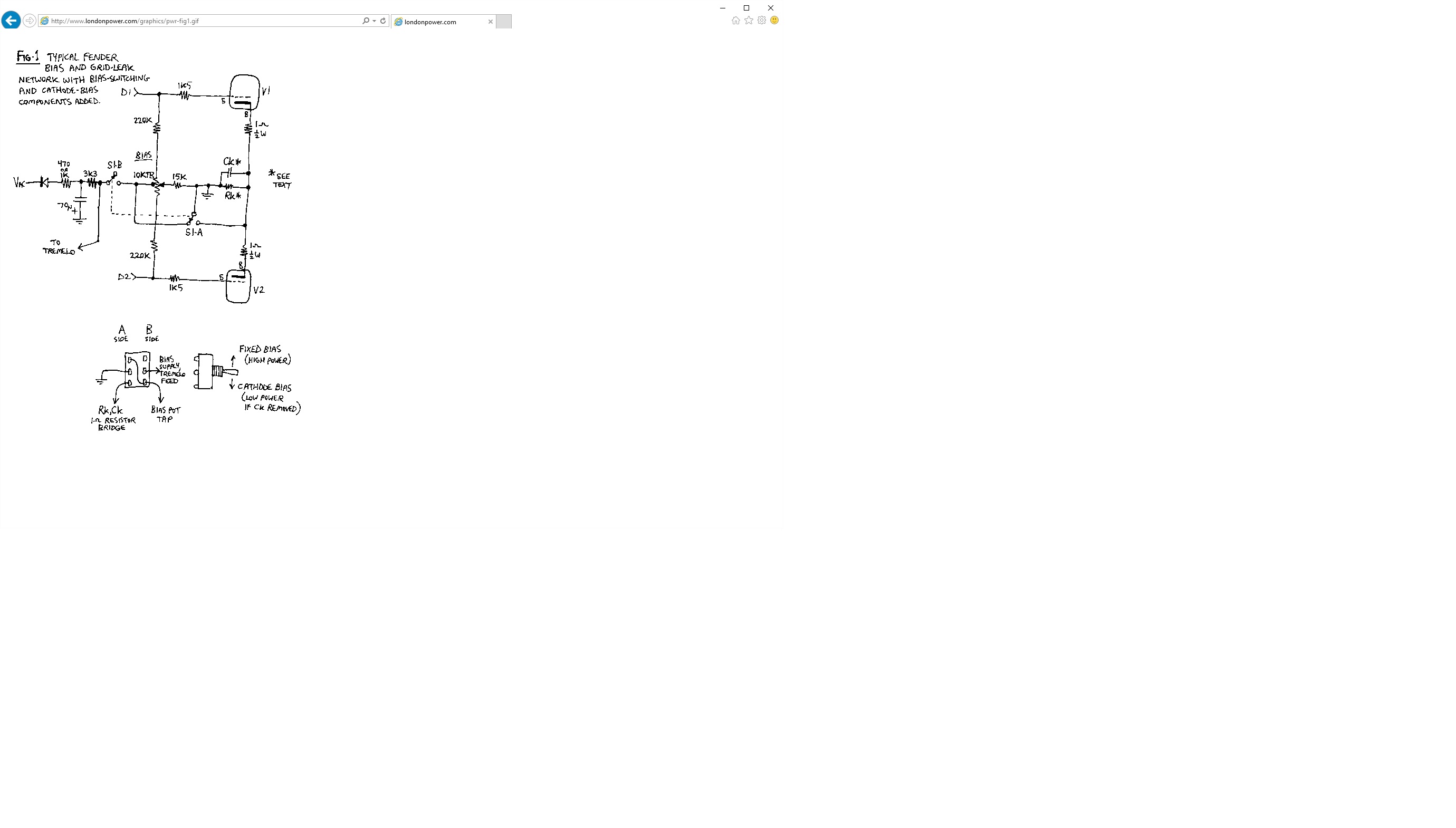

just to be insane here is a circuit to have both, it seems to used on Fendor Guitar amps

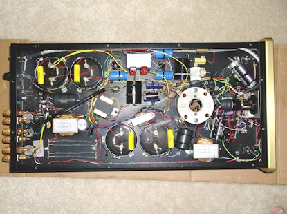

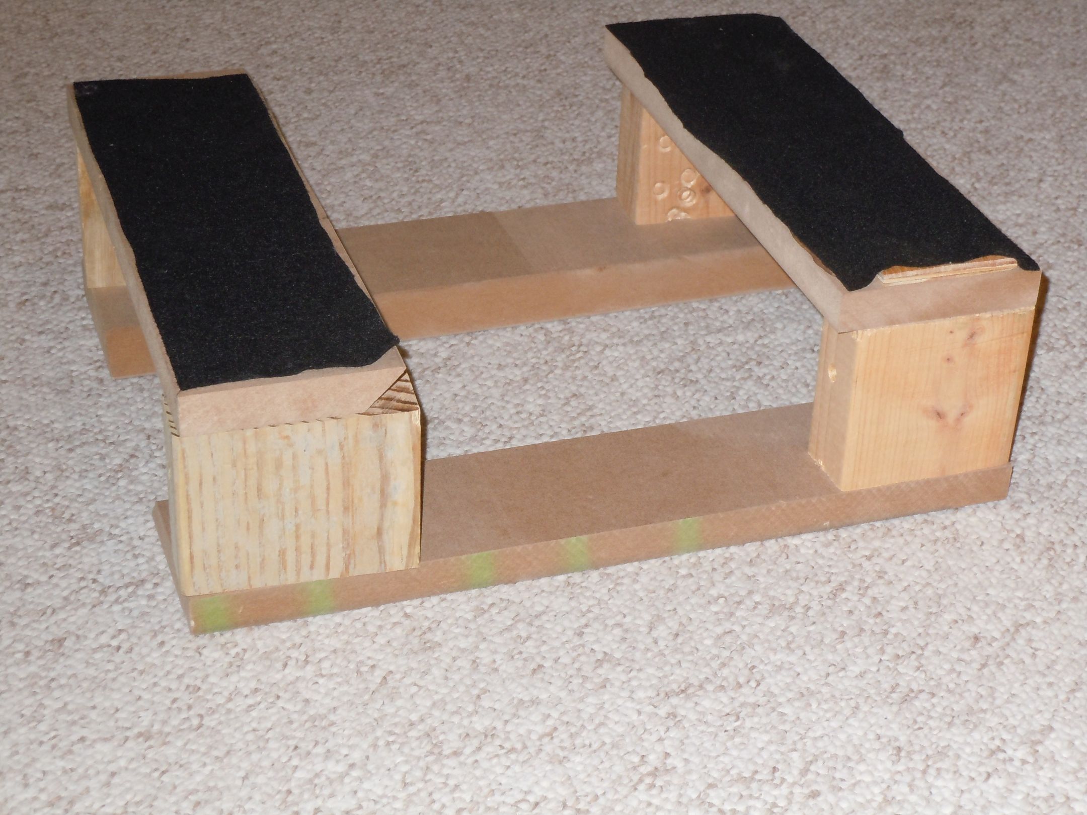

[color=#0000FF][/David you might want to make a jig out of scrap wood to hold the amp upside down. I did that for the Cherry Bomb amp that David and I built because I did not want all the weight of the transformer and chokes to bear down on the heat sinks when it was inverted. Here is a picture of that. It is make of junk wood with some felt hot glued on to prevent scratches.
Tomcolor]

David:
Sorry the photo did not come over the first time. I had to reduce the size.
