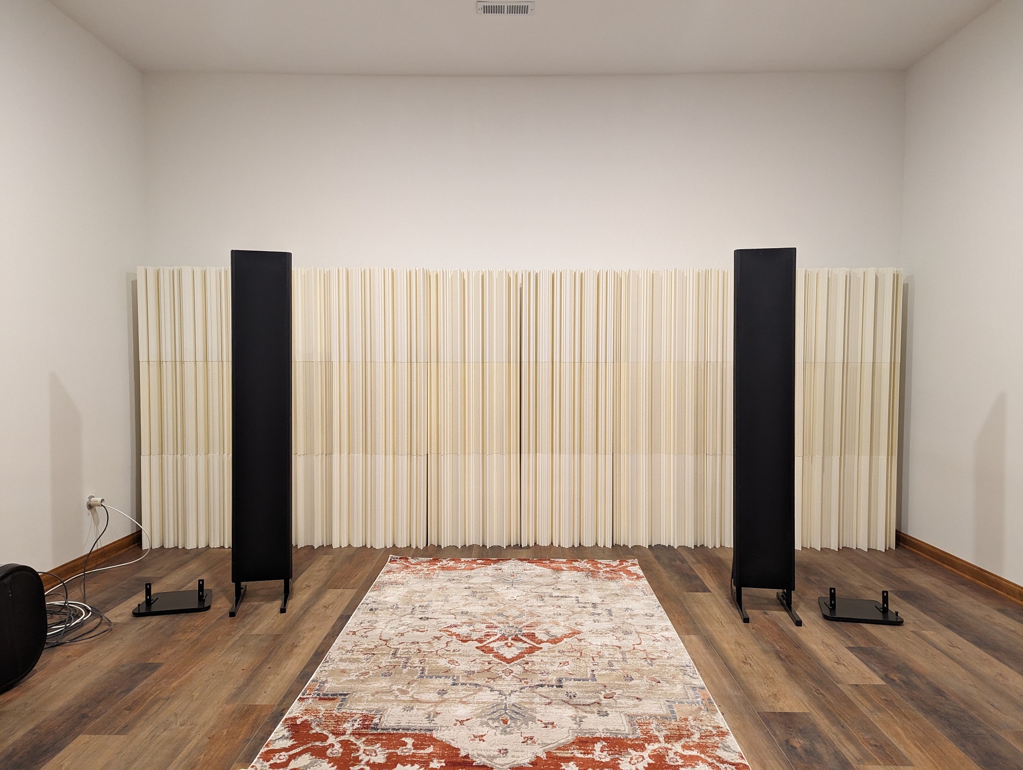

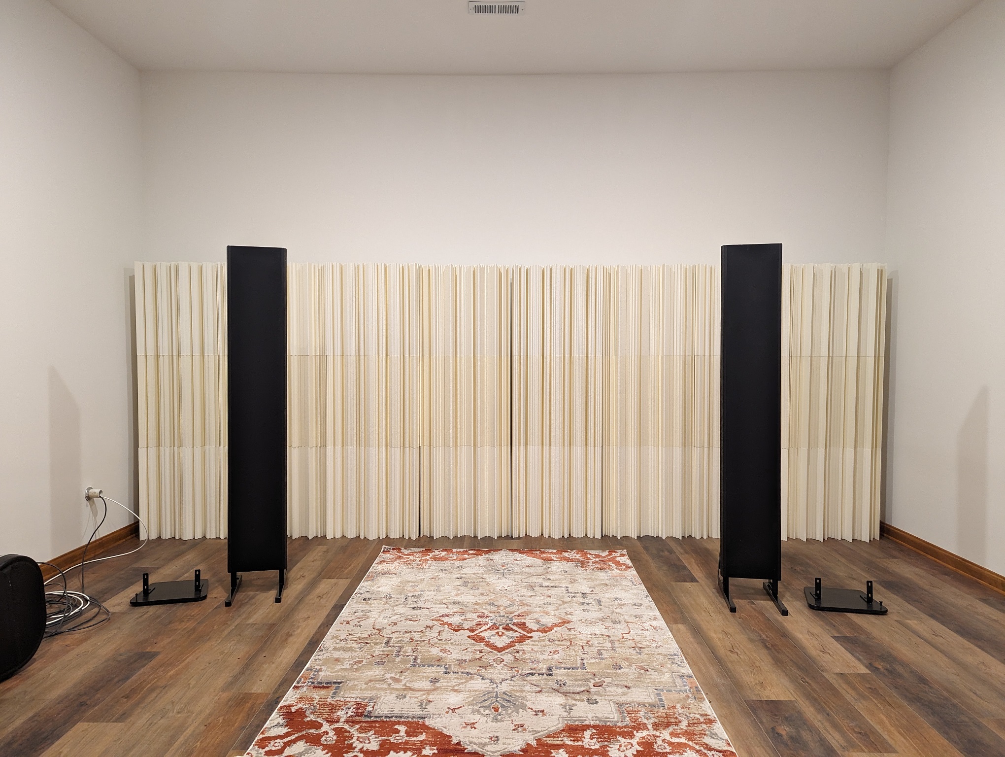

Have the first step of the room acoustics materials setup to check out. Side walls have some absorption and rear wall has more diffusion. Room needs more absorption, but a lot better than the reverb chamber it was.
Installed the Magna Risers on the Magnepan MG10/QR speakers. The screws on this pair were 1/4-20 x 1-1/4" style where normally they are 10-32's. Just had to remove some of the coating from the screw holes on the stands to fit the original screws.
Next is to wire them up to the Class D amps and start making some acoustic measurements.

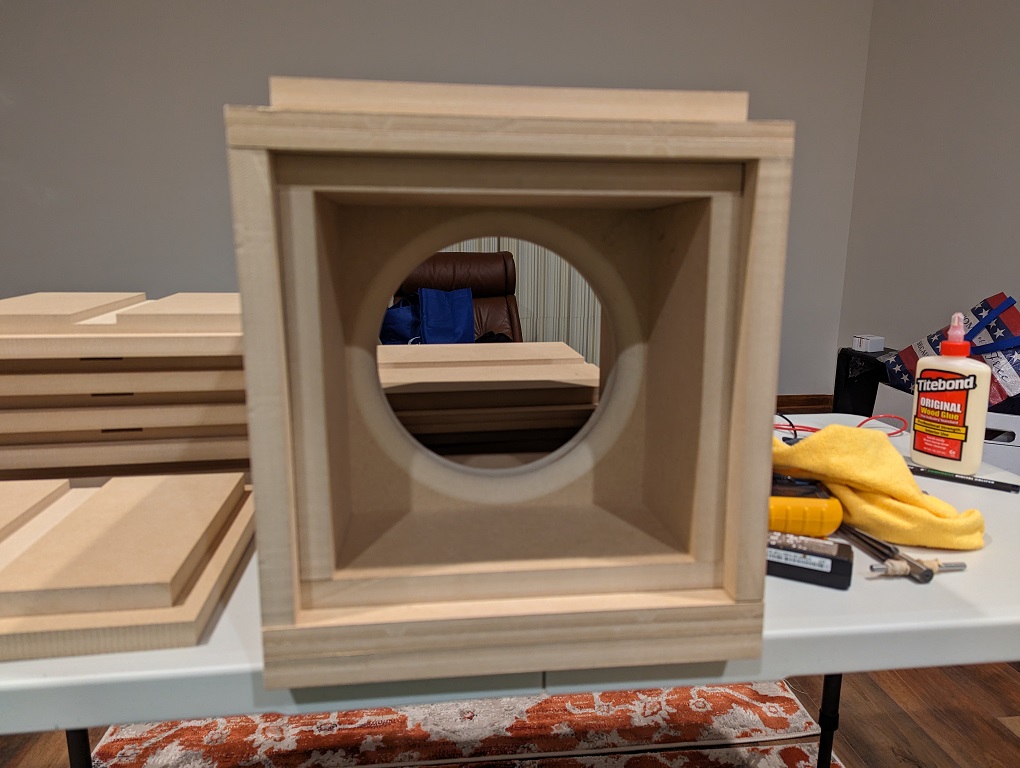

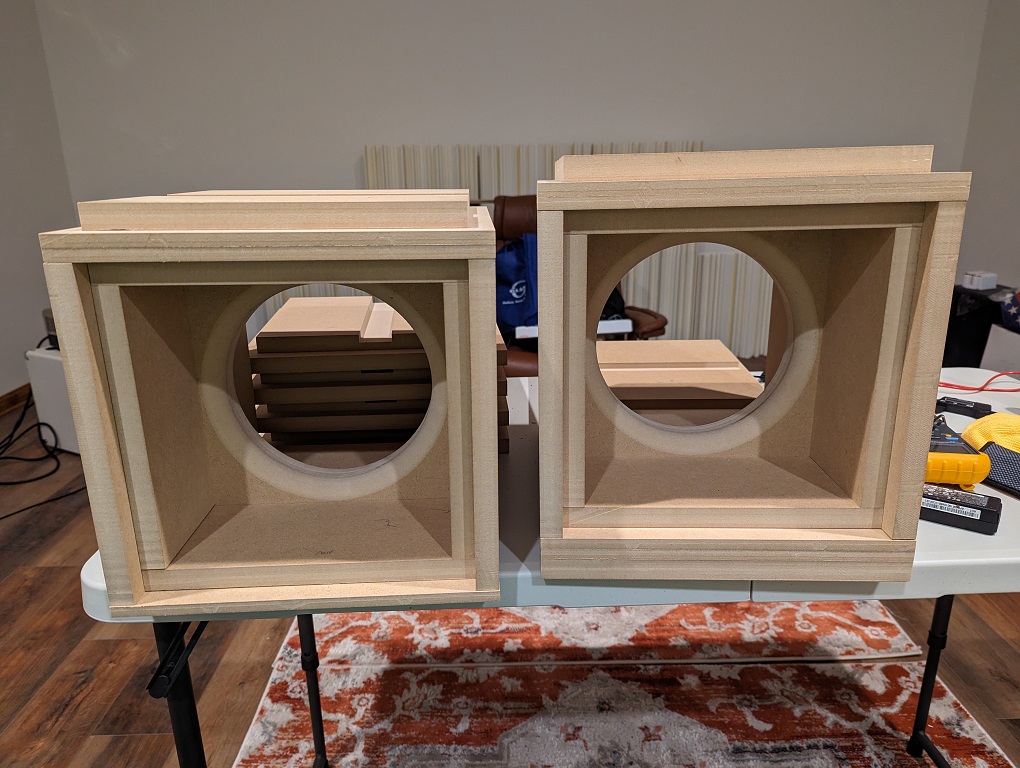

To go with the MG10/QR DSP Crossover project, worked with folks to develop a modular 8in Servo Sub OB H-Frame 4x8 stack. These are for the GR-Research 8in servo subs from the latest design. These will work below the 80Hz cutoff of the planars down to 30Hz.
These are the flat packs being test fitted before glue-up and then off to be painted.
