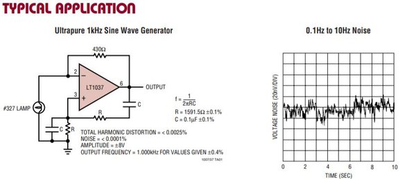

If you want to roll your own sine wave generator you can make a very low distortion sine wave generator using the LT1007 Op Amp. The schematic shown has values for 1KHz but the formula is there for any frequency. Note the distortion and noise. There are also circuits out there for crystal controlled oscillators.
