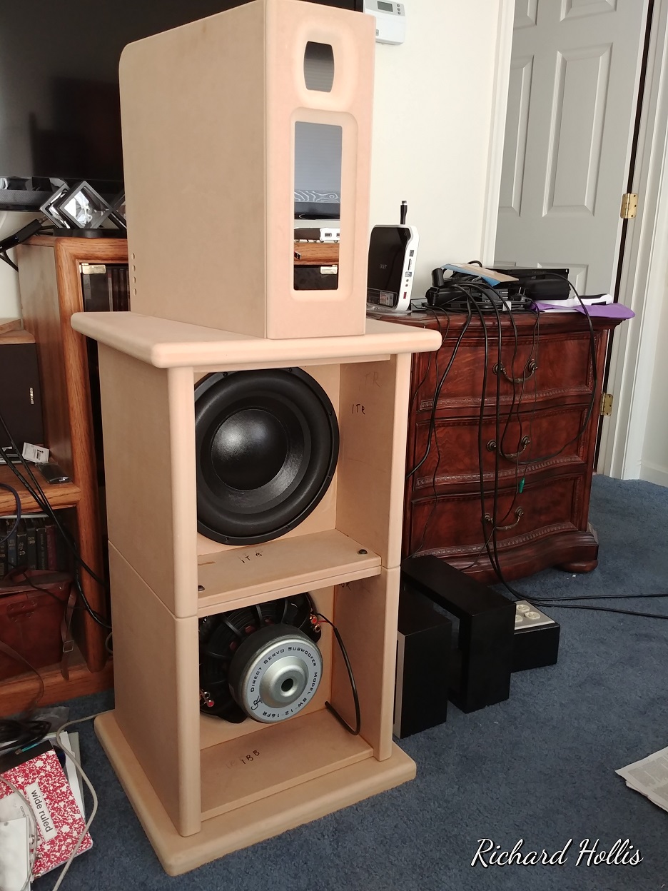

Got the new open baffle planar small version in and built the flat packs. Letting the glue dry on the second baffle and then install the planars tomorrow.
Then make measurements to tweak the original DSP crossover for the new planar baffle. Mod the time delay for the planar to sub offset distance and give them a listen.

Are you going to stain them?

Going to get painted. Got some ideas.

If the are mdf (looks like they are) you might want to consider dyed shellac. At the least use shellac to prime the mdf for painting. Shellac seals anything.
PostPosted: September 2nd, 2018, 9:35 am
Posts: 943
They are made of Medex, so close to MDF.
Have a local automotive paint place that will do the finish I am thinking of. I am terrible with finishing.

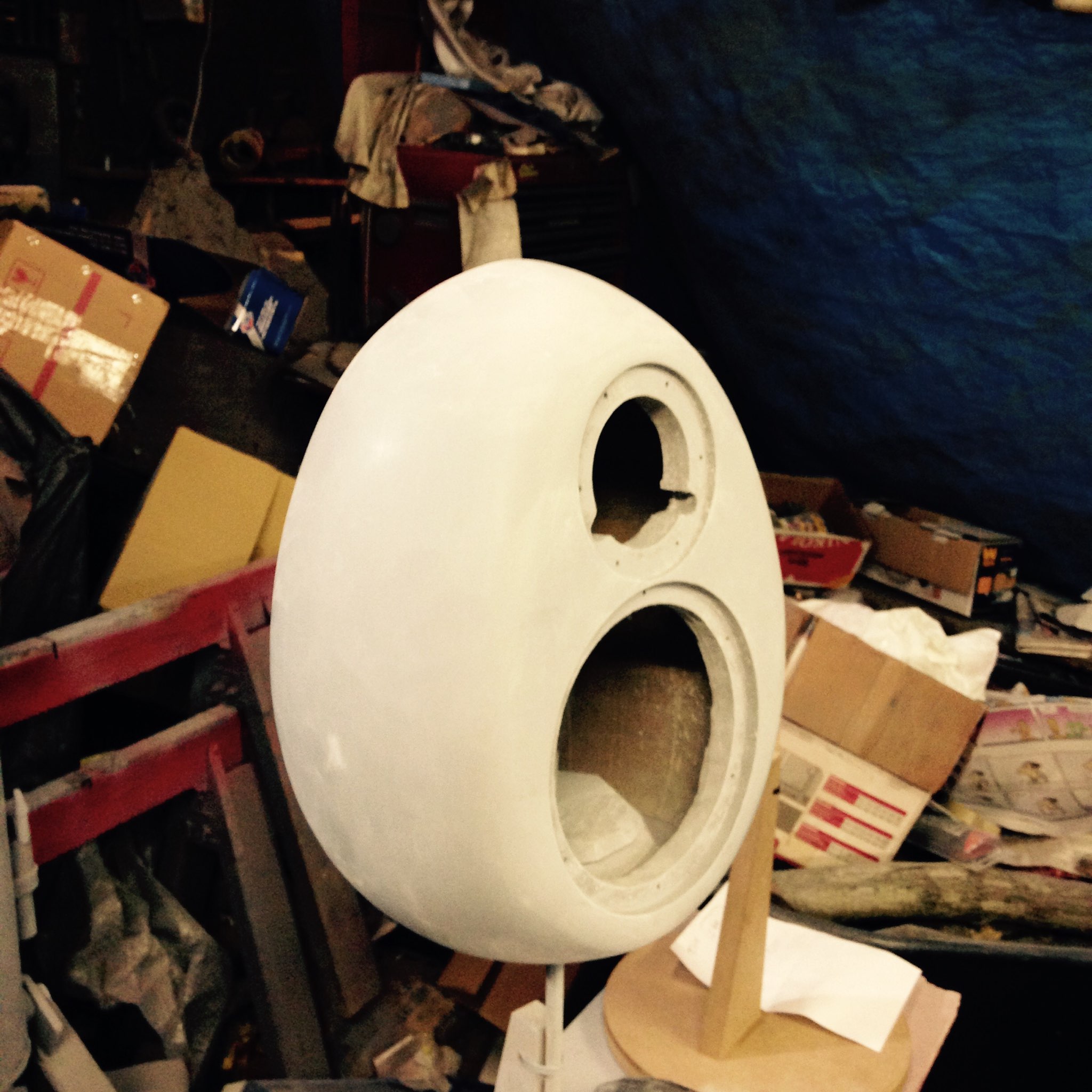

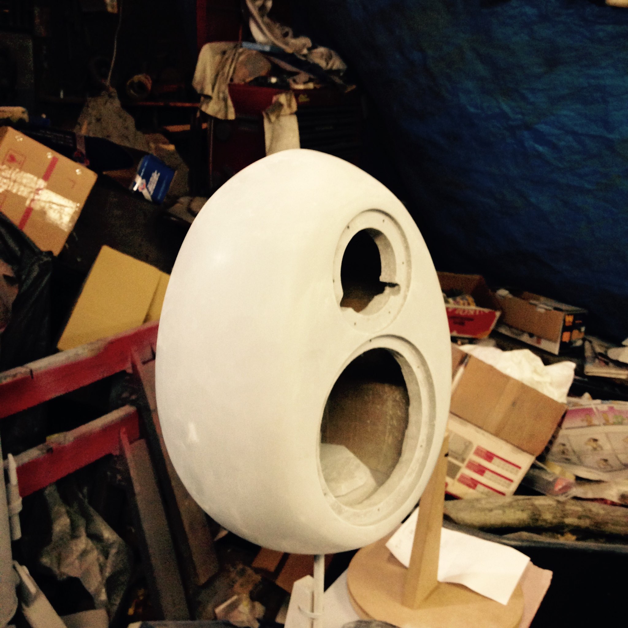

PostPosted: September 2nd, 2018, 12:48 pm
That is what I did with the eggs. The finish is a PPG black metallic that is the same finish as my wife's Buick Verano. If you go with a body shop you should advice them that Medex or MDF is not like working with metal. No matter how many times I sanded the eggs, the surface although very smooth is not flat. The glue joints do not sand at the same rate as the wood. My last sanding was with 800 grit and even though the surface felt like glass you could feel the ripples at the glue joints. The guy who painted mine used what is know in the trade as icing. Surprisingly, the surface was so smooth he had to rough it up for the icing to stick. He then applied it to the entire outer surface and re-sanded. Here is a photo of the egg with icing.
