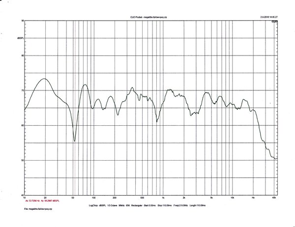

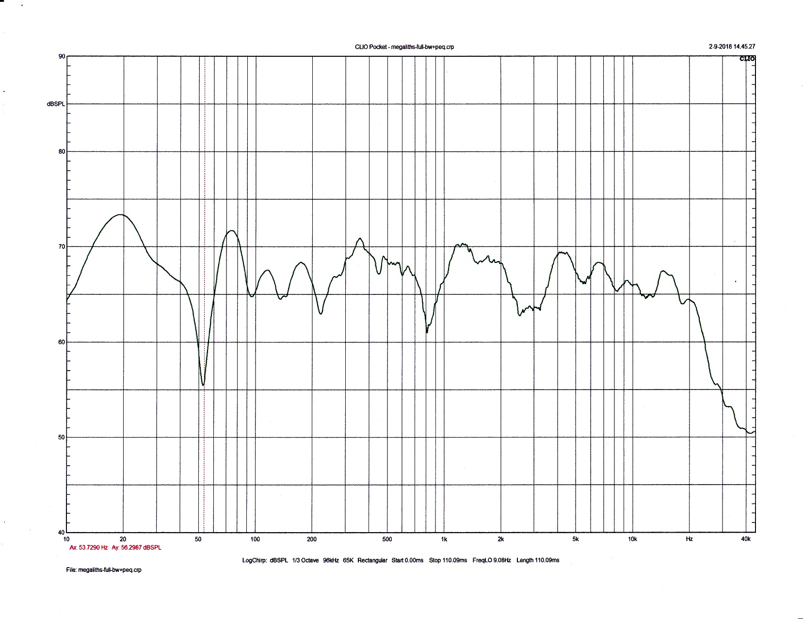

The is the Audiomatica Pocket CLIO frequency response of the left speaker at my listening location 8' from the array. Still have some room interaction to work on, but very nice compared to others in my room without any room correction system running at all.

That 10db suck out at 50hz will be hard to deal with. Never have seen that before. Usually there is a peak there. What are the room demensions? Where is the woofer in relation to the long demension?

The ceiling is 10' high and the 6x12" servo woofer array is 7.5' tall. The sub array is about 1/2 way the 25.2' length.
Probably need to build a bass absorption system for the ceiling across the 16' width, 1/2 way between the subs and seat and see what happens to the null measurement. I can EQ the peak down at ~22Hz.
