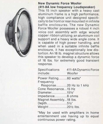

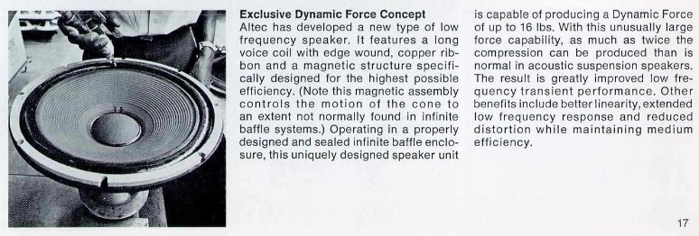

Altec makes the claim about 16lb dynamic force over and over again regarding my woofers, Altec 411-8A. I could not find any reference how it compares with other woofers or how to relates to T/s specs.
Anyone?
Quote:
Operating in a properly designed and sealed infinite baffle enclosure, this unique designed speaker unit is capable of producing a Dynamic Force of up to 16 lbs.
An 18 lb magnetic structure allows this speaker to develop a dynamic force of 16 lbs for extremely good transient response.
