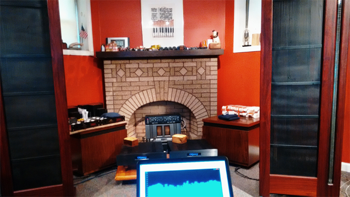

Maggies back in and Carvers shelved until OPA4227 chips come in to see if high pass musicality improves.
The maggies are more polite but much more musical.
laptop in foreground is RealRTA showing pink noise from 10 to 20khz
