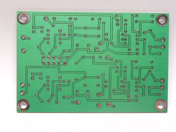

Jeff:

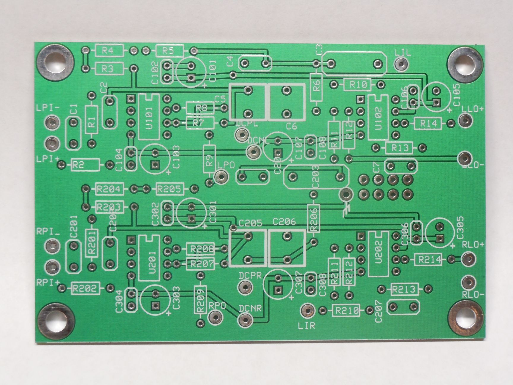

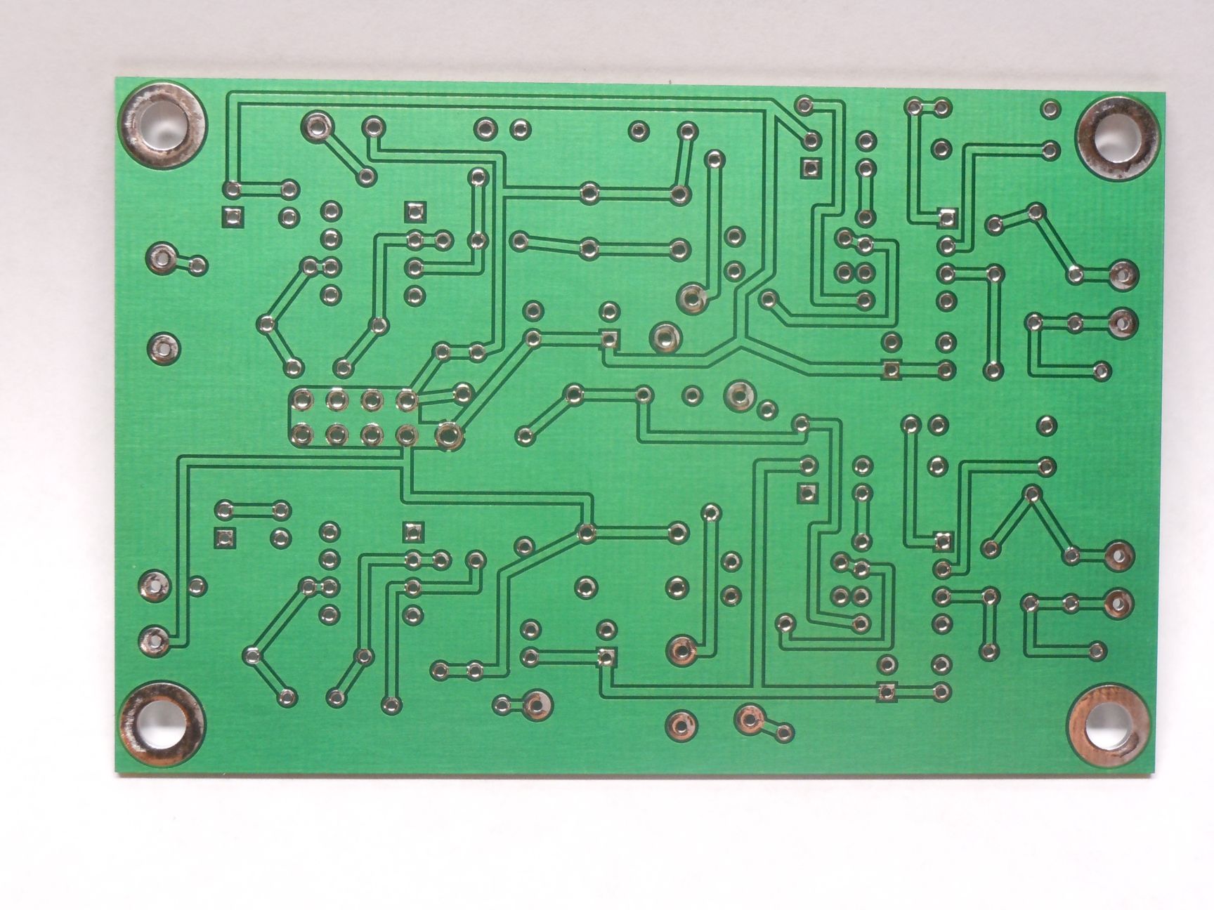

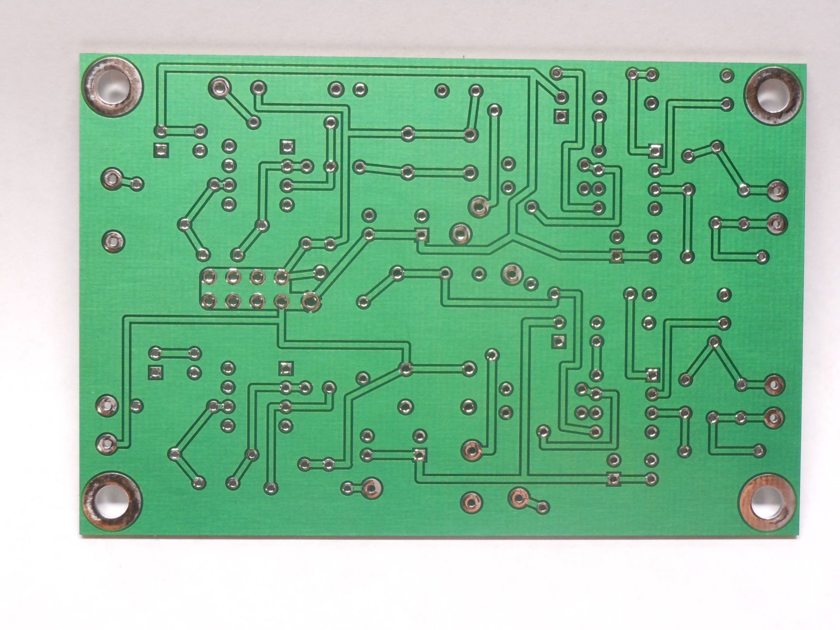

The boards came in the other day Here are photos of the top and bottom. I'm totally tied up until August but will build one for myself first and then we can set up a time to get together.

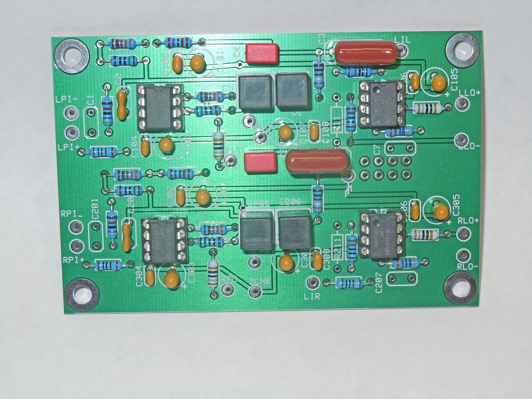

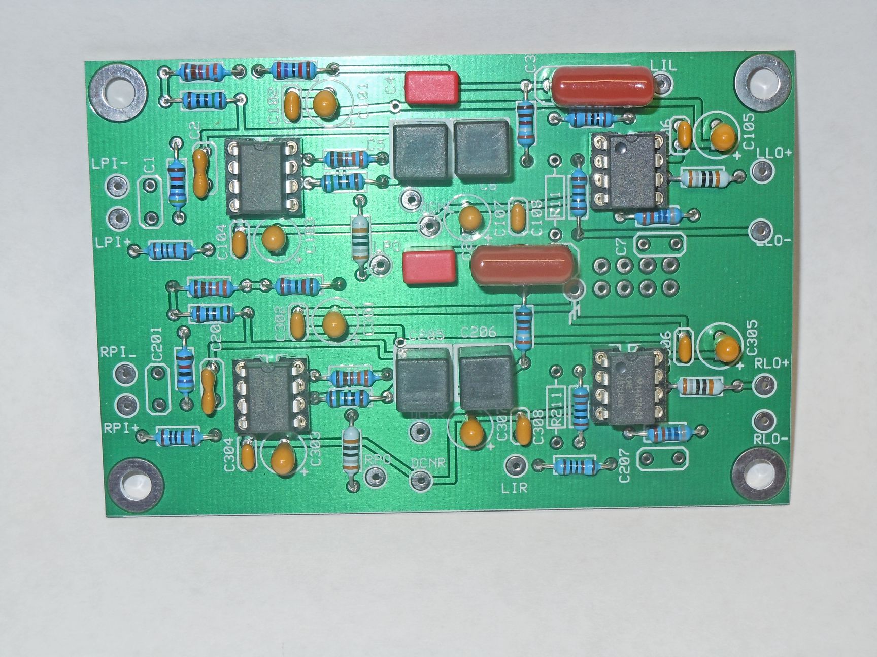

Here is the first board I assembled for myself. I just finished it and have not had time to test it yet. I won't get to test it until the first week of August. There are a few locations that are not populated. C1 and C201 are locations for whatever capacitance the cartridge needs for proper response. R11 and R211 are only used if the input is capacitively coupled. It will then provide a path for the input bias current of the line stage OP Amp to ground.

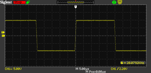

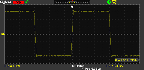

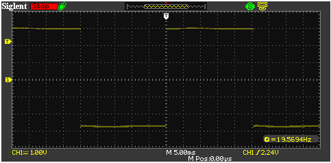

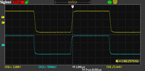

I had some time to test the board today. I'm enclosing a few scope traces that show square wave performance at 20 Hz, 20 KHz, and just for grins 100 KHz. There is also a screen that shows the input from my square generator on the bottom blue trace against the preamp output on the top trace at 100 KHz. When we get together I'll explain the significance of the measurements.

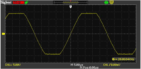

Another important parameter is how gracefully any circuit behaves if driven into clipping. There is an image of a 20 KHz sine wave driven into clipping. The level is over 14 volts peak which translates into roughly 10 volts RMS, about five times the level that will drive most amps into clipping so there is tons of headroom. The circuit comes out of clipping exceptionally cleanly with no ringing. I'll explain why that is very important.
I took it over to David Berning as he has a reverse RIAA circuit to test the accuracy of the RIAA adjustment. Even without component sorting, the accuracy from 20 HZ to above 1KHz was spot on and there was a slight drop at 20 KHz of about 1 dB. Being very slightly low helps prevent harshness especially if the cartridge does not track well. Selecting component values would allow it to be closer but I have never done that because the variance in recordings often exceeds that. The overload level was 140 mV which will suffice for any cartridge/recording level I know of.
PostPosted: August 3rd, 2016, 9:03 pm
Here are the other images.
